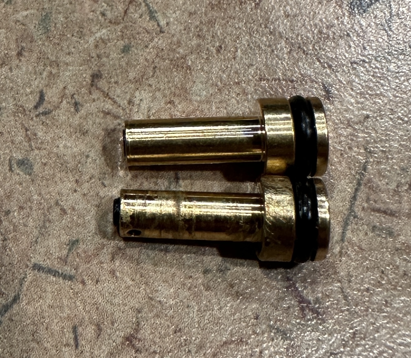

So FX was aware of the issue, talked to the tech again today. He said it's a bad batch of pistons that had too much delrin material. You can see the difference in the picture, it's pretty obvious.
Problem is they sent the wrong friggin o-rings, so I have another few days of paperweight. So far I'm just not impressed at all.
