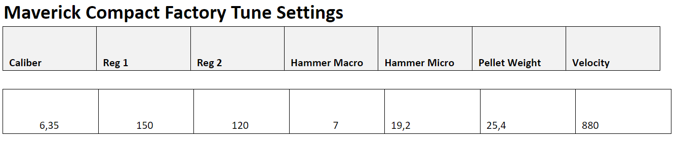

What does 19,2 mean? Is that turns out from full in? I know I need to "tune for the knee" but just wondering what that part of the chart means. I guess I could reverse engineer it and just aim for 880 with all other variables the same.

The 19.2 is `19.2 mm, or over all length of the Hammer Screw adjuster and the screw, IMPORTANT. If you are getting full tank pressure with the #1 screwed in, congratulations you get to rebuild the reg, the factory messed up...surprise...been there, done that. On the regs, see if they have the newer brass pistons, if not tell FX to send them. Spend some time polishing the mating surfaces, it seems to help.
