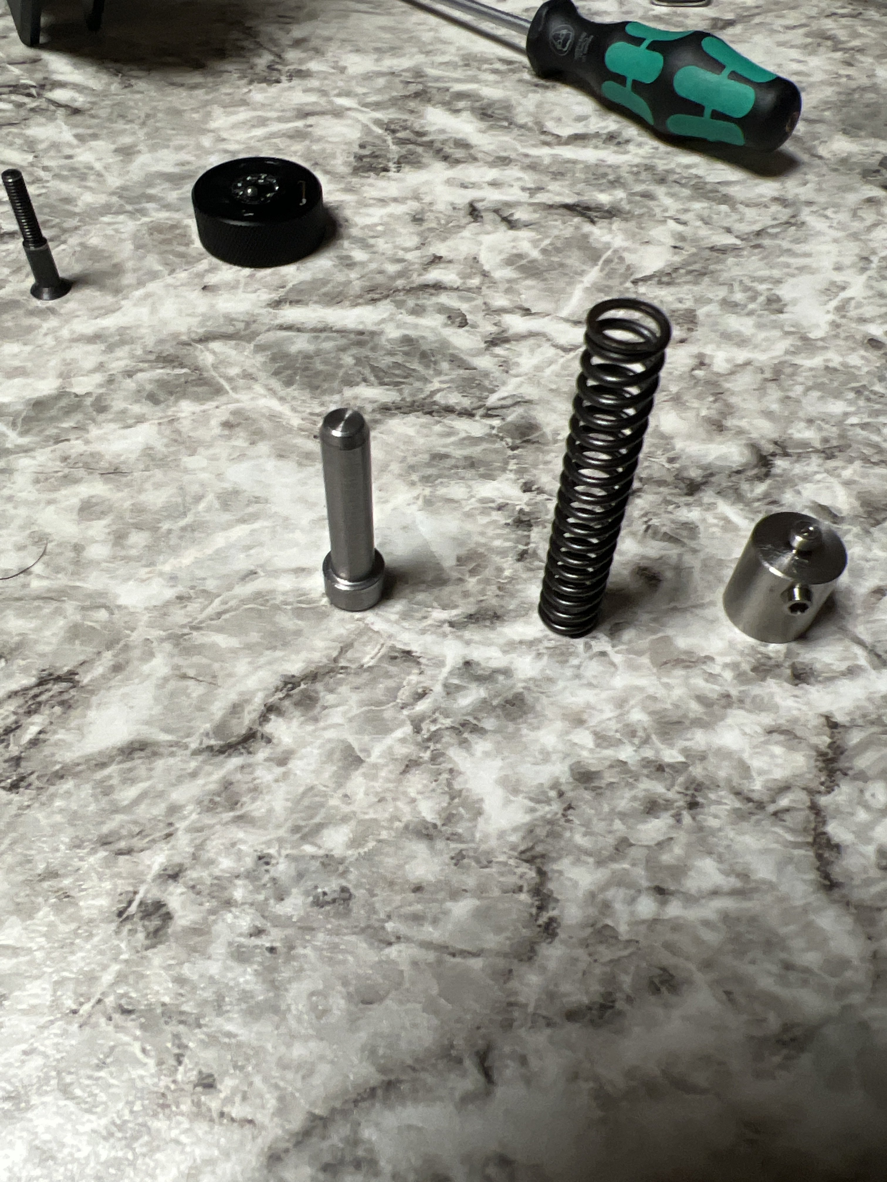

It's really easy to remove the hammer, spring, probe, etc. I would remove all of that and give a good cleaning. Probably just gunked up.
May take a can of air and blow out area where the hammer and spring are housed once removed as well.
Also, inspect the cocking rod for grit, gunk or anything else 'weird'.
I'm betting if you give it a good cleaning, your problem will go away.
Also, check the little set screw on the back of the hammer adjuster.
NOTE: Be mindful of the little 3mm ball bearing on the power wheel. Easy to lose. When replacing dab a little silicone grease on the bearing and it will hold in place for reassembly.
Several youtube videos on disassembly floating around. Recommend watching one of Ernest Rowes's before doing it the first time.
Feels like there is something inside binding up the hammer doesn’t happen every time but sometimes it’s gritty throughout the throw of the cocking lever. When this happens velocities jump about 40-50 fps. Any thoughts? Going to call FX and warranty this sucker if y’all can’t help me out lol
There's a small set screw that keeps your hammer assembly from turning , sounds like it backed out. Watch a video on removing your hammer spring if I remember correct it will be the first piece that comes out. Should be an easy fix , use some blue loctite and it shouldn't happen again.

thanks, so I have taken it apart blown/clean it multiple times and still nothing. The gun is essentially brand new (maybe 300 pellets through it). Started happening yesterday out of the blue.

That’s exactly what it seems like it’s the hammer part number 19039 that is the issue. It should spin freely and bounce up and down but it doesn’t.

That’s exactly what it was. The hammer had a large burr on it I had to file. I was so pissed I had to do it after 300 shots and had to take the whole trigger assembly apart that I forgot to take a picture to post for you guys! Cycling perfect now.

Sorry man, that's not the hammer, that's the hammer weight. You need to take the trigger assembly off in the three pins to get to the Hammer itself.

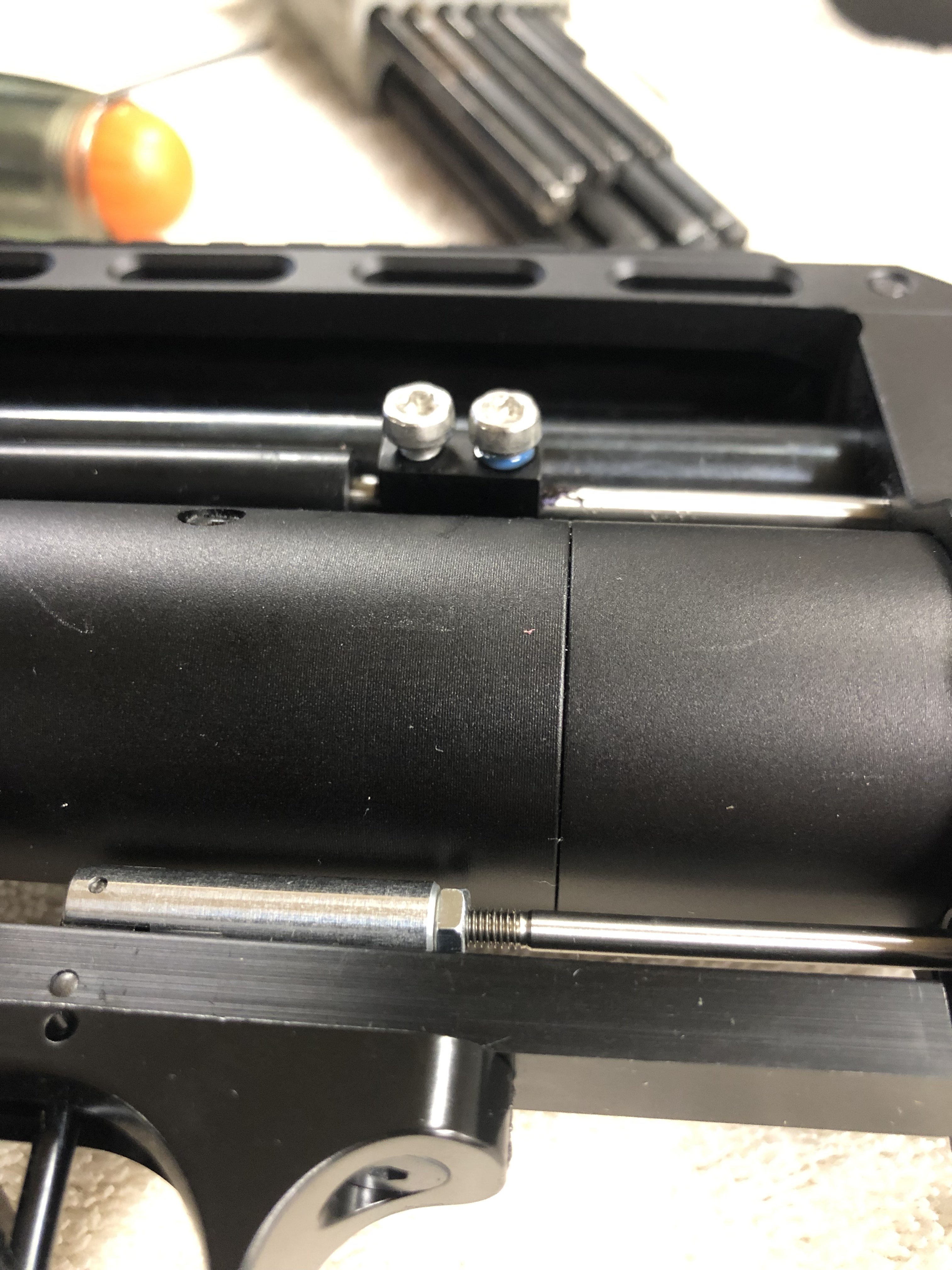

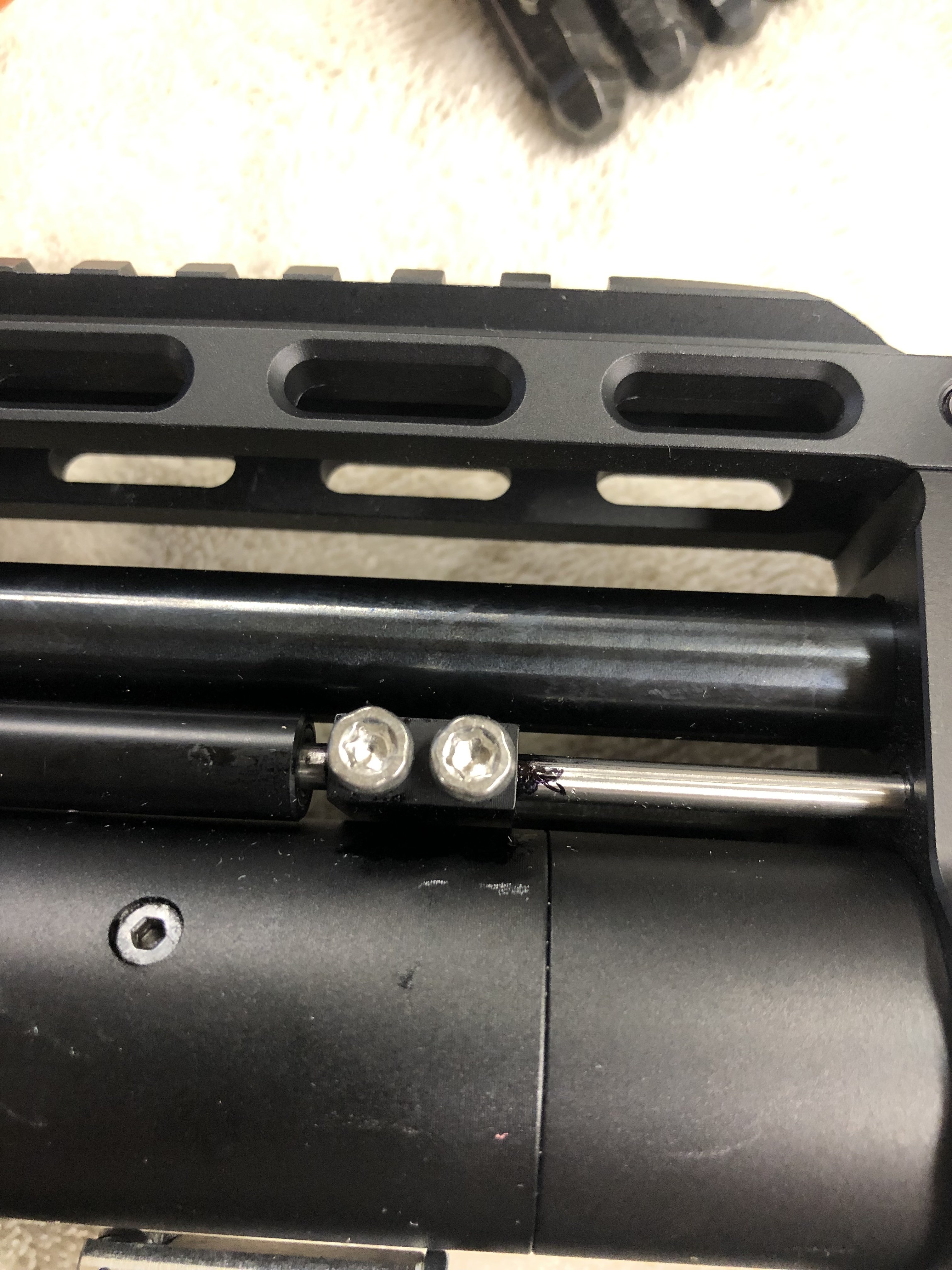

My shooting partner had a similar cocking issue with his. Check the video:
That video made me immediately order a pack of m4x4 grub screws off Amazon. I've had one go loose on my Wildcat MK3 BT, but luckily didn't lose it. Never hurts to be prepared. Pack of 50 for 8 bucks. Cheap insurance.
Reactions: A_Emiliano8
Get away from those crap grub screws! Use Torx M4 x 6 socket heads. You can torque down on those with no fear of stripping or rounding off anything. My own wildcats snd most everyone I’ve worked on get those grub screws replaced with Torx socket heads, and locktited in!
