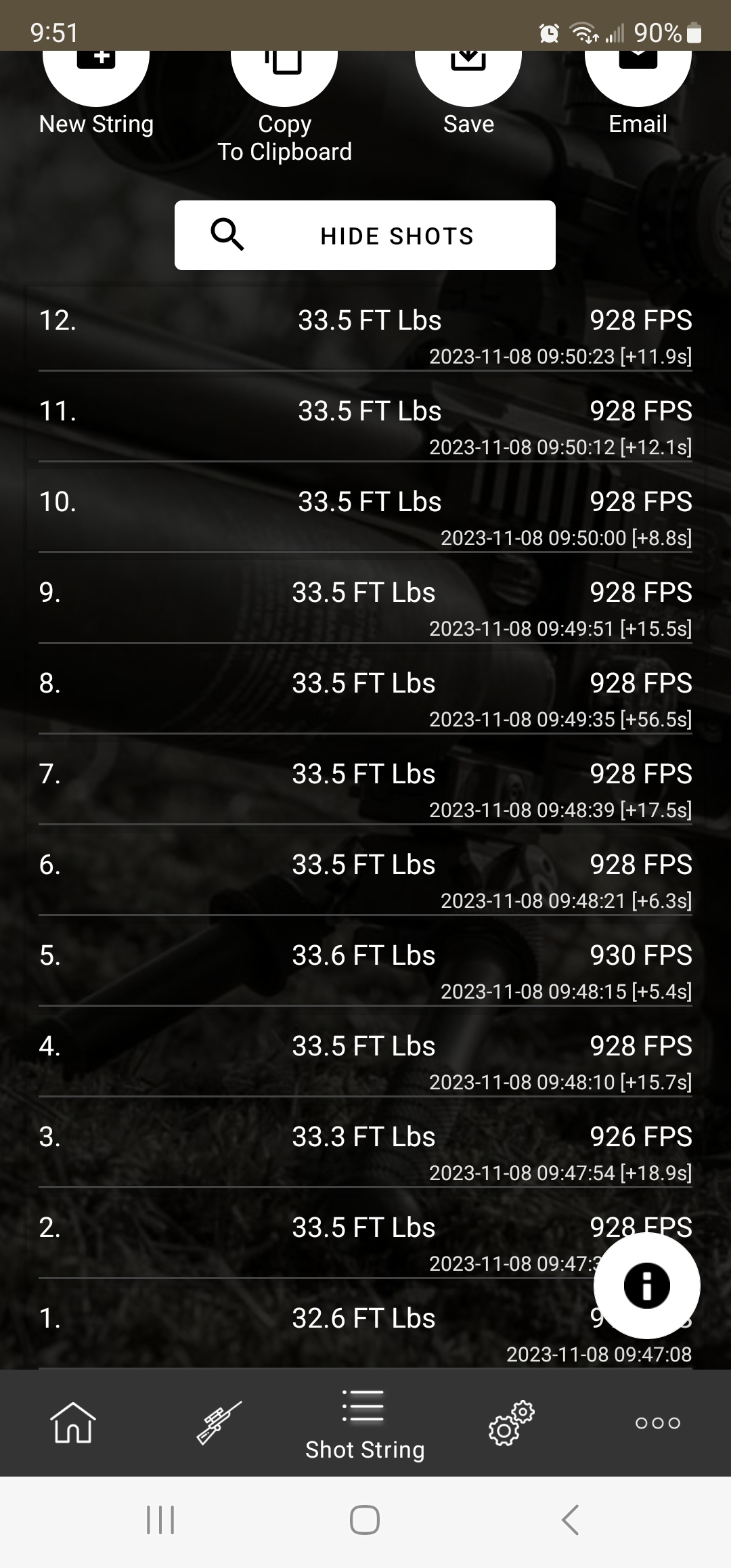

I loved my .25 Maverick, it was great, but i did not have it long due to unforseen circumstances. If you are looking for a 30yd or 50yd challenge gun, you should look into the dreamline series. Now it is long as hell, but damn I have not had a more accurate rifle. This shot string shows a little consistency. Lol, the first shot is immediately after adjusting the reg for the NSA 17.5g slugs. It does the same with jsb 18.1s as well.
