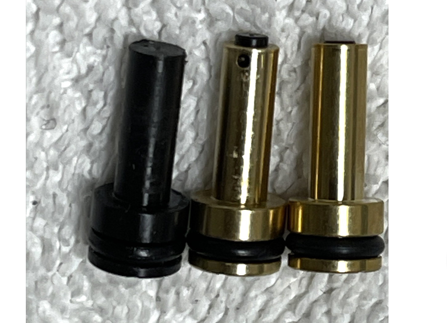

Time to tear your #2 apart, You don't say how old your Mav. is but if it has the older adjusters in them that is most likely your problem. The one on the right are the new improved ones. The one on the left is the original, the middle one is a mistake they made, if you get a long one you can carefully sand it down with FINE paper and polish. Constant high pressure use makes them convex.
I buy december 2023
The problem with the longer ones is you can't adjust past 100 bar without going beyond flush with the reg body . He would have never got to that pressure without the adjustment screws launching.
