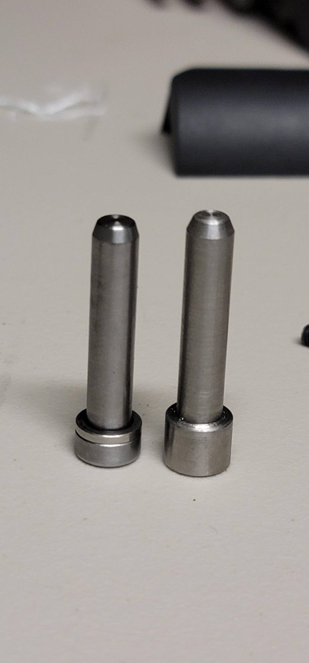

I bought this slug power kit, and I used the heavier hammer out of it. Here is a photo of the stock hammer and the heavier hammer in the slug power kit. This was in my Maverick VP .30 cal, and I did tweak the adjustment spring a bit.
I was able to set my regs at 155/125 and that gave me 930 fps with FX Hybrid Slugs, Hades and Exact 44.75 gr, and I get 880 fps with NSA 54.5 gr slugs. I have very flat velocity with these settings for about 32 shots with the 400cc VP bottle.
