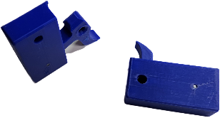

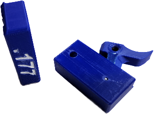

More than a year ago and use it without problems. Works in the M3. I asked for and have been waiting for a .177 version, not going to happen. I finally got around to modifying the original. It works as well as the original. Installation of the o-ring is not as refined as the original but works and anyway once and done for a long time.
I don't have any .25 or .30 pellets or breach o-rings so I'm not looking to make other sizes.
Attached is the .stl files for my version. I have 1 test print of the .177 if you want it be the first to ask. The pellet holder may not fit as snug as it could but a wrap of tape or a drop of CA will fit that.
You need a breach O-ring and a 2x14mm rod, stop by your local bike shop and ask for an old 2mm spoke and cut it.
View attachment 177_loader.zip
