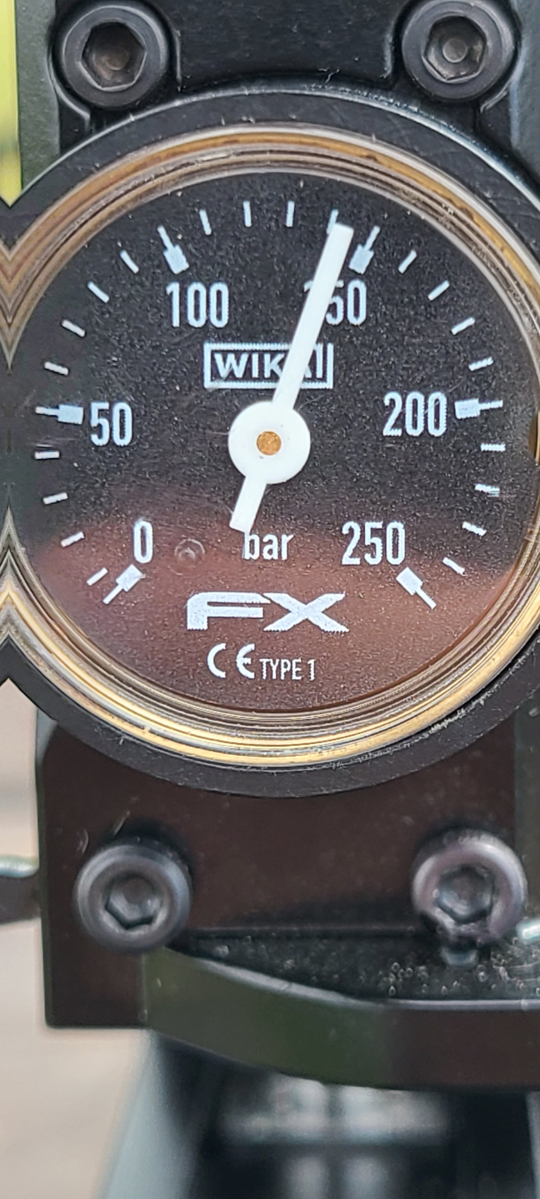

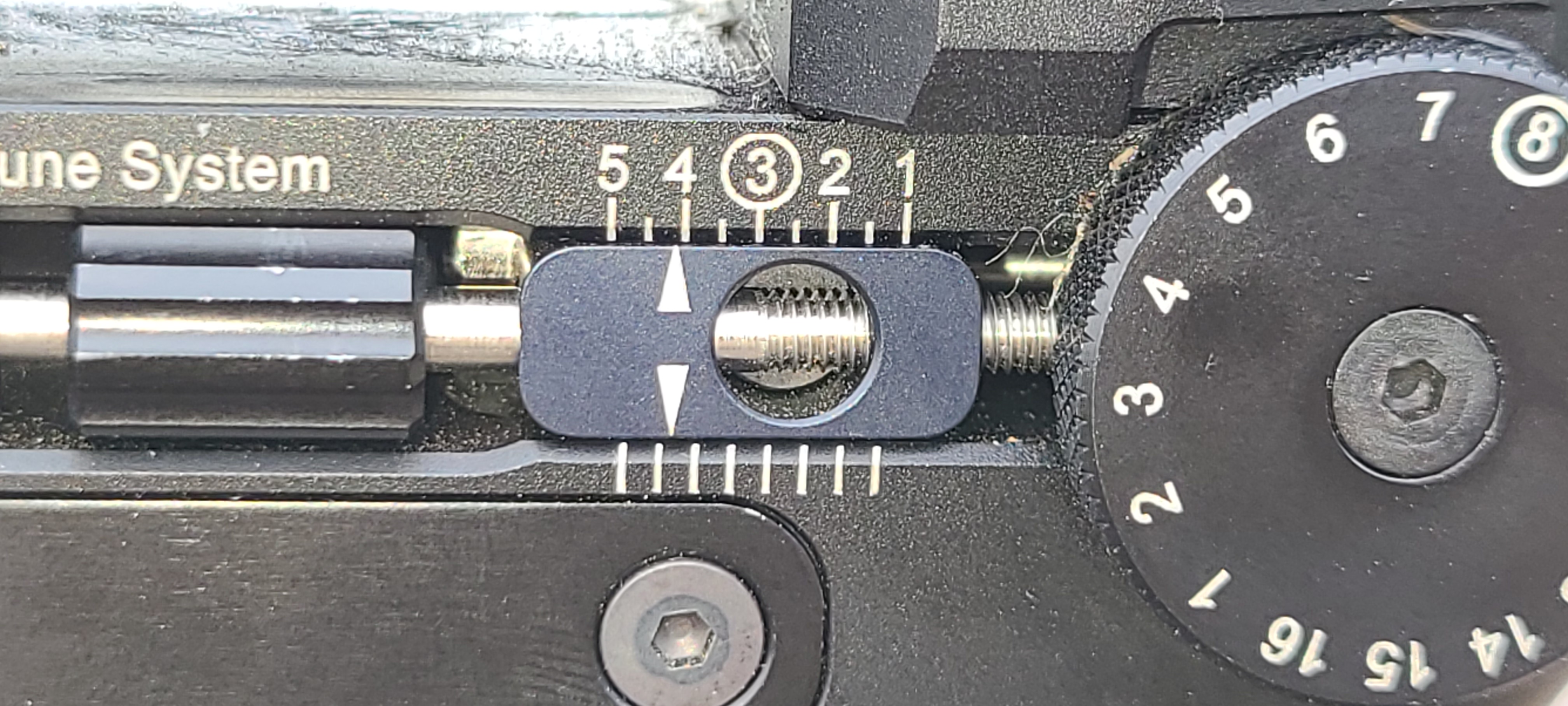

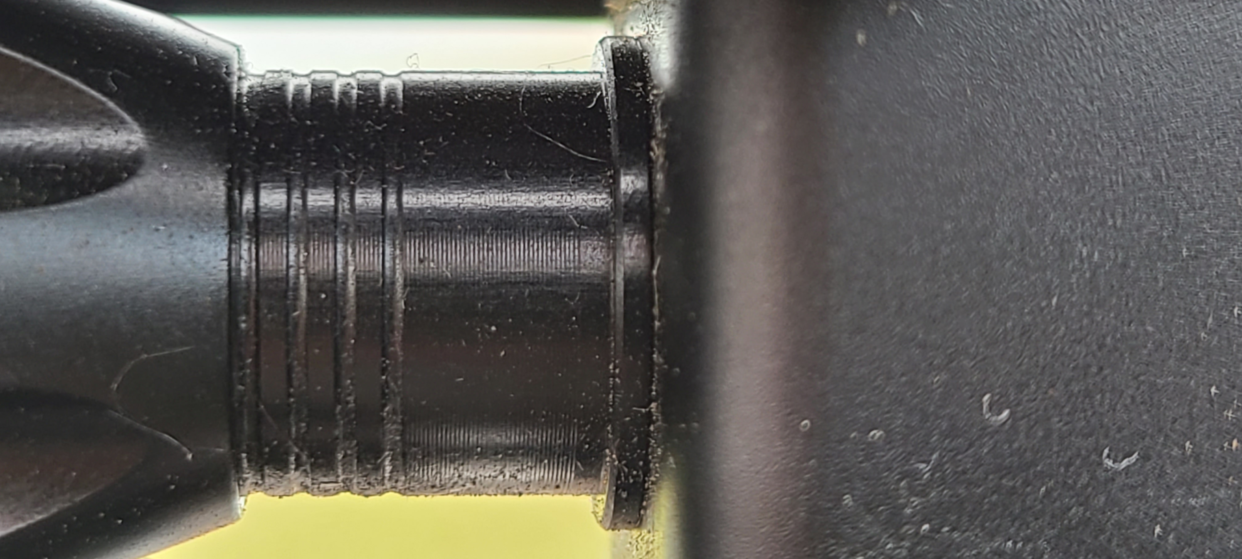

This is my setup for shooting NSA 36.2gr HP 980fps from my M3 Sniper
There is a recipe one needs to follow. Just putting some others tune into your fx will not work. Start at a beginning base line work up which means shooting quite a few slugs. Work past what you want to be at, (about 30 bar)then tune down. When you hear a nice crisp sound and everything is working properly and your getting dime sized groups. Stop.
