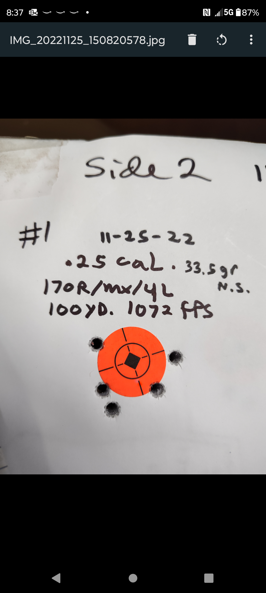

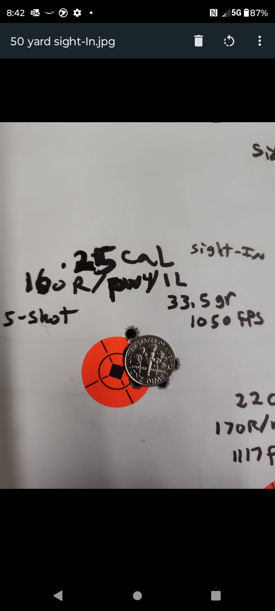

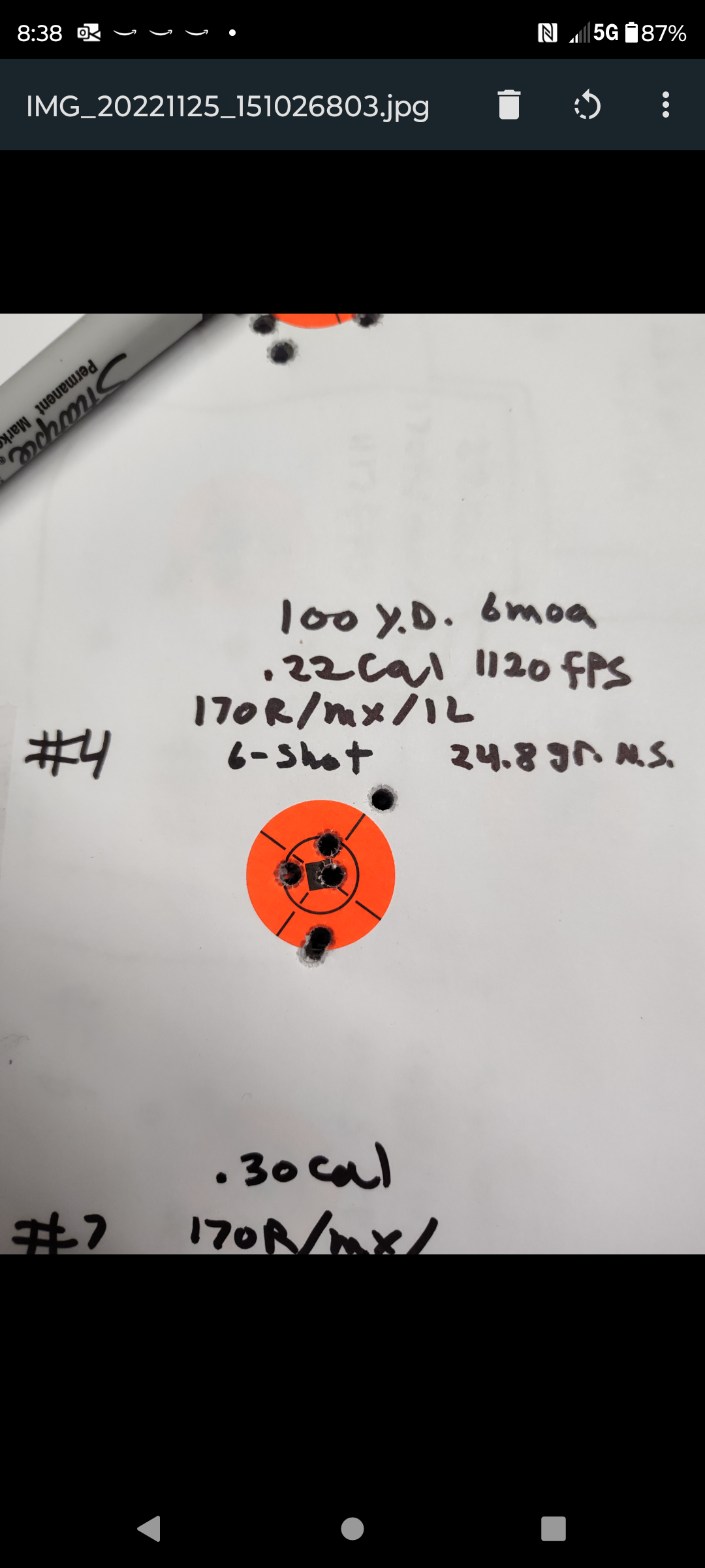

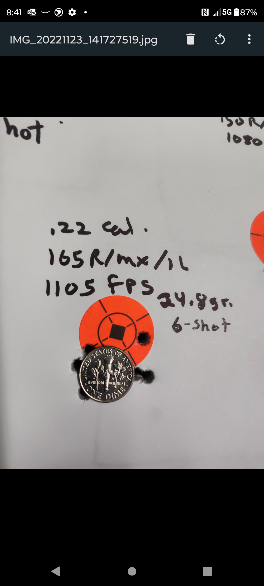

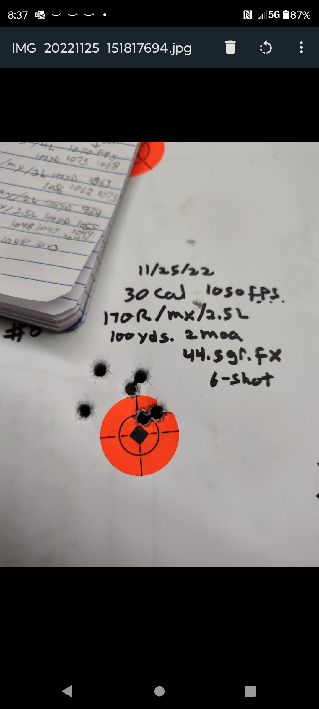

Some people have a specific reason for wanting the extra 150-200+ fps and aren't sacrificing a lot accuracy for it. I use my guns mostly for hunting and notice a significant difference in performance with the higher fps, especially at longer distances. Your right, if you are only punching paper at 50-100 yards, the lower velocity is sufficient and in some cases more accurate depending on ones ability to tune. We all experience different things and all need to keep an open mind.
All slugs - targets 1 moa
First two 50 yds. (All the rest 100 yds.)
Reactions: datornic
