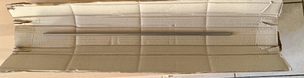

Different story here, but also confused as.......
I am not from the US, but from Belgium-Europe. First i got told i needed to wait until September 2019 to get a Slug liner for my Crown. (That was on Feb. 12) Suddenly, the 13th, i see that they are for sale in the Netherlands. Confusing number 1. I ordered one. A STX Slug liner A 600mm, part number FX20071.
The day after, UPS drops off something like wrapped cardboard. I open it up......and yes there is A liner, loose in it. No plastic around it, dry as hell, NO PARTNUMBER....Confusing number 2. I had NO idea if it was a slug or a pellet liner. Since that day, i am asking EVERYONE who has anything to do with FX Airguns, HOW TO IDENTIFY THE DIFFERENT LINERS. Supose i also get the B liner for the bigger pellets. Than i got 3 600mm liners laying on the table, and NO WAY to tell which is the slug liner. NO ANSWER TO THZT QUESTION. How can they see the difference? With measurements?
I sent the one I received back for a refund(no problem)
Why? Because i will never use parts I can’t identify on anything. I am cutious if EVER someone from FX is gonna tell how i can tell it’s a slug or a pellet liner. Look how I received it. Normal?
1550505628_13127304955c6ad69c06b2b5.06136915_082A55A5-9797-42D0-BBDD-61673D5C9EA4.jpeg

I did send mine back and gonna buy one agzin in about 6 monts. Maybe by then they have a dymo label printer, found in every store. Different size labels/stickers.
Yesterday i also received a very friendly answer form the service adress. I quote :
Thank you for ordering the Slug Liner! Right now, both the Slug Liner and Pellet Liner A have a engraved line around the breech end of the liner, where as the Pellet Liner B has 2 lines engraved. The only other way to tell the difference would be to "trace the twist" of the line

i got exactly the same package from Krale stores.
