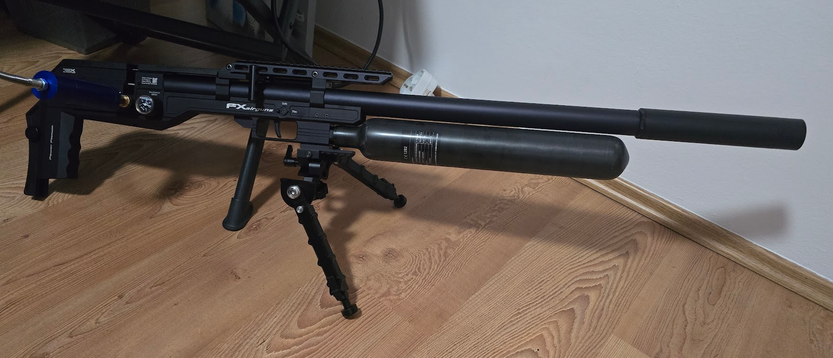

Hi all. I am quite new here, so please be gently. :)
Hoping to lean on the wisdom of some of you nice and way more experinced folk. I know not many people have the Leopart yet, but with hopes of increasing shot count, I am wondering if the 700cc CF bottle would not work on it?
The stock as you know it 480cc. Apart from looks, do you see any potential downsided?
I am aware, that I will still only be able to fill to 230bar due to the limiting alu rifle tube on the 700m sniper, until FX releases the CF version of that aswell (I wont hold my breath).
Thank you for any insights.

PS: I did look at Pyramid air specs and I dont see anywhere they would have said that it had 890cc bottle on the sniper or any version of the Leopard... But I do see how it could be confusing as they completly omitted the word total and also about the tube. They shouldn't misslead people :D
Anyway lets get back to my question (the topic) and here is hoping someone pops up that knows the answer.
