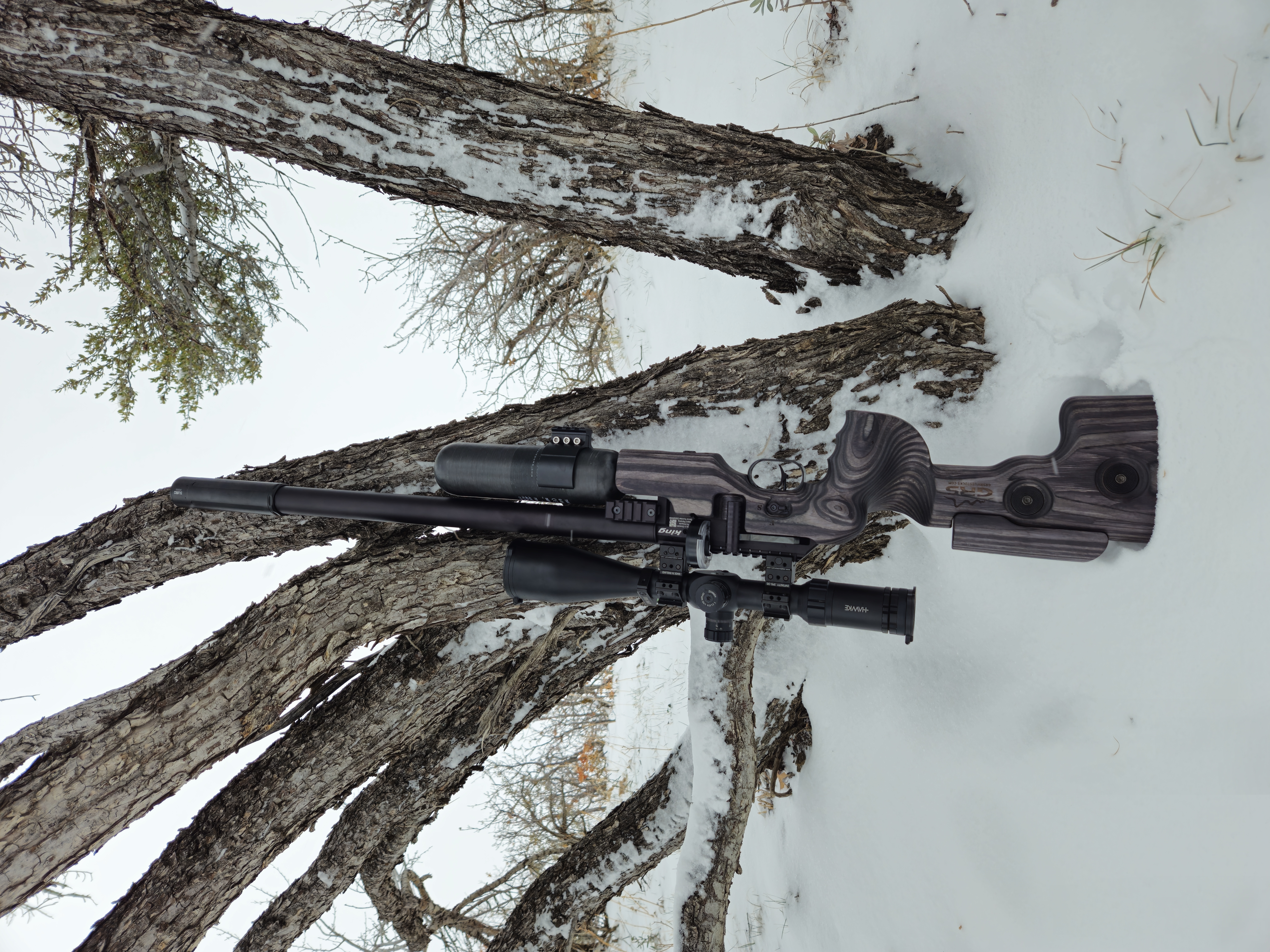

I decided to take the plunge and try out the new Pantha/Dynamic platform in the King configuration. A couple of quick points:
  • Right out of the box it had a slow leak that took a bit to solve , that ended up being located at the block plug that seals against a delrin washer. Tightening didn't work so I had to remove the plug and clean the matting surfaces and then reassembled it and now no leak
  • The screws for the barrel clamp were missing WTF? Thankfully I was able find screws that fit
  • After fixing everything the gun shoots great, and is very accurate and consistent withe the regulator set at 90 bar shooting 18gr pellets
  • Adjustment of the coarse adjustment power wheel the gun shoots 17gr NSA at 905fps and is stable
  • The GRS stock is top notch 👌. It shoulders well and shoots offhand better than any rifle I own.
So aside from the problems I like it but FX needs to get their quality issues figured out. A consumer that doesn't have the skills to fix PCP air rifle issues will be very discouraged.

Bummer it came with a leak and missing hardware. Were did you get it?
Don't want to out my local shop but, yeah I agree it should have never left Sweden like this. I did take it back to the shop to fix the leak but, they weren't able to find it and said the gun was not leaking... guess if you want a job done right you have to do it yourself. 😉
