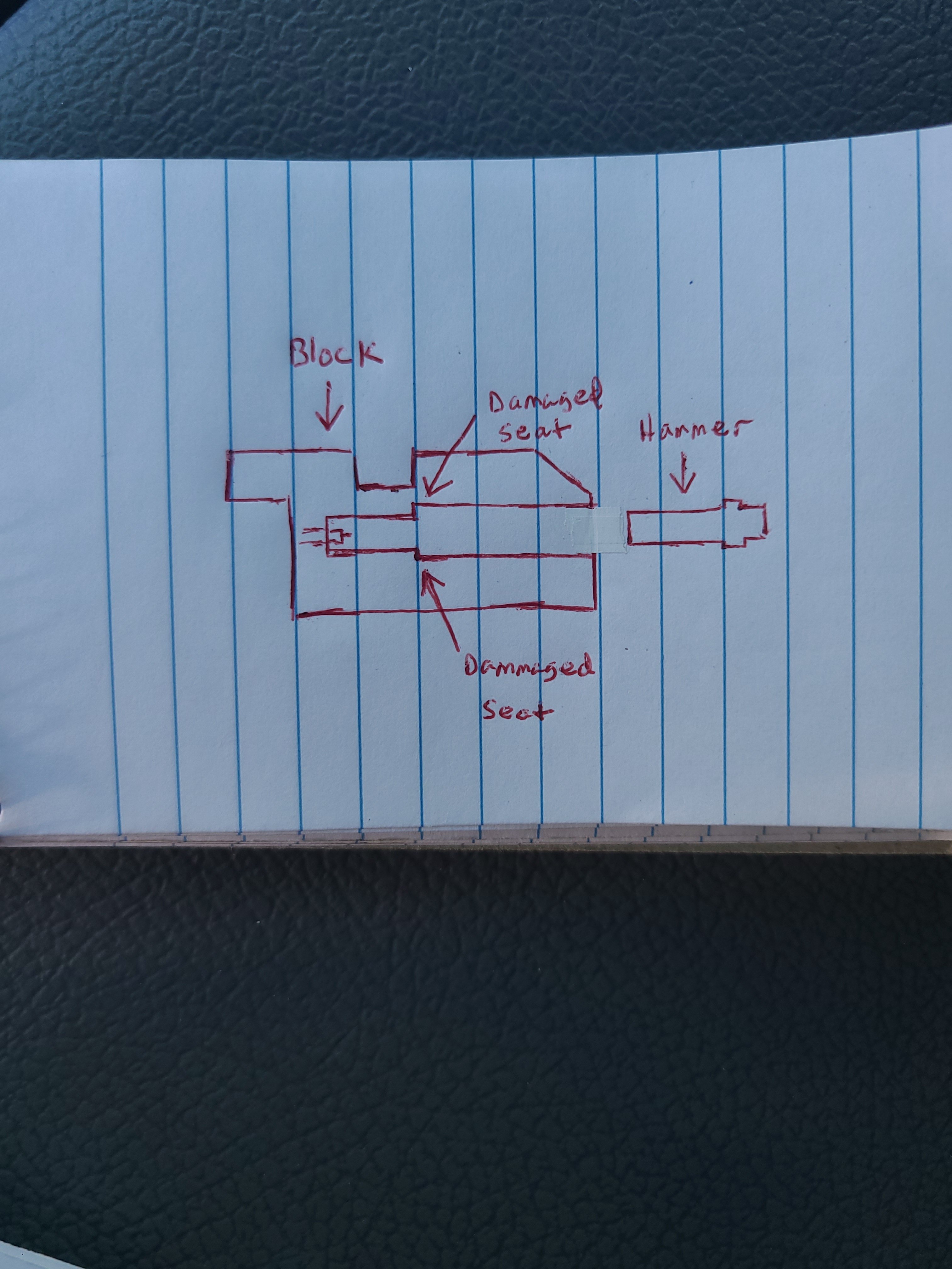

Sorry, I can't zoom that out. They were taken with a bore scope. Here is a sketch I did earlier.
I'm not familiar with the FX models and have no idea how they work but the picture shown doesn't look like a spot where a hammer or semi fixed object was hitting another surface. The impact marks almost look helical like rifling (I know it's not the rifling. )
100% that is where the shear surface on the hammer was striking. The hammer rotates, it doesn't have a fixed guide. So when it's cocked, the spring can rotate the hammer etc.
There is two milled flats, one of both side to provide relief for the vent holes. The hammer can rotate in its bore, The pattern you are seeing if from repeated hits.

With the way the marks have material displaced outward towards the hammer, and the rotating pattern they show, I believe they are tool marks from manufacturing.
If it were caused by the hammer smacking it the damage would be imprinted and probably not have chunks broken off. Those chunks might be what you saw in your trigger assembly.

That kind of what I was thinking. Looks like tooling marks. Crazy it even got sent out like that if it's the case.

I agree. I would almost bet my house that was a reamer that was fed in crooked and started to oscillate back and forth, cutting those gouges before finding its center. And I know because I've done it before by accident 🙃
