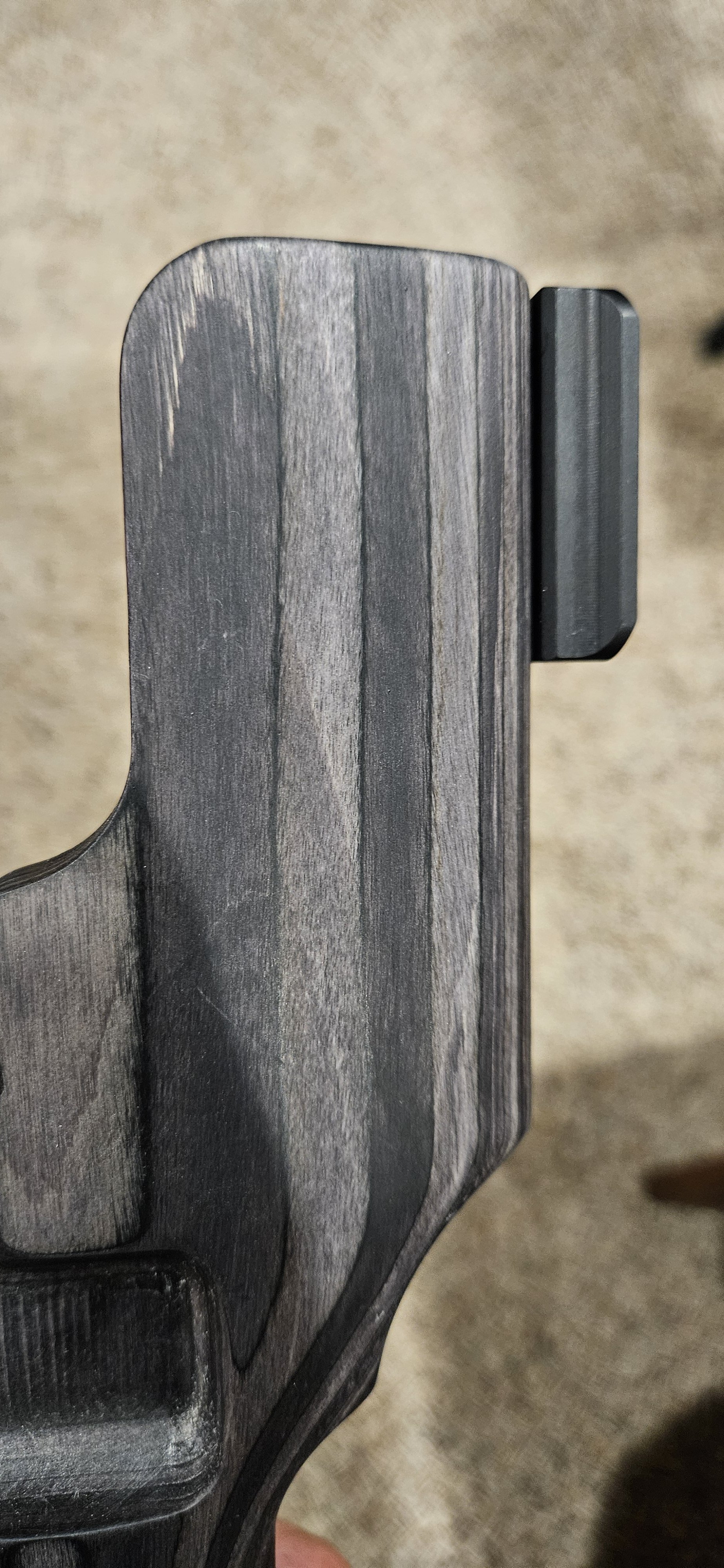

Does anyone know if PRS or Saber Tactical or another fabricator is making a bolt on ARCA rail for the FX King? If not I sure hope they see this thread and start developing one, that would make it the perfect rifle. I love the PRS ARCA rail on my Red Wolf.

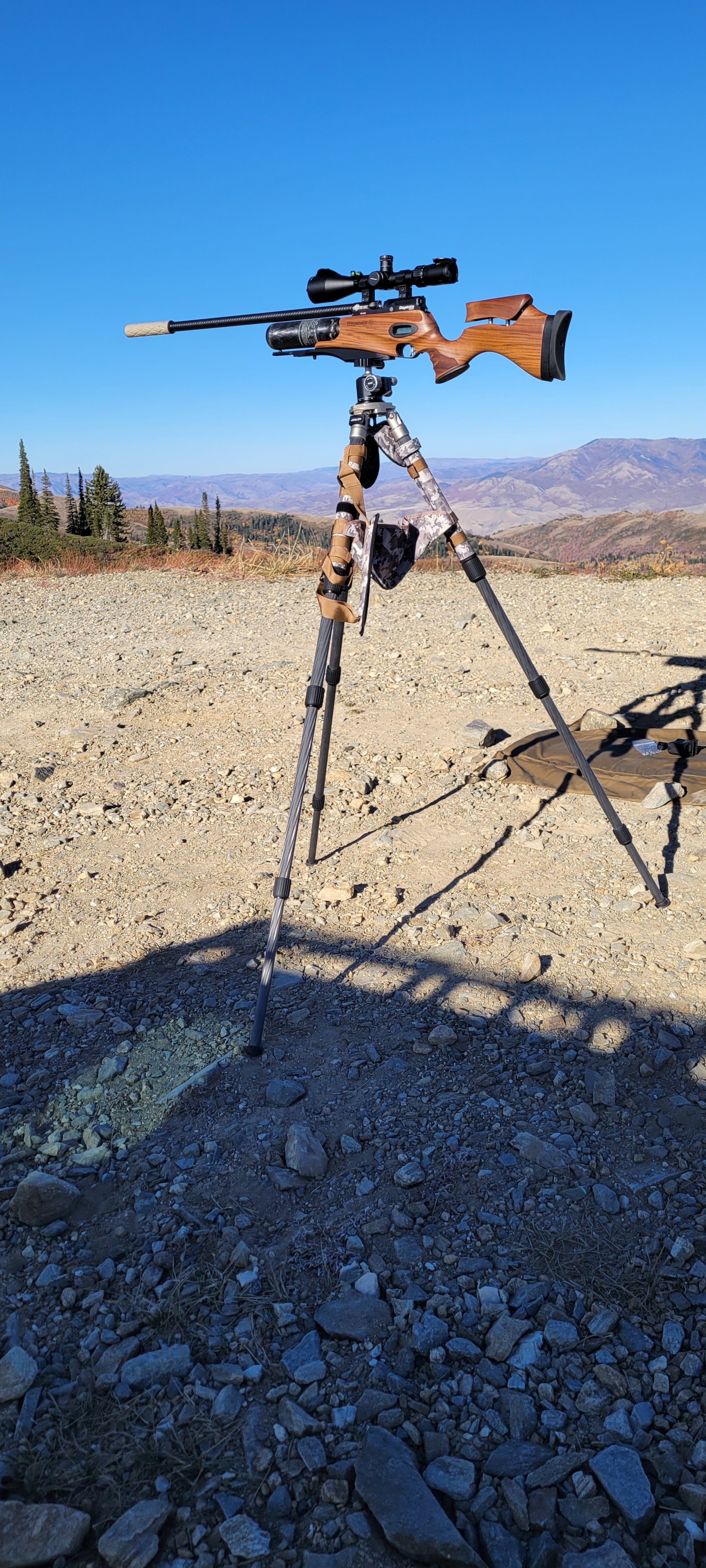

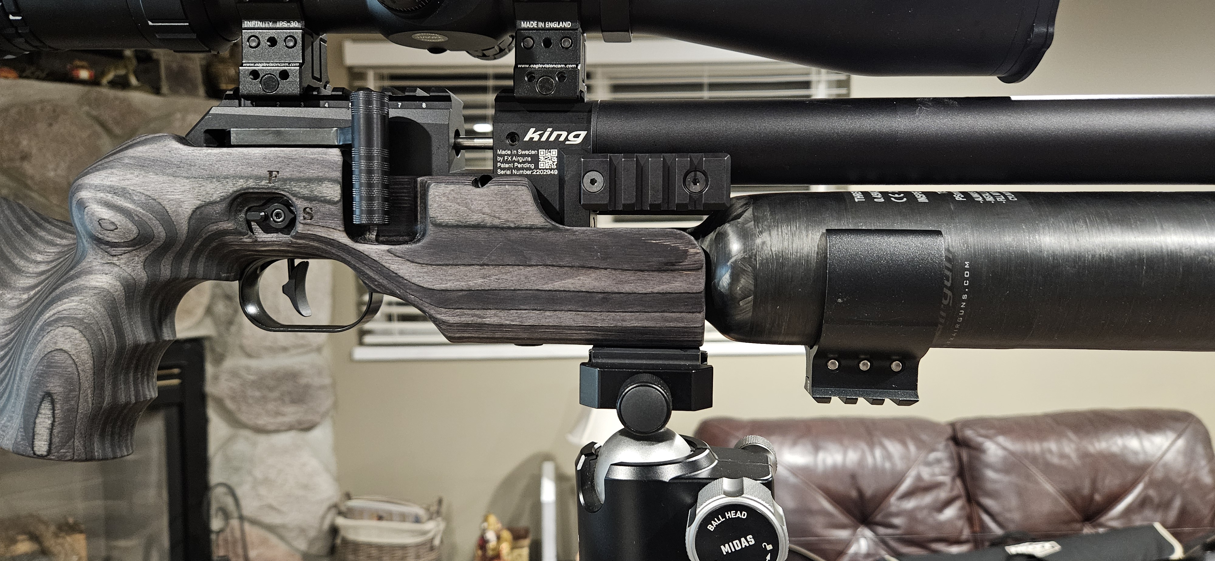

Good luck with that one. It's more profitable for them to sell you a new stock, and that is what they will be doing. Complete nonsense. After hitting a dead end a few months ago, I ended up mounting a mini arca for my tripod. Went with the 1/4-20 option. Using a clamp for my bipod.

Almost forgot, KRAFORD AND LYPT was willing to make me a bolt on rail, but they needed the gun, I was just not willing to ship it. Send them an email.
Looks like a good option. Did you use blind nuts or wood screws threaded into the wood? I'm nervous about the wood delaminating.

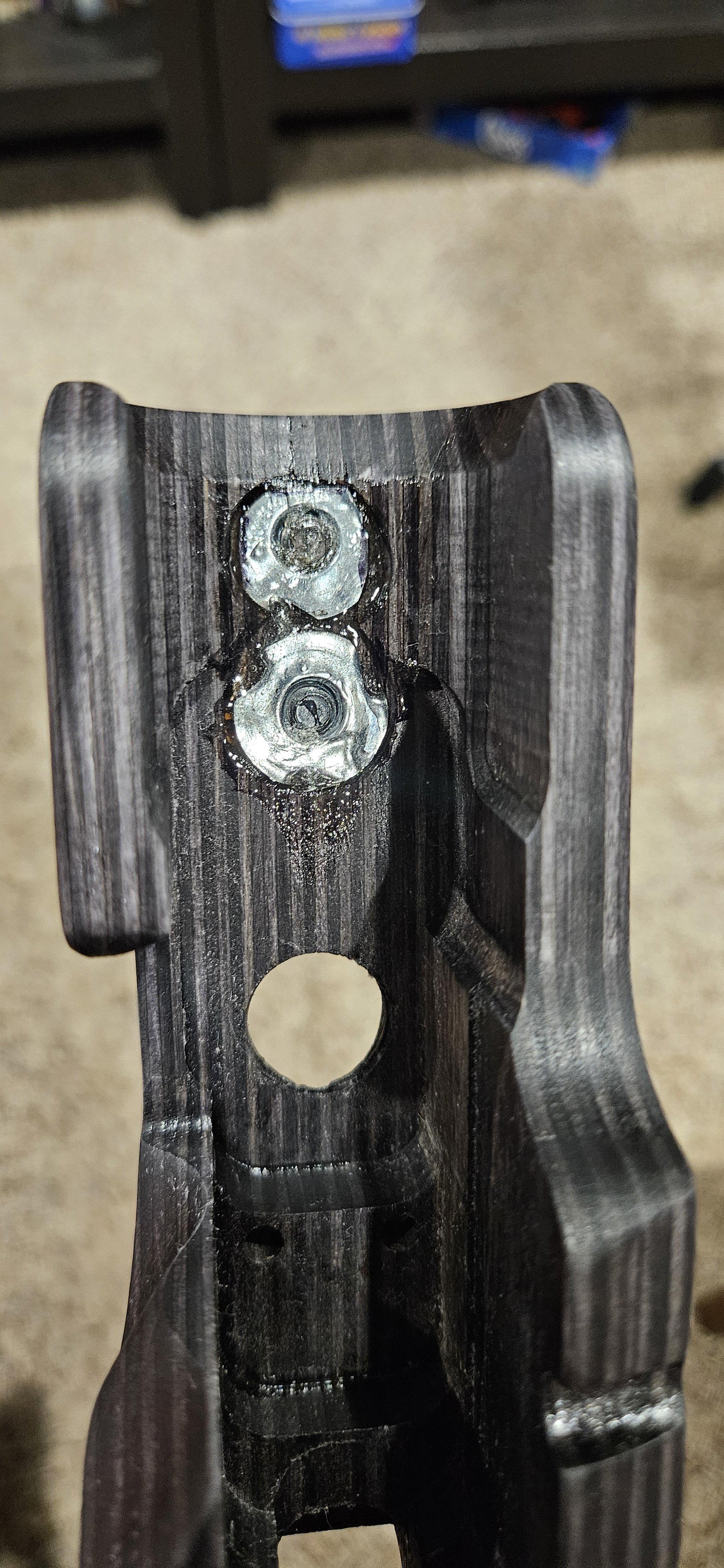

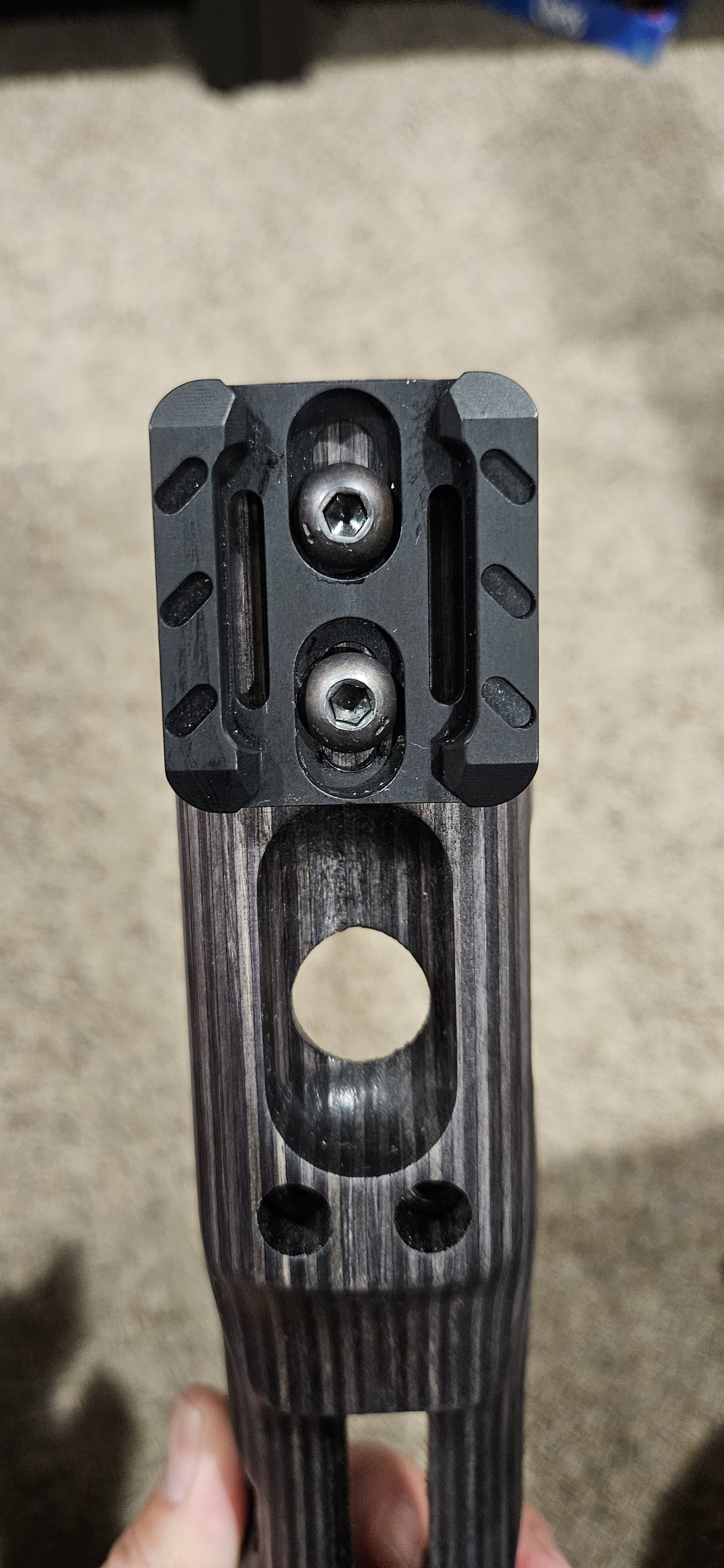

T nuts for wood that came with the rail, snipped off the fingers and epoxied in place through the holes and a layer above. I had to remove some material on the inside off the stock to clear the neck on the bottle. Yeah, it's a risk, but didn't have a choice. I'm not using the bottle for my tripod.
Thanks, in that case I guess I'll roll the dice and install a stick of picatinny rail using blind nuts and do the same epoxy method as you and hope I don't have an issue. It doesn't look like you are having any issues. I'm with you on not wanting to put stress on the bottle, a bipod is okay but not hanging on a tripod.

No issues so far, rock solid. I thought about mounting a 10" rail, but backed down. I think that would apply to much force.

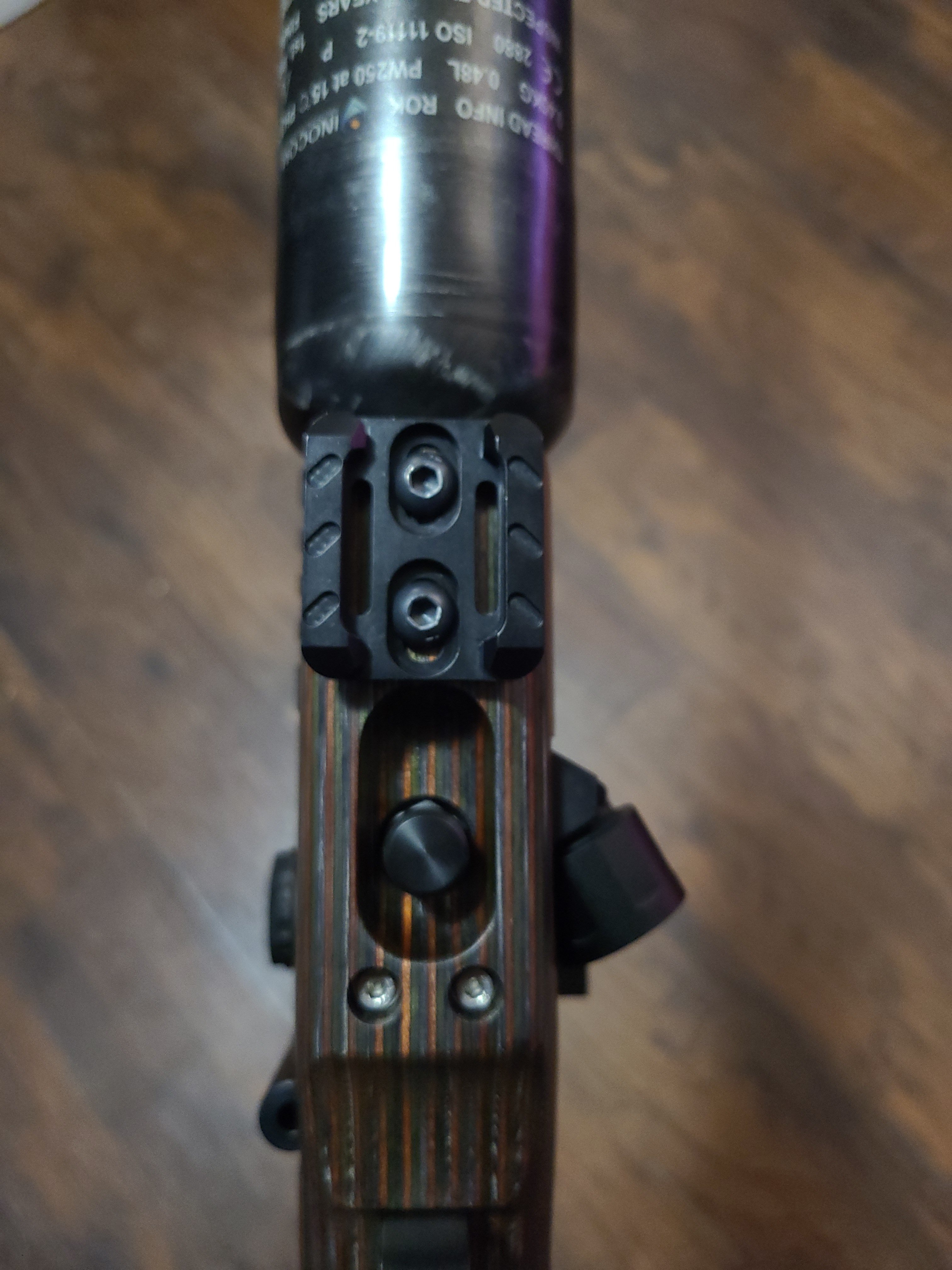

Installed the ARCA rail on the FX King today. It was a fairly straightforward install that did involve countersinking the t-nuts and as Toothie did I too cut off the t-nut barbs and shaped the front one to fit behind the slope of the wood, and glued them in with epoxy to ensure a stable fit. Thank you Ta-Ta Toothie, for the advice and pointing me to Salmon River Solutions for the mini ARCA rail it's a perfect fit.
