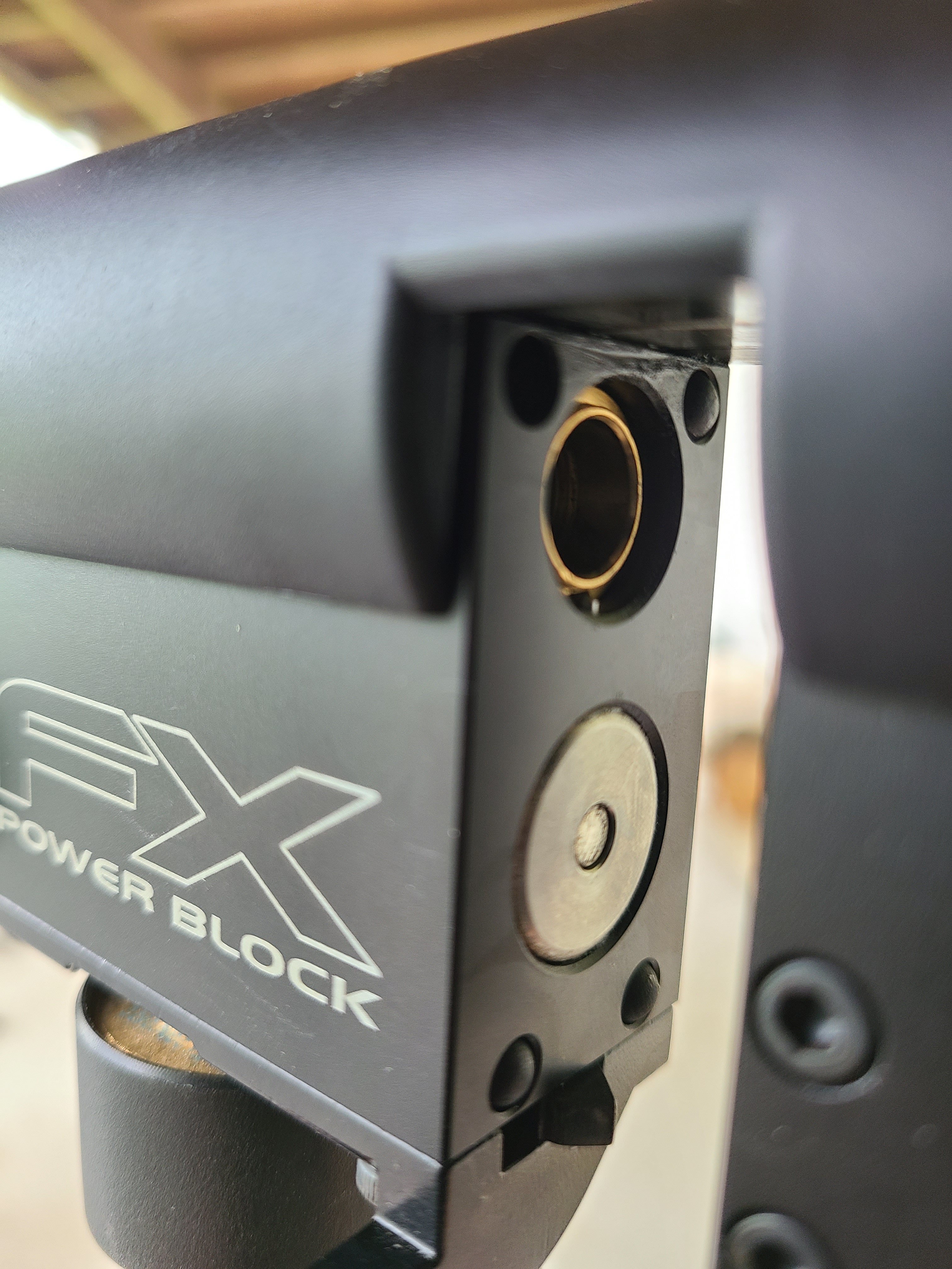

Pic for reference.
You can see the top left black ball is missing. Id found one on the ground and popped it back in and it is staying with each shot.
Is that picture before you re-seated the barrel, or after? I hope before...Your brass transfer port seat should be flush with the back of the breach.
One missing ball should not be a problem. All 3 of my Impacts are missing a ball or two, all in deferent locations. They are there to support the magazine. Looks to me like you would technically need at least 2 to keep the magazine aligned.

I contacted utah airguns after i made this post, they are sending me a new breech seal o ring. And you are right, those little balls are to keep the magazine snug and in the pic the barrel isnt seated correctly but i have since fixed that. I was impressed with utah airguns, they answered on the first ring and got me in touch with a tech right away. They knew what was the issue just from my description and sent the o rings without charge of any kind. Very good company

It may in fact be the breech seal, but your barrel is not seated correctly. There is a groove and pin that align the barrel and yours is not in far enough into the breech. The breech o-ring goes inside the barrel housing, in fact you can see the groove in your pic, but it is not the end of the barrel that gets the o-ring, but inside the breech. Apologies if that’s obvious.

Pic for reference.
Sounds like you may have blown the little oring on the valve. Easy fix, but annoying because you have to take apart everything to get to. That is if it is still doing it after you reset the barrel back in the proper place.

Yeah, the barrel slides back into its proper place and the screw is holding it there properly. I can look inside the barrel and physically see the o ring is missing inside, so im pretty sure thats the issue (and hopefully the only issue)
