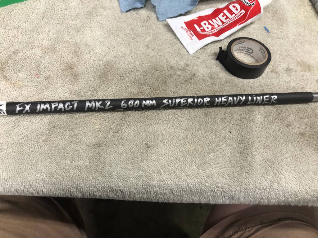

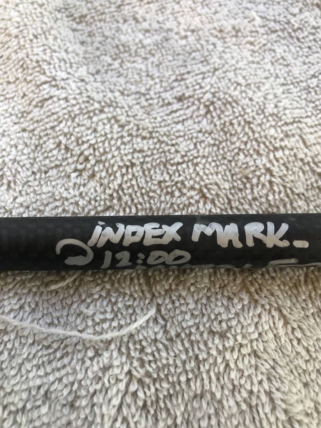

Oh, and I’m with Patrick on the liner sleeve. Made a difference for me, some slight, some very noticeable. I’ve epoxied many sleeves on these fx liners, to not do so would leave me feeling naked, lol.
If you so choose to epoxy one on, make sure and first pull the twist rate off of the liner, then you can label the twist rate on it for easier identification-
