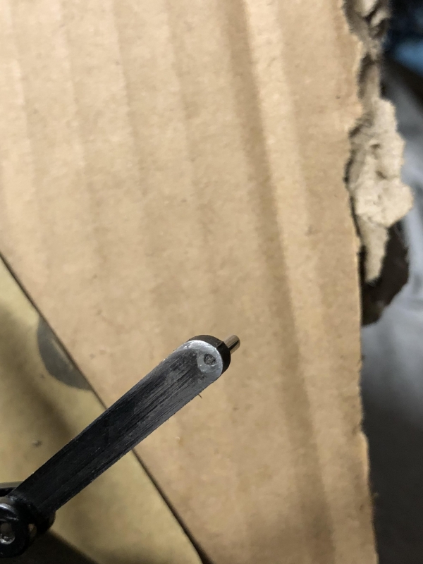

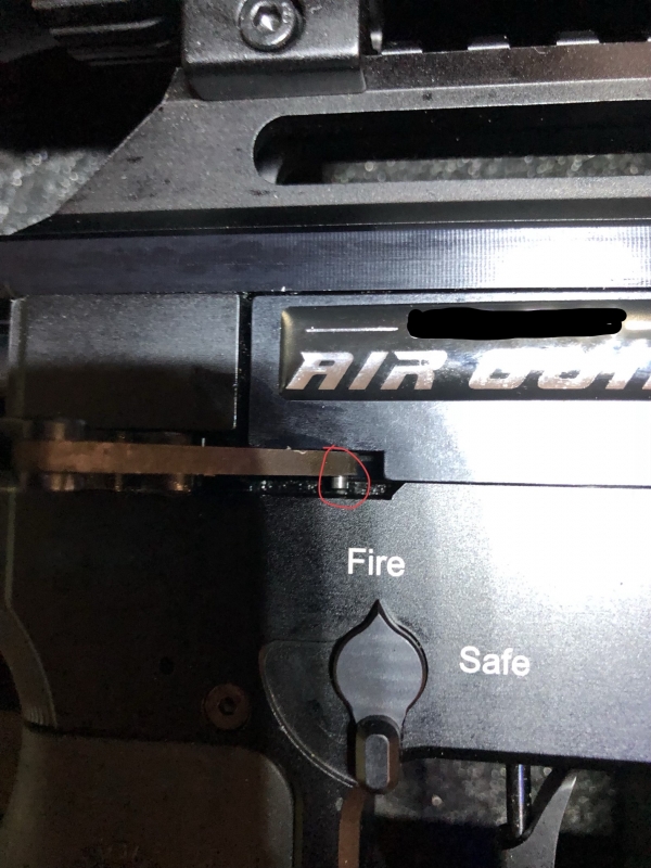

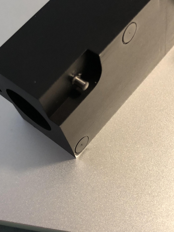

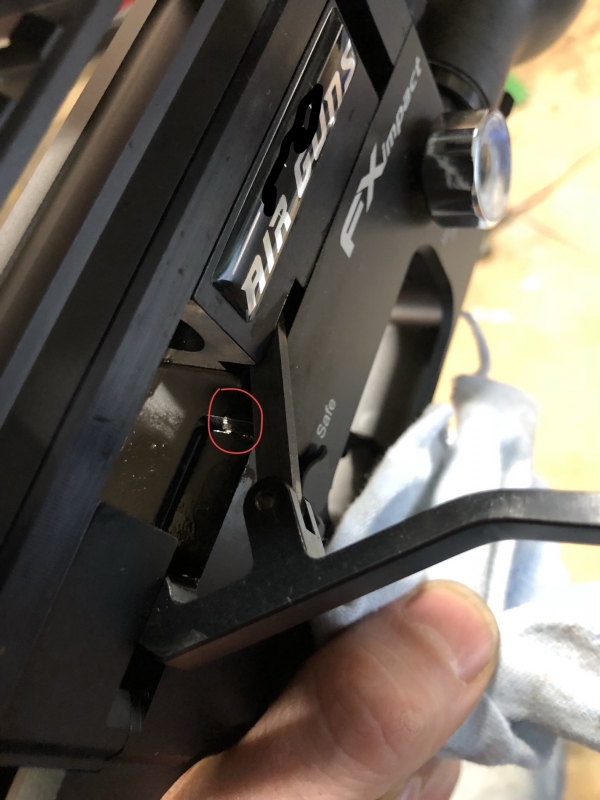

Thing shoots great..or it did for the first 200 shots. Issue is that the pin holding the bolt to the block housing is loose...so the bolt comes back then gets stuck. You can push the pin back with a screwdriver but it just drops again.

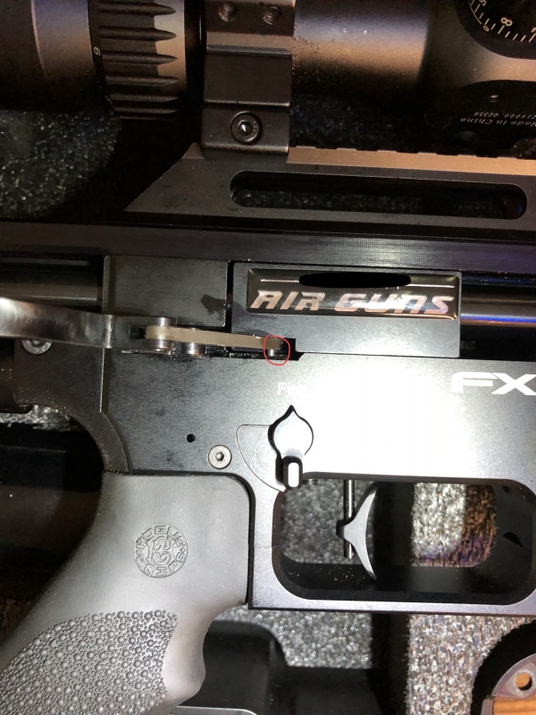

THIS was the treatment I wanted for buying 2500 worth of pellet gun. Anyway after talking to him and getting assurances about the warranty I unbolted the upper half and started looking over the situation. Esting said I could center punch the pin and I could call back with questions...but that didn't work for me plus it was getting late and I was certain I could get parts if i screwed up.....so I decided to braze it on the bottom (my idea). At first I brazed both sides for strength, but that messed with the tolerances...so I just did the bottom (see pic 4) you can still see a small "pin" hole as I did not want to go crazy with the solder. I used a tiny bit of flux and put most of the heat on the mild steel linkage.
Very happy to be back in action with no "pin drift" and no slop in the action. I am still going to ask FX for a replacement bolt in case my brazing gives out. After brazing and sanding it I re-blued the steel so it looks factory.
