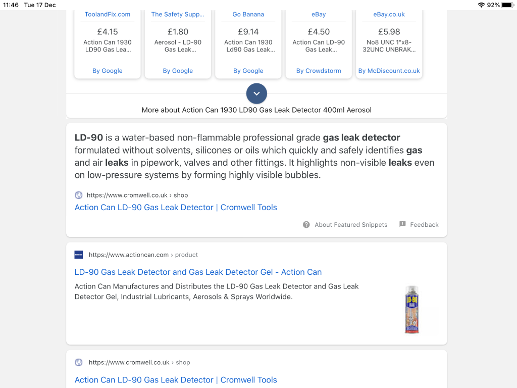

Don’t use soap, it contains salt, it is also very searching, any that seeps around a thread will cause corrosion (I have lost count of the amount o seized screws I have removed from guns) . Save yourself a load of grief and buy something like this
salt free, leak detection spray
