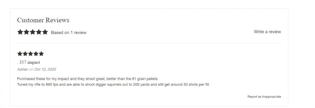

We have received some emails as well but here is a link to a review on the product page for 93 grain. So far the .357 sized slugs seem to the right way to go and is the only slug that we have received positive feedback on so far. Does not mean it is the only slug that performs but only one we know of. We have probably received 4-5 positive reviews on the 93 grain .357 slug.
https://nielsenspecialtyammo.com/collections/357-cal/products/93-gr-hp-fb-35-cal

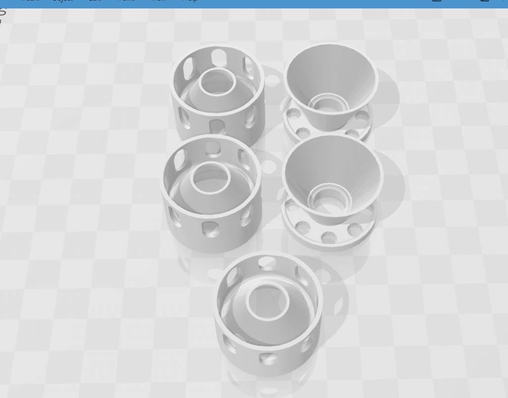

I went to 160 bar and increased the hammer spring. I also 3D printed up some baffles for the empty chamber on the end. Same as I did for the .22. Cut the noise pretty good. I would not hesitate to take coyote or deer with it. I am hoping to end up 925 or so and decent groups out to 150 yds.
