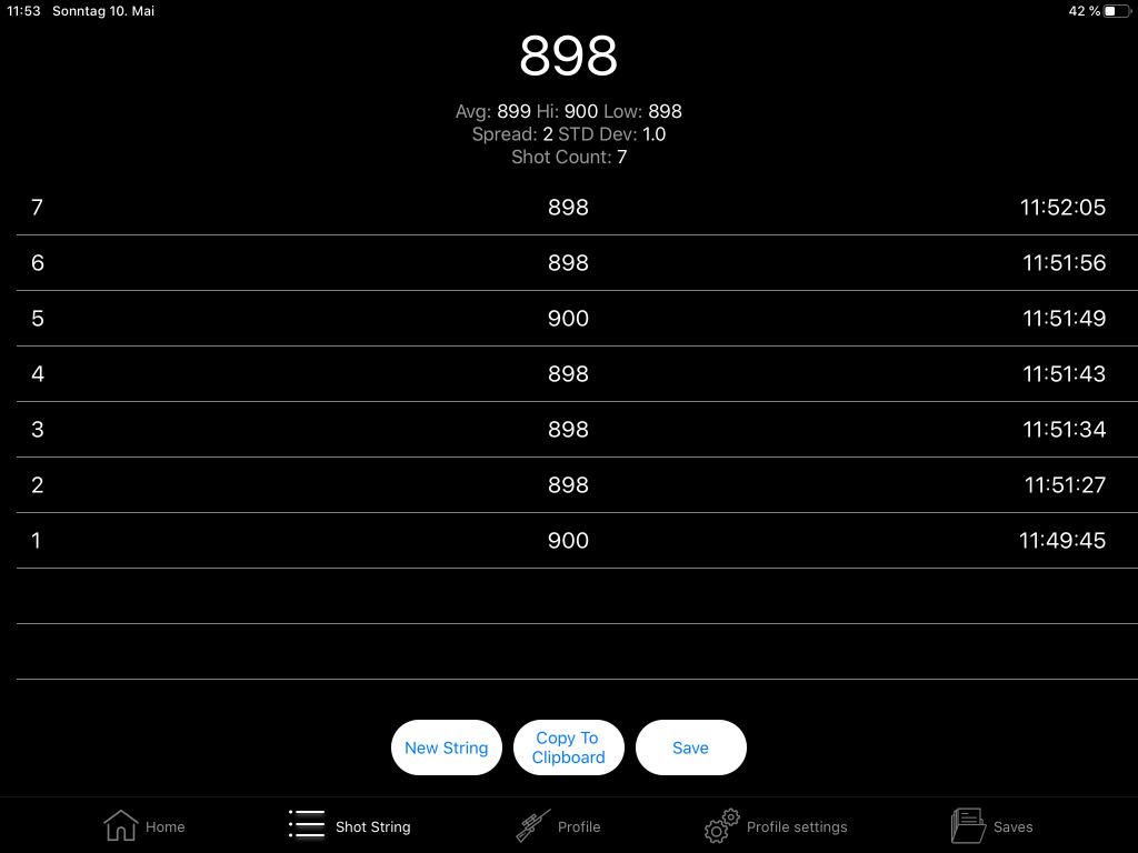

a week ago I’ve tuned my Impact X .30 700 mkI like the guys from 68. Whiskey. on YouTube.
now im shooting the 44.75grain JSB‘s at 899fps after 7 shots with That numbers:
here are the settings of my Impact:
Hammerspring: 14,24mm
Valveadjuster: 8,68mm
Regulator: 143-145bar
ive done a video of the Tuning session, maybe it’s helpful for someone and not too boring.

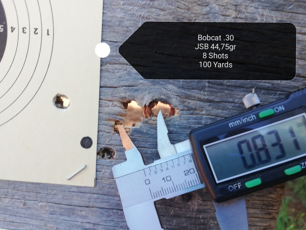

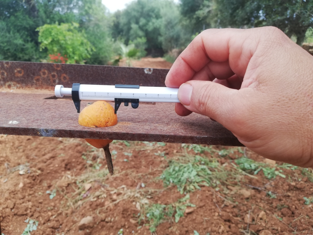

Not counting flyers 2,1cm center to center at 92m (100 yards) last week I was shooting 3 medlars at 92m 4 shots the first one missed

Woooow, that’s really badass! 👍🏻👍🏻👍🏻😳 great shooting bro!!
dont worry about the miss of the First Shot, everybody misses. And 100yards there are no complaints, well done! 😉
my next thing I like to do is the same group like u did under an inch, well done!👍🏻
