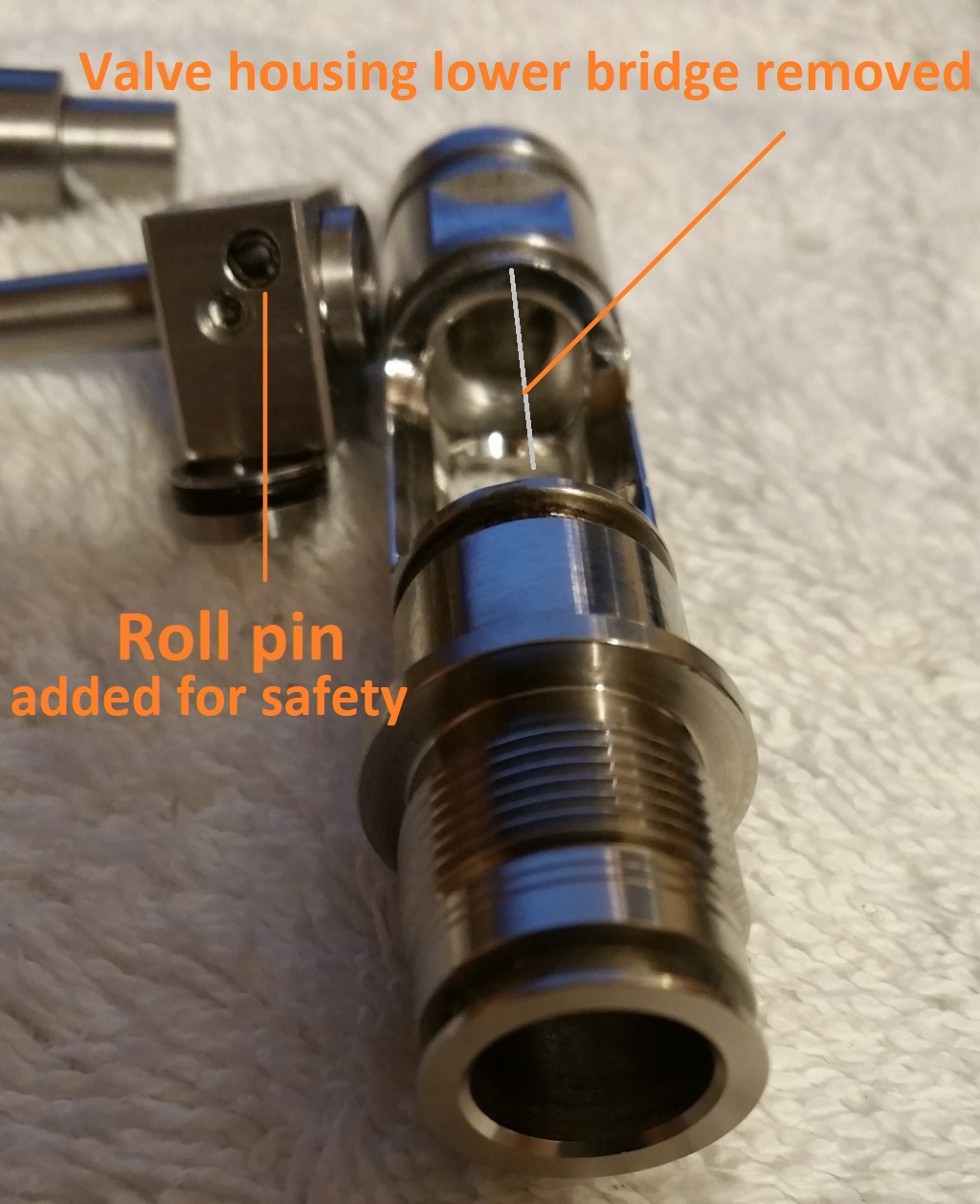

You have to modify the valve housing for an external plenum or else the air has nowhere to go.
Ignore the roll pin mod, you just need to cut the bottom bridge off the valve housing like in the picture.
Also drill the hole where the gauge screwed into the rear block to 6mm while the valve housing is out and remove any burr left on the inside so the o-rings slide past with no damage. I use 3M pink polishing paper for deburring and polishing.

Thank for reply. Valvehouse mod I already did. Forgot to write in my post. I removed the delrin from the gauge hole. I will try to drill it to 6 mm as well. I’m getting 900 FPS at 120 bar but have to push it to 150 to get 930. The hybrids are only 22 grain. Was expecting them to fly fast with this kit.

Other than removing the bottom bridge, any other mod needed to get the external plenum to work?
