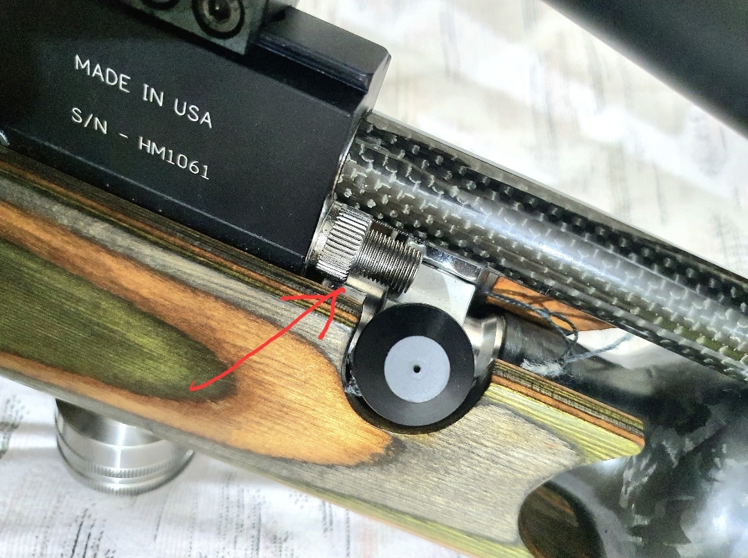

When I tune an Impact, the valve adjuster gives me much more refinement in efficiency, consistency and accuracy than the guns without exrernal valve adjustments.
All those guns which are specific to a certain caliber and certain power level, do not need the valve adjuster but when we opt for a platform where we can use various power levels and various calibers, valve adjustment is very helpful as I understand.
I feel it so important that I have improved my RAW HM1000X by installing an externally valve adjustment system as shown in following pic.
