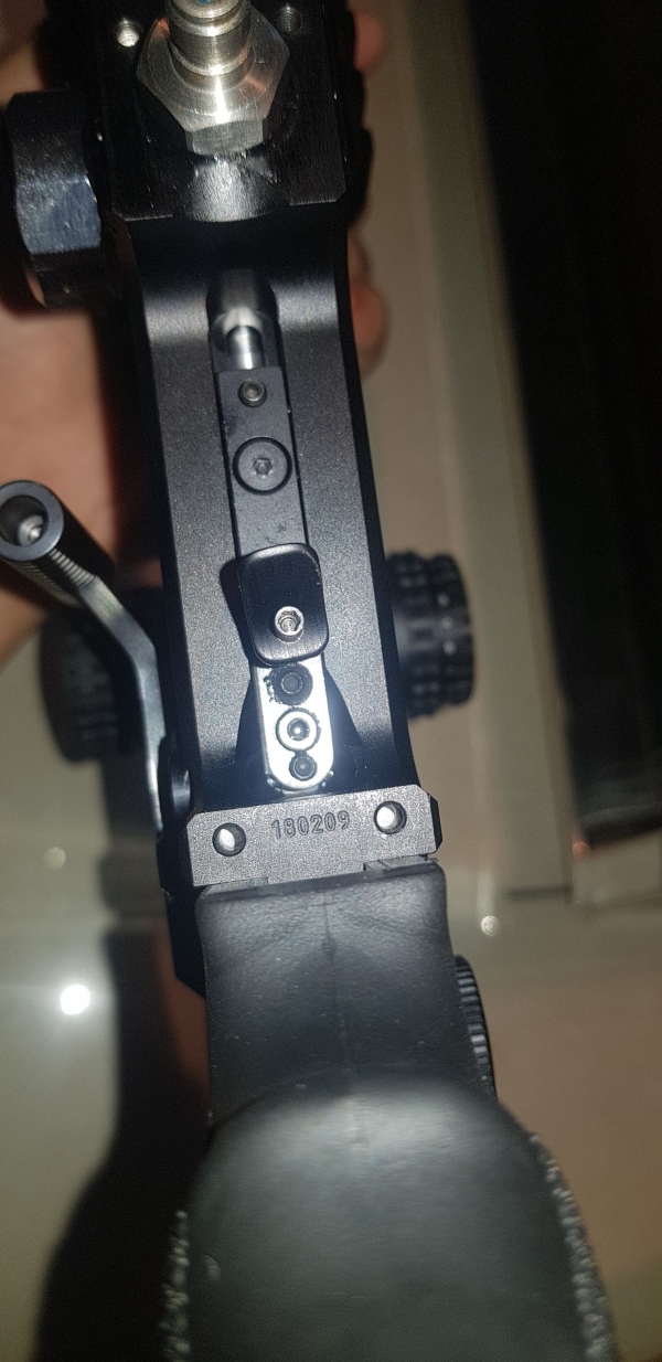

Hey Guys,
I have tuned so many ways to increase my FX IMPACT. But I only get 750fps~810fps. I only saw one time the velocity reached to 840fps. And the velocity is not stable and consist. 5~15 fps deviation.
I don't know what's the reason the velocity could not go up to 860fps.
Does my regulator break? It still works while i turned the allen key. The back gauge will show the pressure up or down.
(I remove the bottle every time before turning the regulator)
Below is my setting:
FX IMPACT X 700mm .25
Pressure: 140bar~150bar
HST: 14mm~ Max
Valve Screw: Nearly Full Open
Pellet: JSB 33.95gr
Hey Guys,
HST: 14mm~ Max
Pellet: JSB 33.95gr
Hmmm, might want to turn the hammer preload screw in so there's no.slop when the wheel is in HIGH.
Hopefully FX USA will be back up and running soon so you can give them a call

Just checking is there any chance you are using the smaller port on the barrel?
