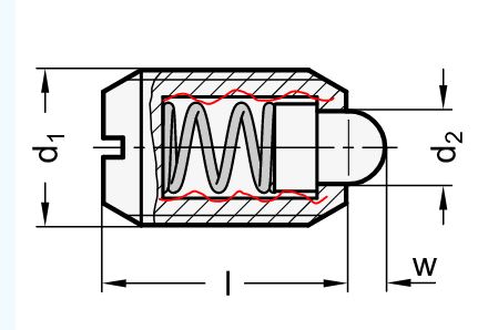

        Polish the surfaces as it was explained earlier, lube the finished surfaces slightly with molibdenium (no need very much only to wet it little bit), Honda (service part) has the best grease 77% molibdenium.
        From here You can try ordering from different sources different material plunger screws (this and that - steel or brass or wtvr), you will start feeling the difference when the small spring inside (the plunger screw) rubbing the walls. This sensitive it will the trigger second stage become. No sense to talk about this further you need to get to that standpoint that you able to swap the plungers.
        M5x8 is if I can recall it seeing in the BOM. And also, yes, you can get adjustable spring tension for the M5

          Maybe one day I shall take this screw apart and polish the hole, because when I squeeze the trigger in a "second stage" I can feel how this spring is rubbing against the walls.
