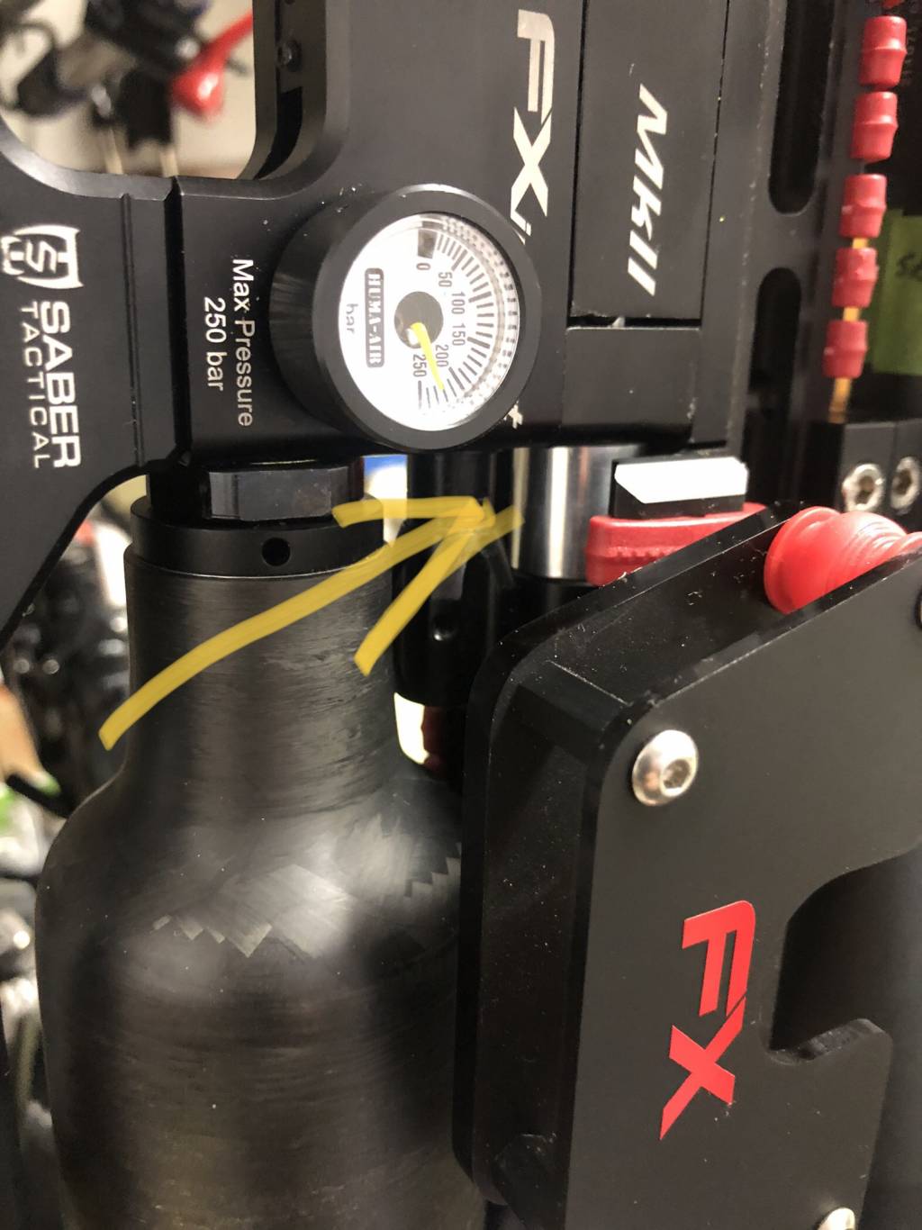

Well, that may be possible, but I’m gonna go with what FX said, which is that they started putting the new block on guns manufactured in January 2022. My gun (M3) dates all the way back to May/June 2021so I expect that I have the “old” M3 block. I assume that is different from my MK II block, but maybe those are the same and only the Power Plenum is different on the M3.
My opinion only as I don’t have the new block on hand-
1. The rear blocks on the M3 and MK2 have to be the same, and I’m highly assuming that because M3 power plenums can be purchased in kit form and everything in that kit minus the pp body is exactly the same part as on the MK2.
2. The new block has a larger air passageway between the valve and the barrels transfer port. Others in the past have done this mod by drilling thru the valve body grub screw port, that locks the valve in place, to enlarge that passageway and had to re tap the grub screw hole for new, larger diameter metric threads to accept a new larger grub screw with this mod.
sometime in the last year, Ernest posted a video of him enlarging that passageway with a special two part drill bit so the grub screw chase would remain intact at 6mm.
it would make sense now that with the larger opening a different valve would be used, as shown on utah Airguns parts catalog for FX

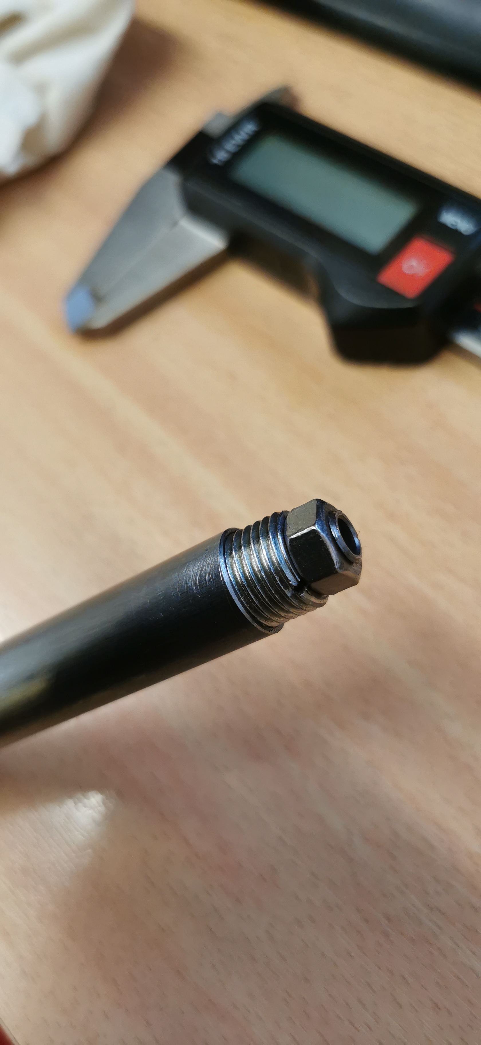

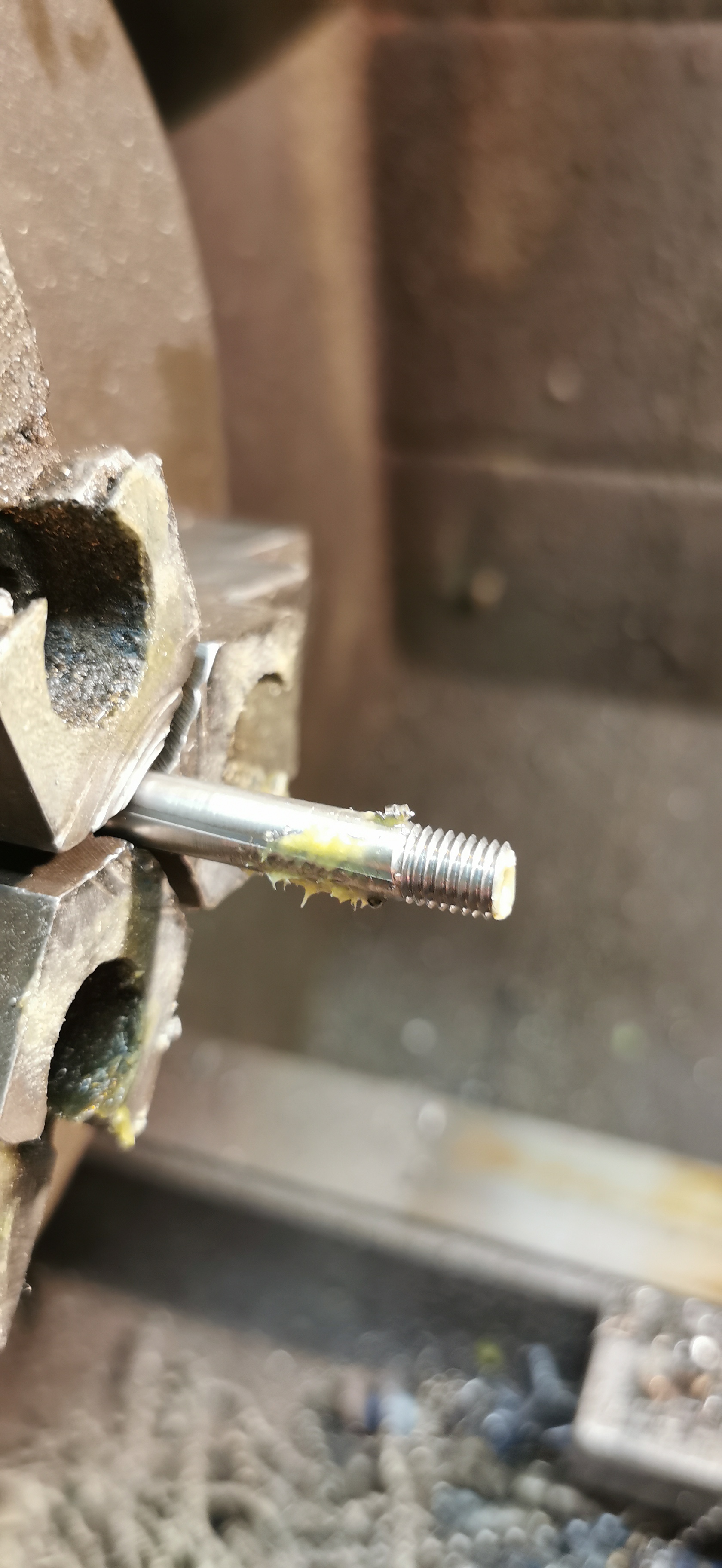

Hi,
I didn't think I would write about what I did, I'm not a person who writes much or everything about tuning but:
I did what you mean without knowing this topic here on this forum. I got this link from a friend ( he shoots too fx impact), so I logged into this forum and I have some answers:
Yes, I made tensioning system only for the liner not the housing
Yes, the results are excellent for me, and I will not change back to oryginal (FX)
Yes, shooting accuracy is much better than what I had
Yes, the shot groups at 50,75 and 100m are pretty much the same (almost every group is about 2cm) - it doesn't matter how many shots
I would not like to inform you about the solution how it is done (in details) but here some pictures
liner threeds for tennsion
how looks after tennsioning & everything was put together
The tension of the liner is about 0.5mm....
I had to use o-rings inside housing because it sounded like a guitar
Reactions: mubhaur and tibor

How is the liner tensioned on the breech end?
