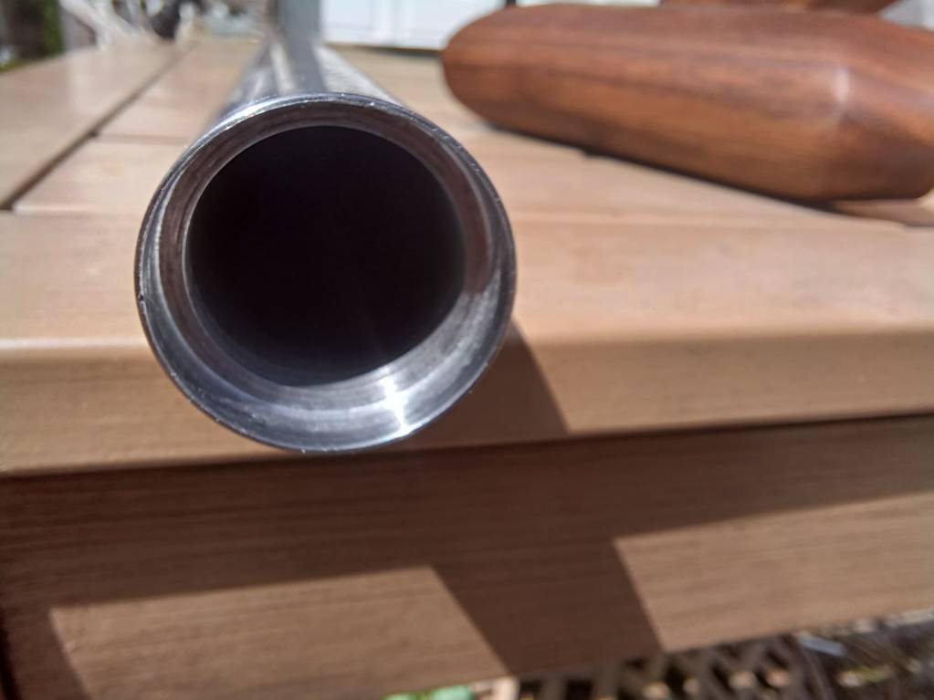

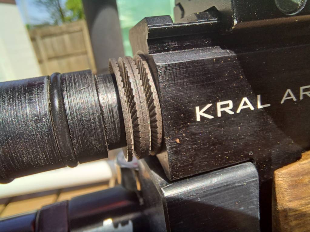

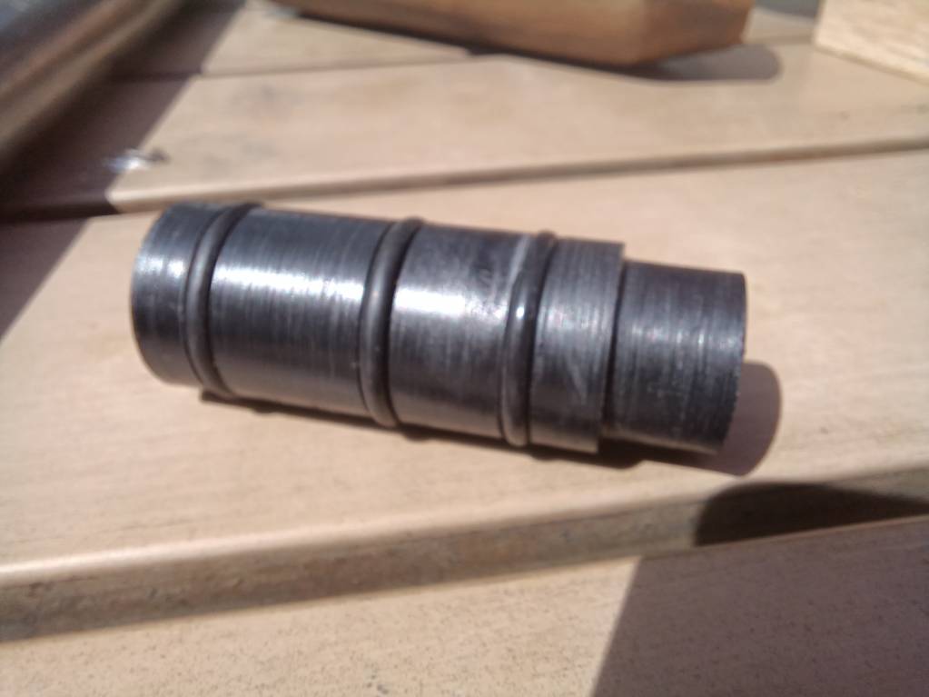

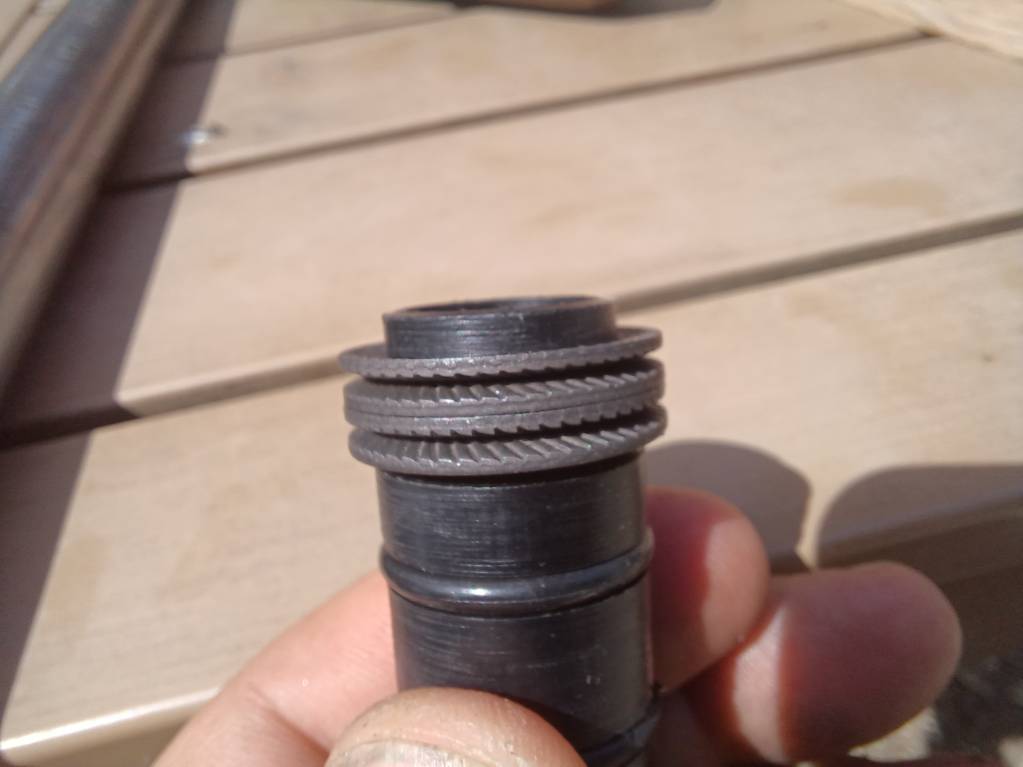

Did you make a new brass transfer port piece threaded or you integrated into the adapter and single piece?
For .177 is easier, more room for the nut, but larger cal like a .25 would be hard to make a tensioning nut at the muzzle.
hi, not exactly like you writing. I dont see problem for larger cal. like .25 or .30
I will write soon how it's done & looks like, still waiting for beter weather ...everything will be after the shooting tests for 125m,150m and maybe more
So far only tested 50, 75,100m and for me its beautiful
