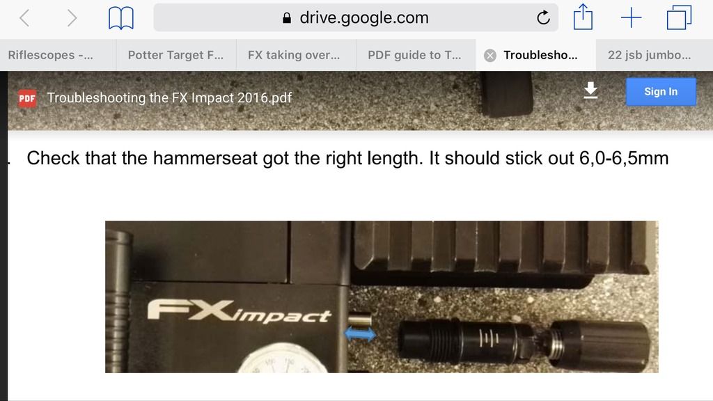

Michael, you might want to check that first before making irreversible modifictions ;) Look in the impact troubleshooting guide for the right gap.
Gijs I checked my power wheel set screw and
measurement. I also replaced the power wheel. All good there. My gut tells me I have a weak Hammer spring. From your info I must have some other issue

Can't wait to see your results! I will remove my spring today. I'm sure other dementions will be the same but length could be interesting.
I will also measure the force required to pull the valve rod forward to the point it would touch the rubber ball in the valve adjuster when it is adjusted out with 4 marks showing.
If someone else who is acheiving good velocity did the same measurement would be great.

Been doing some more measuring. If the valve rod travels forward over 7-7.5mm it can come out of its rear guide/seat. If the front rod measurement in the pic I posted is as recommended 6-6.5mm the valve has a max opening distance of 6mm before it hits the rubber ball in the valve adjusting knob (with max setting 4 strips). Then it can't come out. Mine at 3.5 has a theoretical max distance of 9mm So if the hammer spring was powerful enough it is possible to push the rod so far for it could come right out of the rear seat.
I don't think the stock spring has the power to do that. Well it hasn't on mine luckily.
So no matter what spring is used there is only 6mm
of valve travel.
This has made me think that rather than just tighten the piece on the end of the valve rod maybe it should be adjusted to the 6-6.5mm and this is why it has the grub screw in the end. (That usually falls out)
