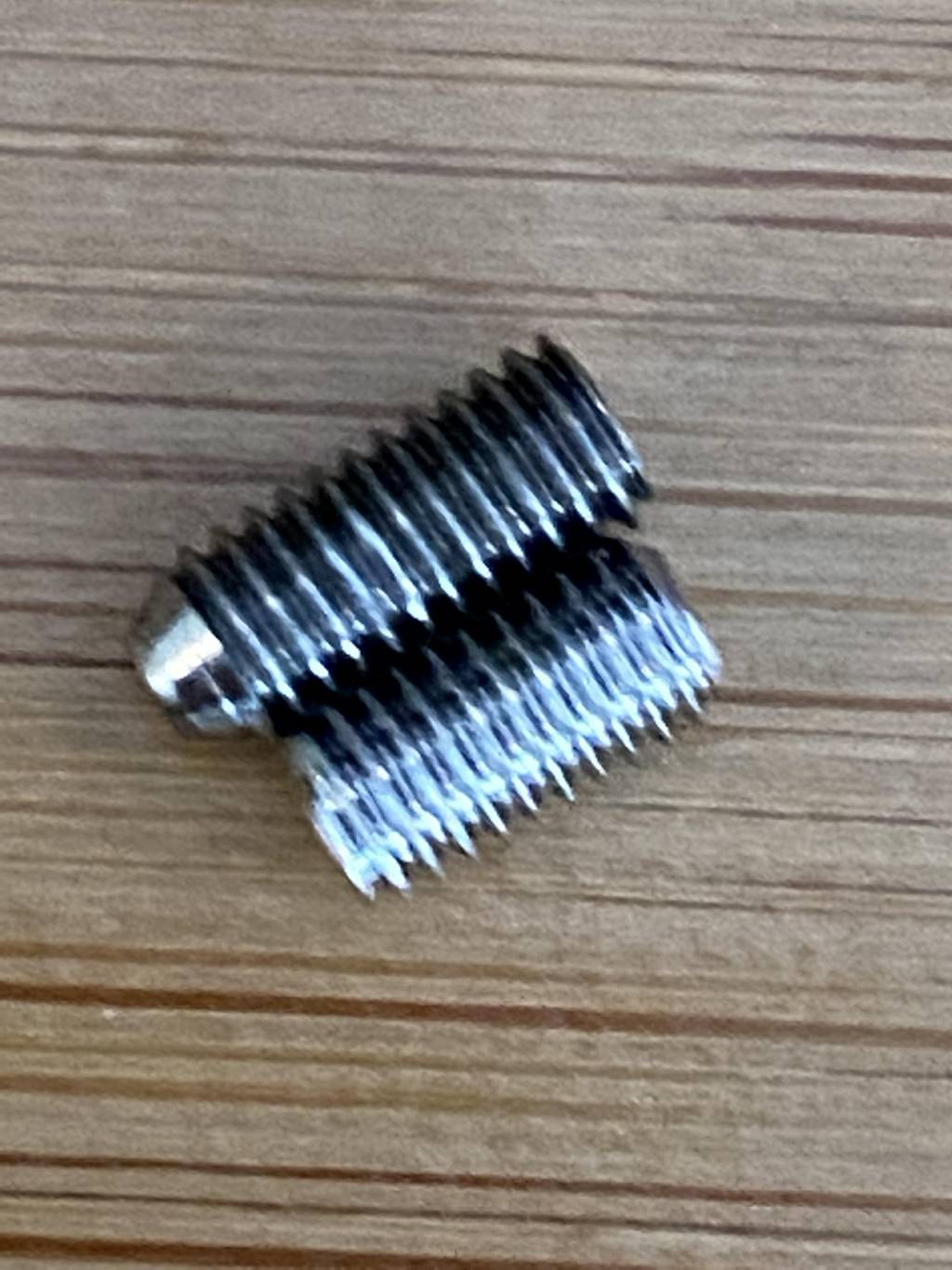

Grub screw, Pellet probe, M4, FX Part #19643
from serial no.191084
Feedingpin screw M4

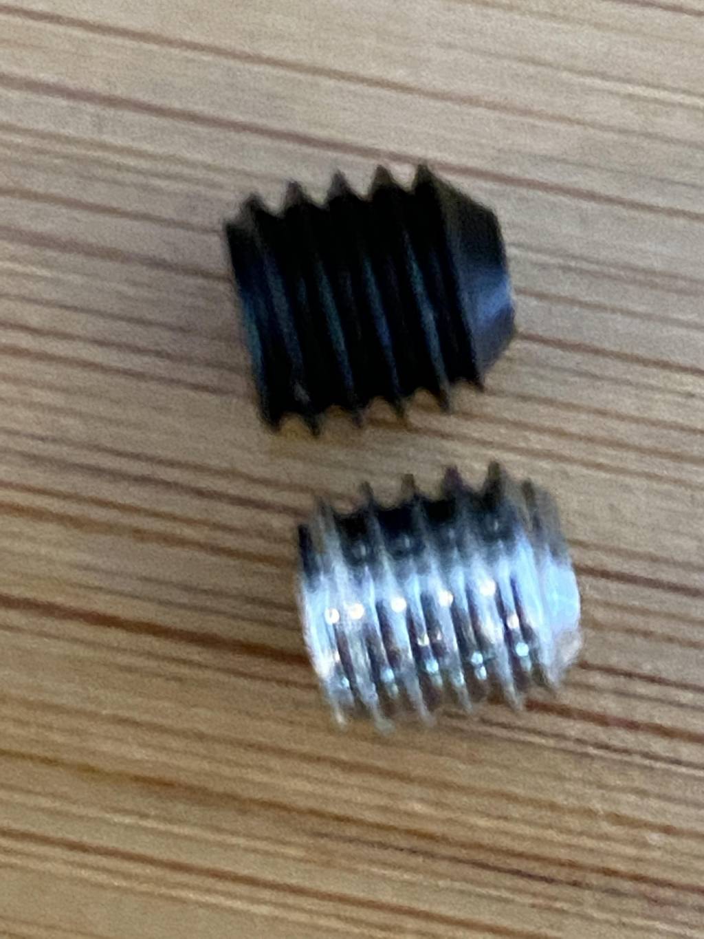

19846 Grubb screw M6x6. Barrel lock screw.
Grub Scruw M6x6
The Stainless 6*6 Barrel Lock screws look pretty close to OEM.
The stock 3*6 Probe Screw is slightly different than off the shelf.
