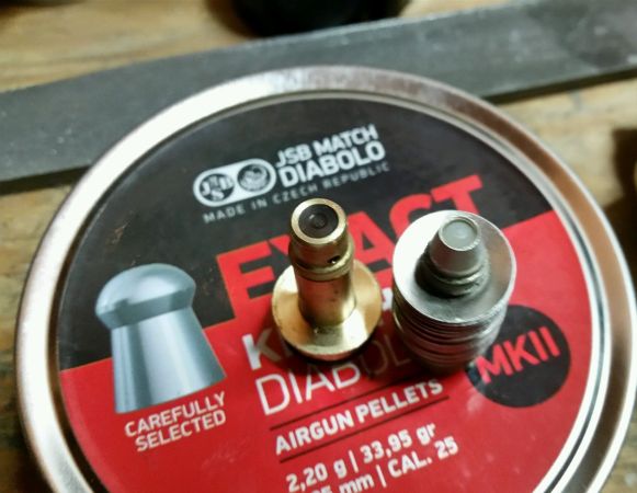

Below pic shows a Ninja piston on right and a chinese piston on left, which due to the seal/design showed horrible creep for me.
So with the new reg adjuster screw on the impact its flat on the tip. It used to be a pointed design. So like you said it prolly wasnt properly seating. I adjusted the gun to a lower pressure with the bottle still pressurized. I think that will have created a seat. We will see how that works. Its not supposed to be done but i did it. Lol i have back up parts just incase.
