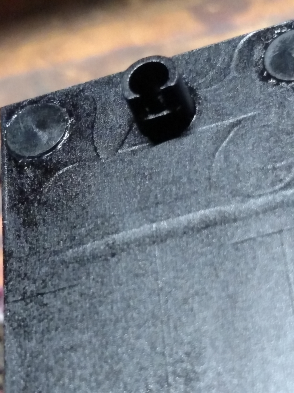

About port misaligned, they were no misaligned, when the cocking block is returned, everything comes in place, only danger was hammer hitting in delrin piece and messing with cocking pin. Problem appeared only when block is stopped in NEW rear position, hammer is cocked with help of a delrin piece but the leaver is not fully back and so the cocking rod and pellet probe.
41mm measured with the cocking lever forward make the ports misaligned by 4mm or more than half it's diameter.
