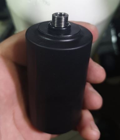

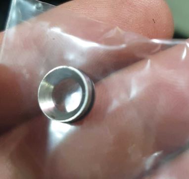

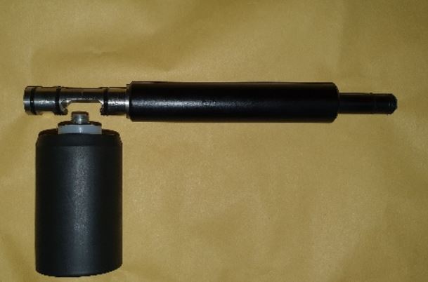

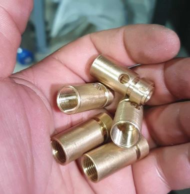

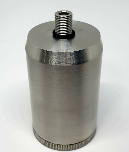

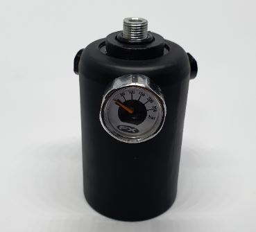

So, after a couple a days I made my first ext plenum of 22cc volume. I cut valve housing and done brass inlet hole mods and pellet probe half-moon shape mod. After a couple a first shots … It was clear to me what I just done and from that moment my madness for upgrading this gun didn’t stopped.

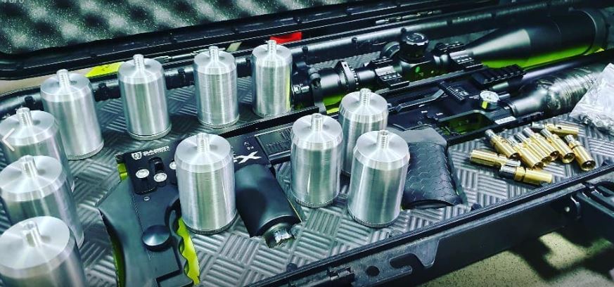

After 22cc I made 30,40,45,50,63,75,and 100cc external plenums combining them with factory plenums of mk1 and mk2. Throe whole design trial process there was mistakes and errors but I believe that was a leering curve to make good design and learn about volume capacity and its influence on adding power or getting best performance out of it.
Also, all the time I was working with Aluminium 7075 that showed good performance. I was experimenting a lot with cc volume and thinking how to make it safe for usage since my head was close to it. So, I have already worked in past on closed hi pressure containers so it was simple … it has to have rounded edges inside.

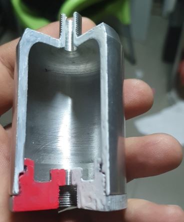

It’s a bit rough cut but you can see inside design.
With sharp 90 degree corners, inside pressure forces due material expansion can make a crack in sharp angle so making it round it will spread pressure in more wide area than corner.
I was also lucky that company who test hi pressure bottles made a test for my new design and put it under 450bar pressure for 12h and then scan for micro cracks inside material. Test was good and no micro cracks observed in ext plenum walls.
So after having such result I stick to this design until today and have no doubt about it.

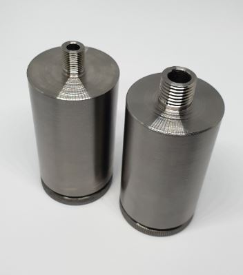

Finlay, I wanted to make something even much safer so I turned to make ext plenums out of Titanium.
We all know how strong titan is and how well it can be machined so now my preferred ext plenums are made of Titanium.
Also due less wall thickness it can be smaller in size making it more compact on gun and with lifetime warranty in any terms for 1/8 BSP and M14 thread top.
Im still sticking with external plenum since its function is so good. Im not 100% sure but I believe that ext plenum from below give some special burst of airflow that travels faster throe valve seat.

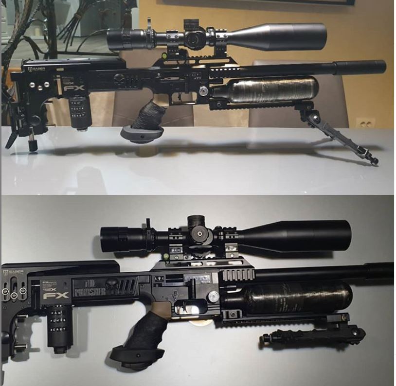

And so on with impressions and pictures of installed parts …
