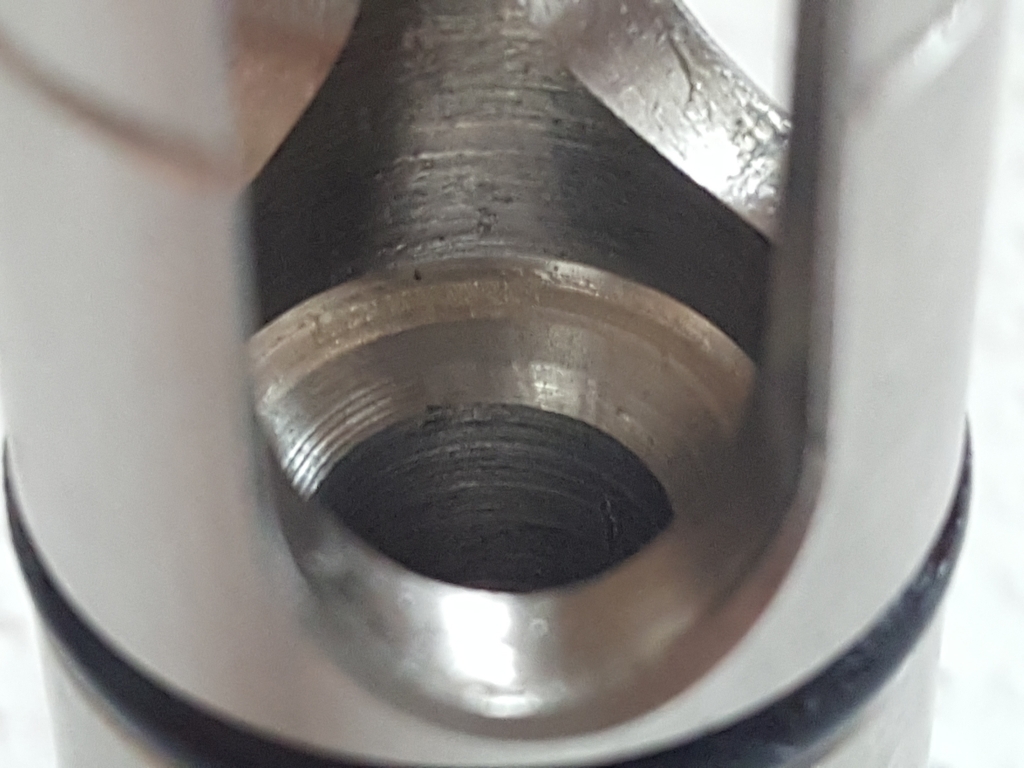

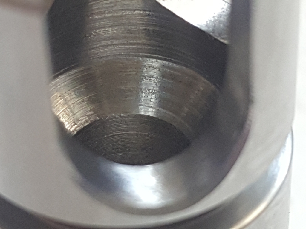

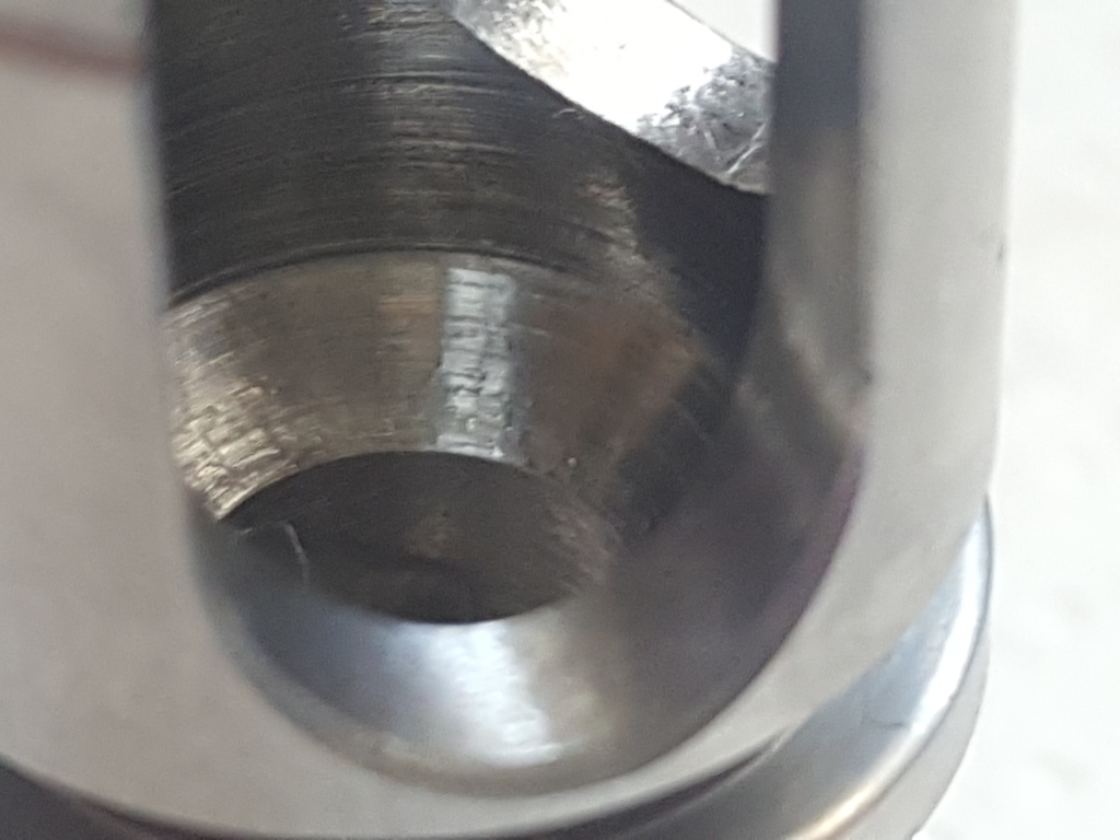

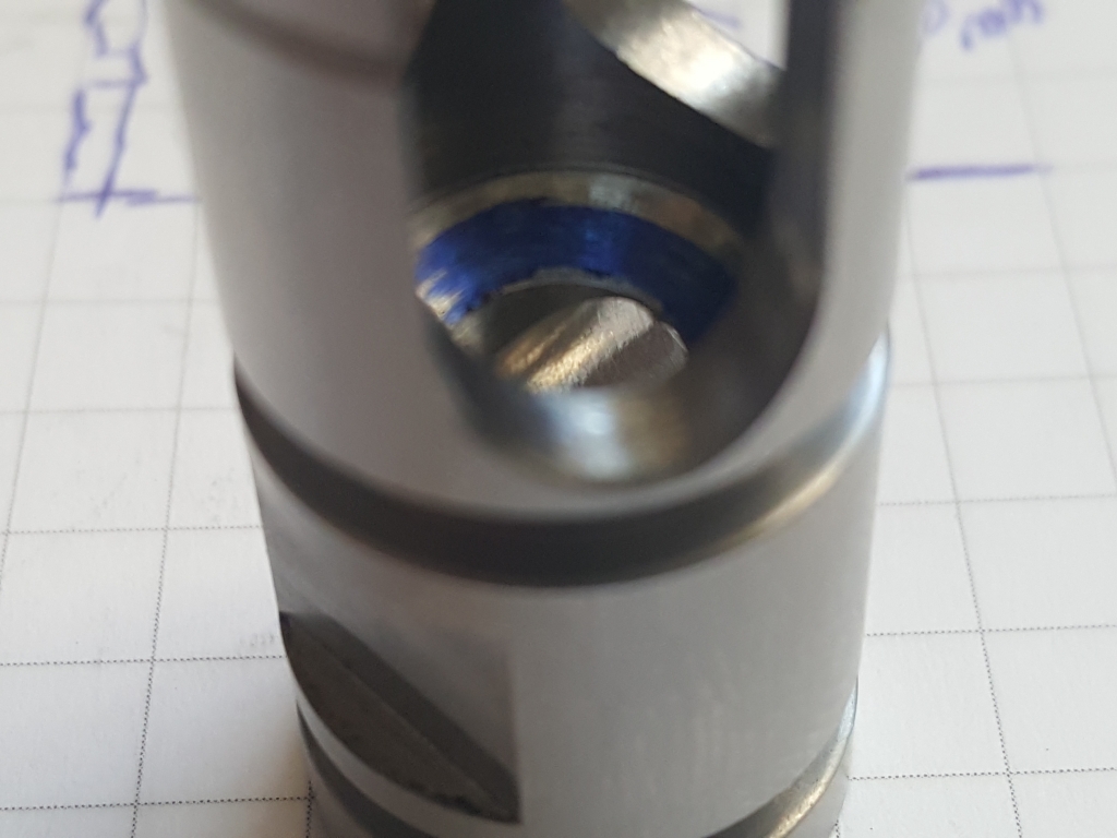

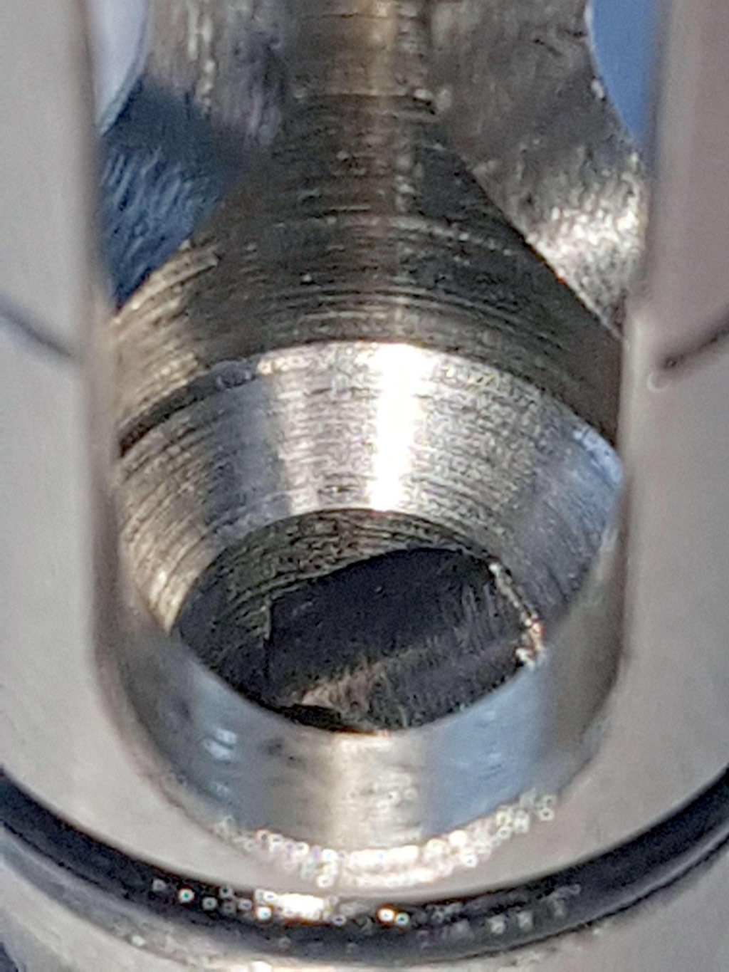

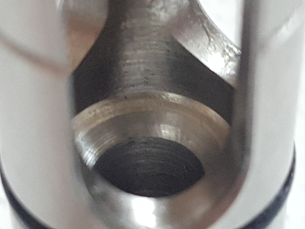

FX impact Power Plenum Seat.

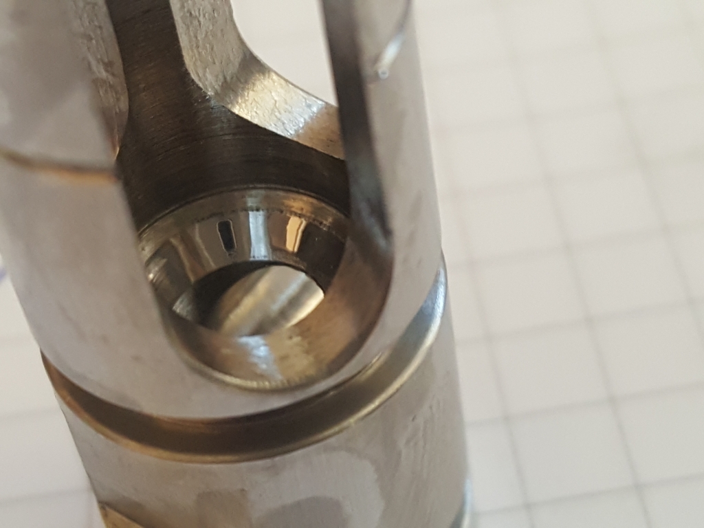

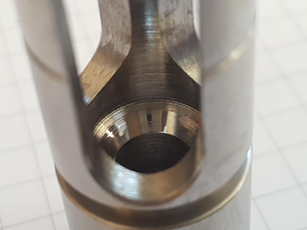

As you think or with such a quality seat,the valve can last a long time?

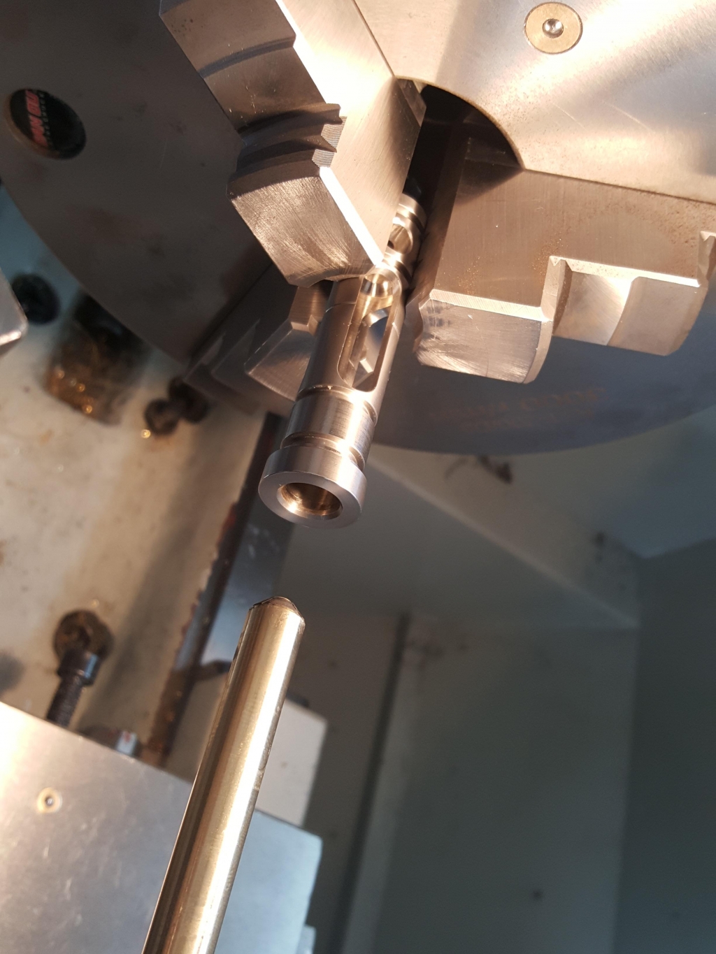

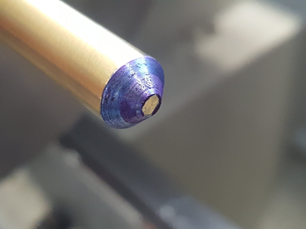

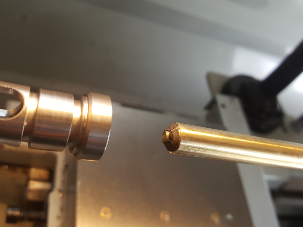

Nice work Vadimas, may I ask what angle your polishing tool is and what is on the end of it. It kind of looks like pieces of sand paper. I have one that I'd like to clean up.
Jking
The angle is 48 °.

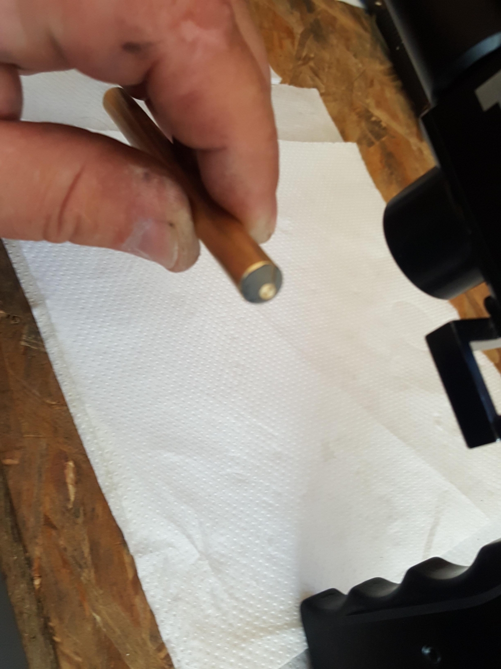

there is glued paper 1200 for wet work
then I glued 2500 paper,it’s a very meticulous job
I used ballistol grease instead of water when polishing, it does not allow the paper to burn quickly.
