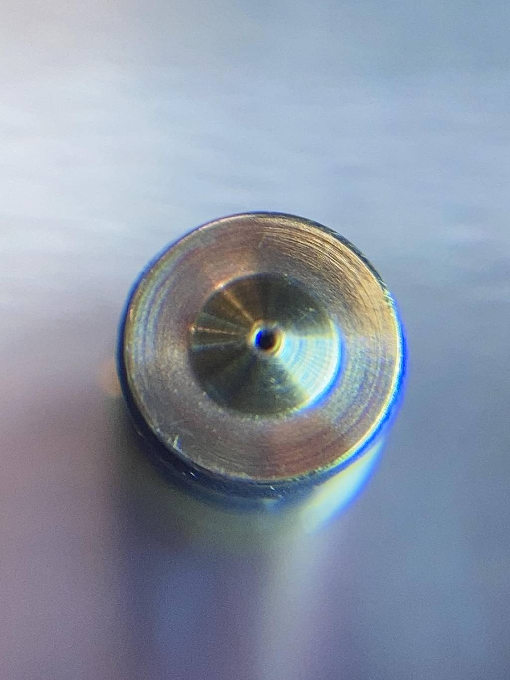

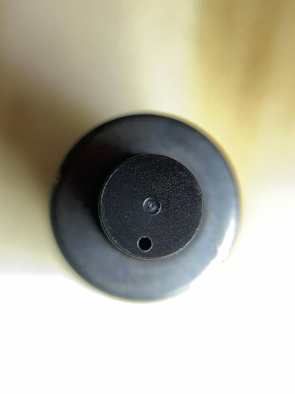

Based on pictures below, are my C34 and C37 in good shape?
Here's C34 / Regulator Rod
Here's C37 / Regulator Screw

Your regulator rod is messed up and should be replaced, if you want your regulator to function properly, it should be flat with no indentation in the middle. You may want to replace the rod and screw also as the newest iteration of the adjustment screws no longer have the point as it damages the rod if adjusted improperly.

Never noticed creeping, only reason I opened up reg was to solve tank dropping to reg setting over night after I installed Power Plenum. Tank only dropped to reg level when reg was set to low pressure, i.e. 90 bar. Once I saw regulator end I figured something was up there also.

Plan is to take two paths, repair old and buy new. Old repair includes polishing down regulator rod, hope rod doesn't become too short.
