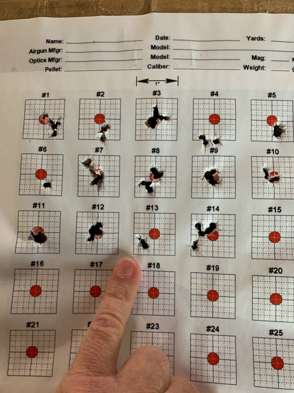

Clean the barrel...if you see a lot of lead fowling (like I did) give the barrel a nice polishing with some diamond paste. I used 5 micron then 3.5, I now have a laser. Cant be sure it will help you but it won't hurt, plus you won't need to clean as often. I was seeing groups all over the place, after cleaning and a little tuning I get this at 50 yards using 18grain JSB's .22
