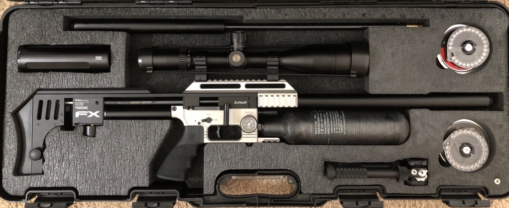

My FX Impact MKII .30cal with 700mm barrel, Bushnell Elite Tactical G2 6-24x50 FFP scope, Atlas bipod, Donny Ronin moderator, Side Shot billet .25 and .30 mag kits and a .25cal barrel kit

That's a case full of the good stuff for sure!
Did you custom cut your foam for the accessories (the Ronin, bipod) or did your FX distributor pack it like that?? Every one I see has different cut-outs.
