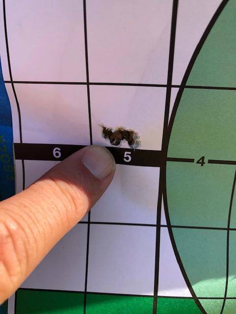

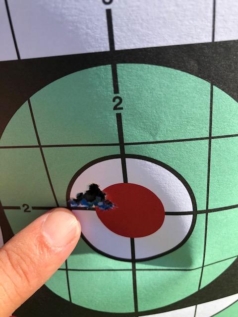

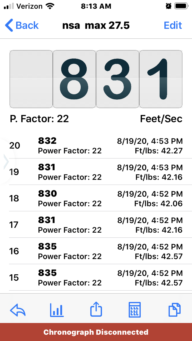

So I got my .217, 27.5 NSA's and shot them through my original liner which is a 700mm superior (standard not heavy) and used my max tune for JSB 18.13's which spits them out at just over 1000fps and does so very accurately... I was not expecting my impact to shoot the 27.5's this well without changing any of the settings. The following are the groups produced while shooting through the chrono, one 12 shot group above the "5" and a 16 shot group near the bull. This is 30 yards. The squares for reference are 1"x1".

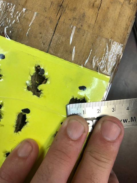

Here is how it performs on the same setting with the JSB 18.13's the i chronographed 5 of them before shooting the nsa's. This target is at 25 yards, a different day, i do not recall how many shots were in each group but i know it was a minimum of 5. I cannot believe how accurate these FX's are.
