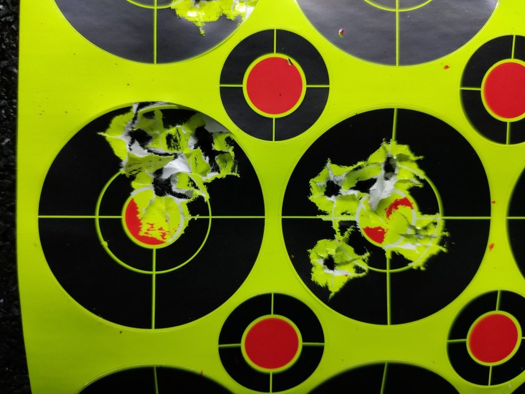

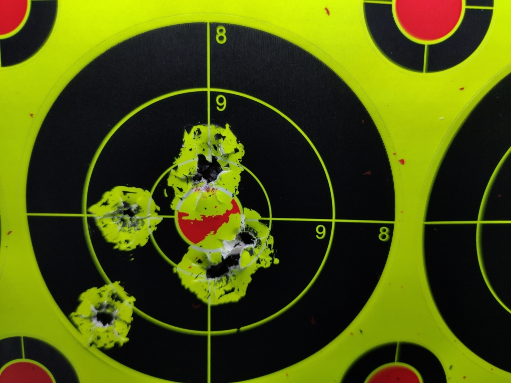

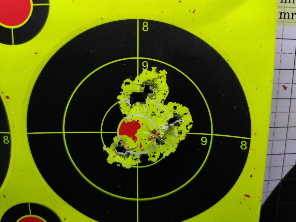

To complete my story, I did'nt want to shoot all my slugs at those ridiculous speeds and decided to keep them for later (when I have solved my power problems). So, I thought it would be a good idea to try to shoot the pellets from the slug liner. First, they fly at the same speed and they hit much lower but I found them to be quite accurate which I didn't expect at all! My 2 targets are respectively at 67 and 100 yards and here are a few pictures of the targets I shot tonight with JSB 50 grains from a slug liner. Cold weather (freezing) and getting dark...
67 yards targets: 5 shots in the first target. In the second one, I pulled my first shot (bottom left), so I shot 5 after that.

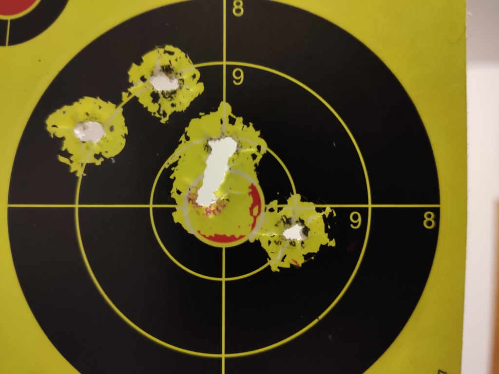

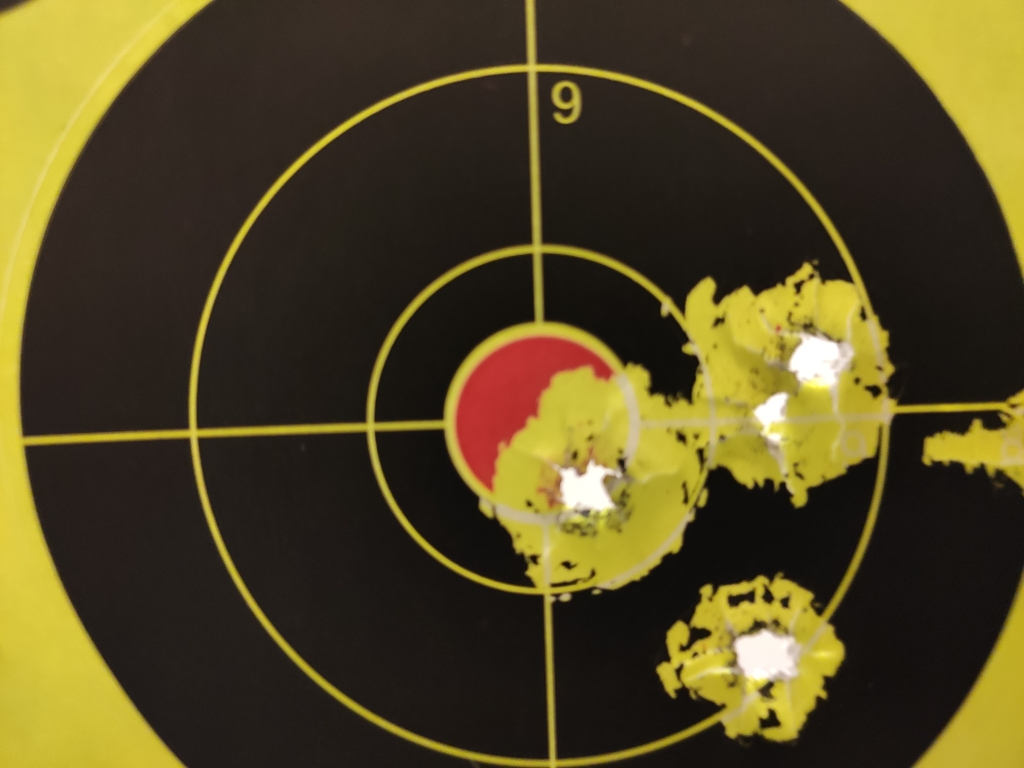

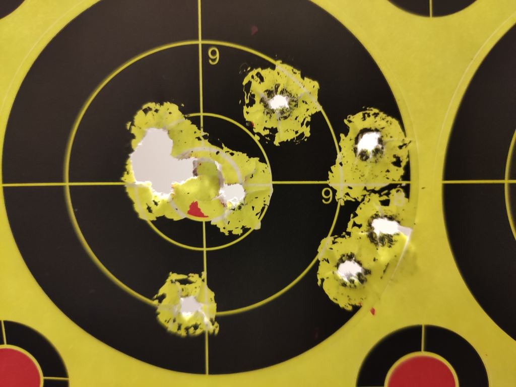

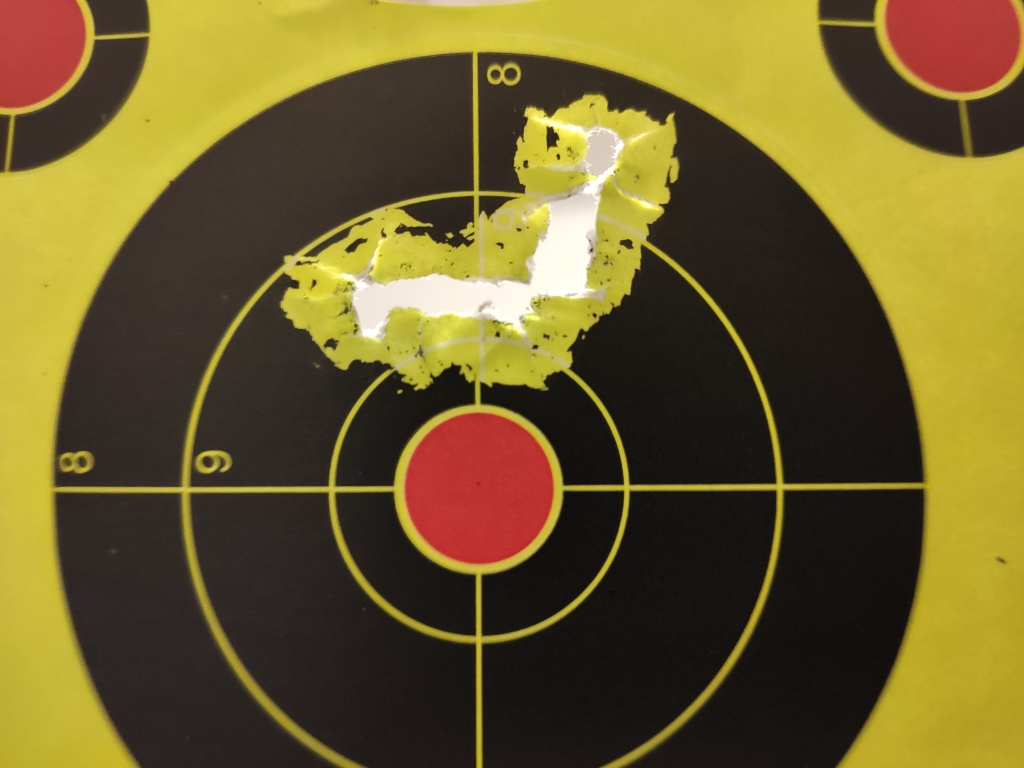

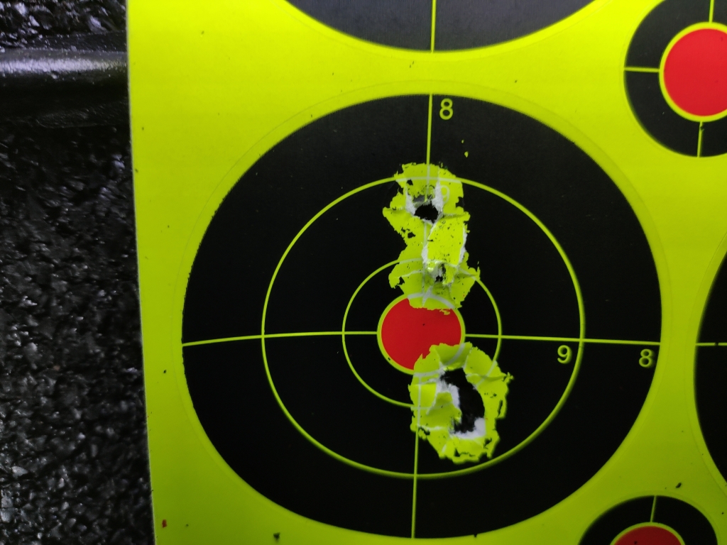

And here are my results at 100 yards: I post them all, not only the best one...
First target at 100 yards: first 4 shots on the right, then one low (don't know why, probably my hold) and then 5 shots dead center!
5-6 shots per target:

Nathaniel, thanks for posting realistic groups. I’m shooting a 25 cal and my results are pretty similar. I’ve seen some groups posted lately that I just do not believe . I think you have to push slugs pretty fast to get your best results . I am pretty new at this stuff but I think you can shoot slugs out of a stock IMPACT MK II in 22 cal fine. When you go to 25 and 30 I think we are going to have to modify the guns significantly to get the velocity up there. My gun is with Ken at SPAW right now for his power tune I’m hoping to get another 100 FPS which should help. Slugs have been a challenge for me.
