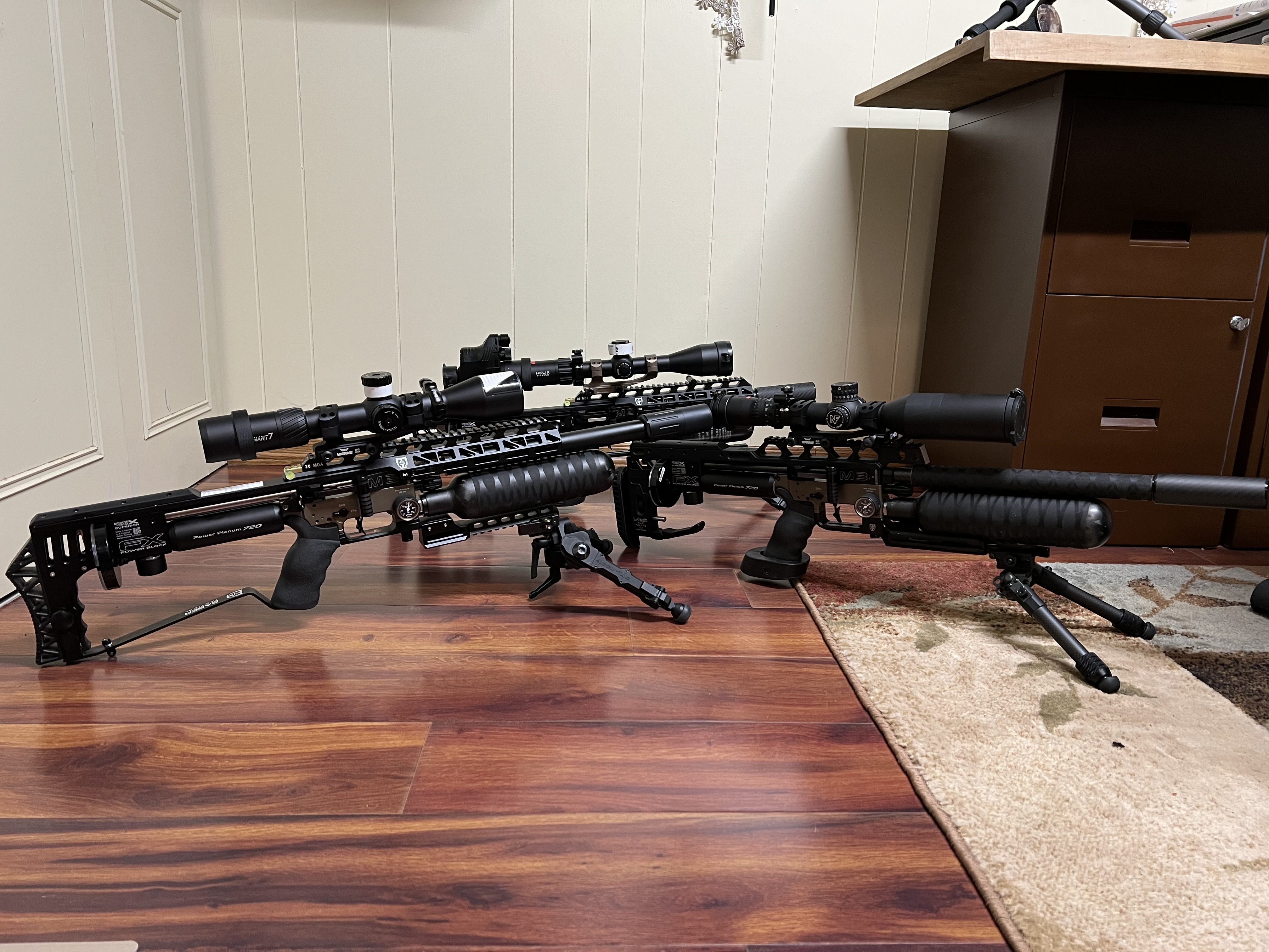

Not quite sure what you’re looking for but here you go. The little guy in the background had a real barrel for him but it didn’t outperform the FX contraption the gun came with. It was about the same but the gun was heavier. So it wound up on a Kral Jumbo I sold my buddy. I hope to try one more barrel on it someday when I can get my hands on what I want. Like I said before, the guns are different with solid steel on them but shooting dwarf bullets is shooting dwarf bullets. It’s actually very tricky to get it right. If I would sell you either of those .25’s, you are only using one slug. If the guy quits selling them, you’re screwed. You may be able to find something else that performs good enough depending on your standards.

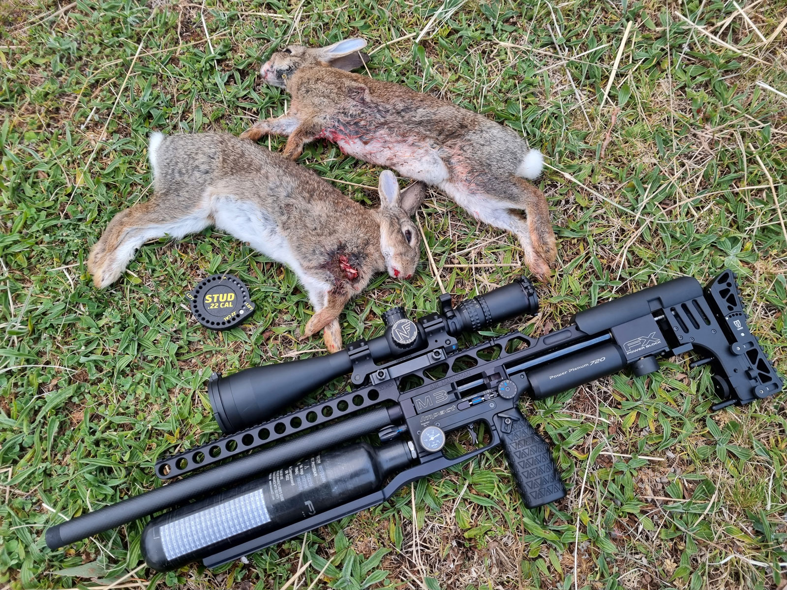

If you noticed, I didn't stand around shooting 5 shots into the air to stabilize the regulators as you apparently did, thus driving the rats below ground, l stabilized the regulators with 5 equivalent head shots.

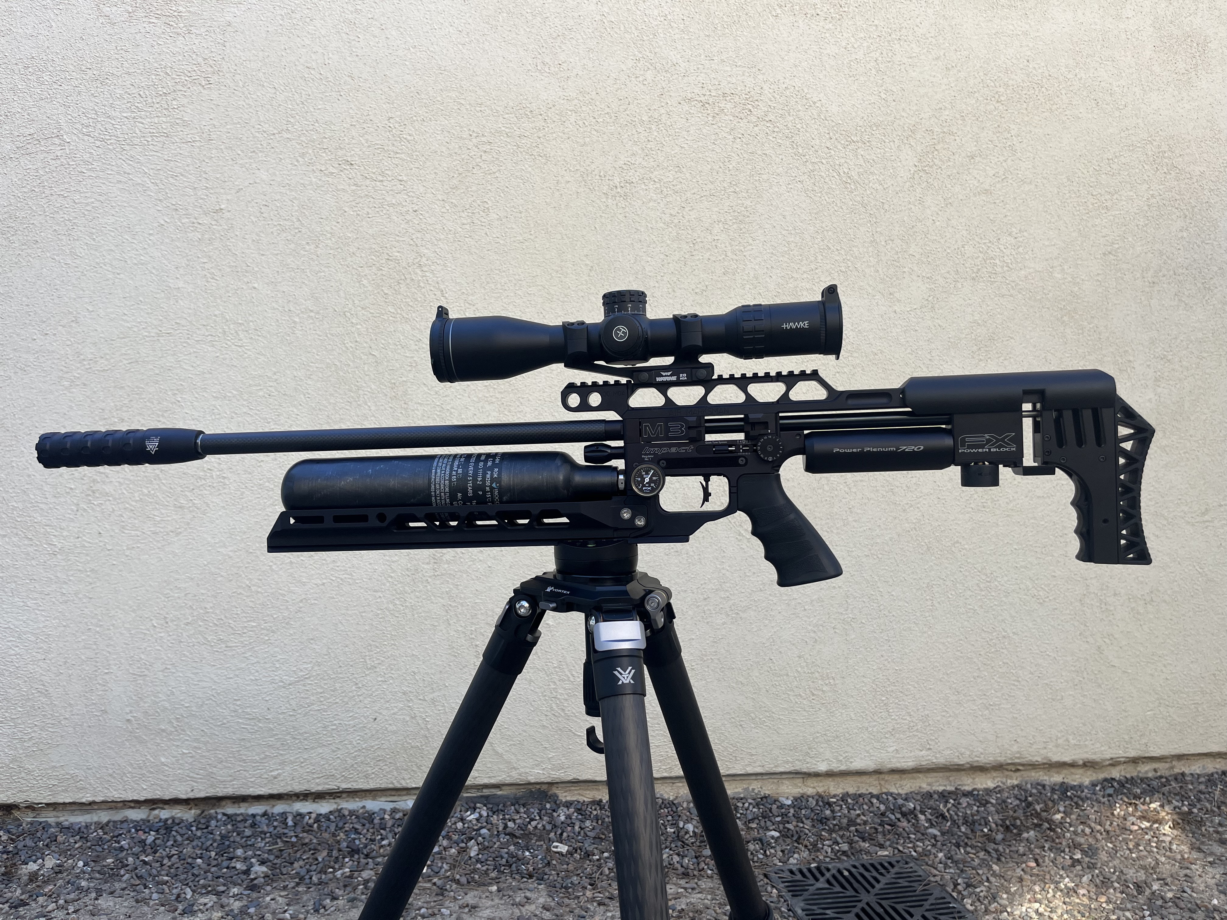

I think the backbone is pretty solid and like that the rail is also part of it. I did the short version.

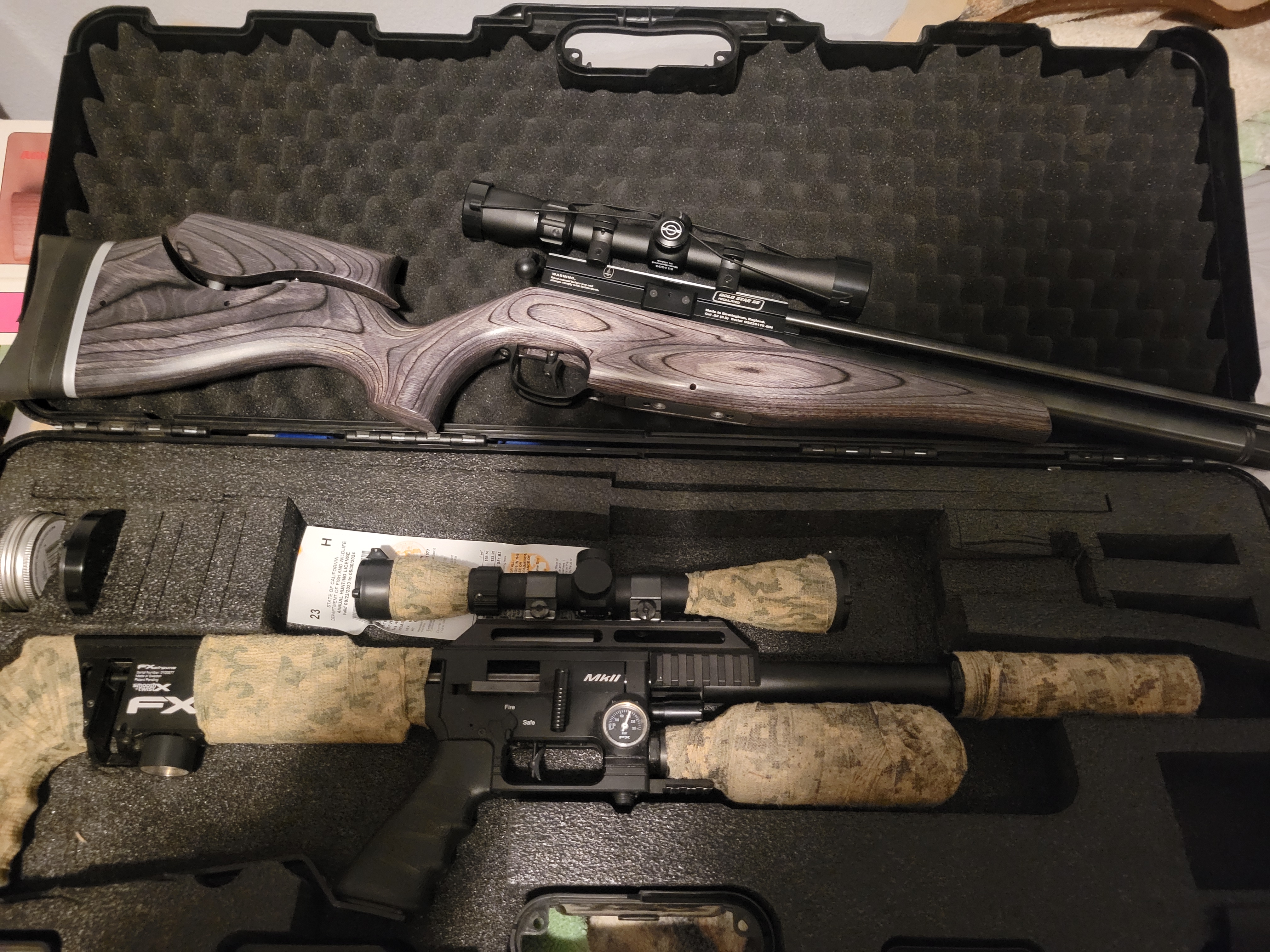

I haven’t shot hybrids so I couldn’t recommend any settings, but I know my MK2 (2019 pre power plenum) had zero issues hitting 950 with .25 jsb pellets. I only know this because I turned the reg valve a little much lol. But out of the box she was 140 bar shooting 860 fps. I don’t really shoot groups but I can tell you she was dead nuts accurate up to 87 yards popping a few tiny birds, both before and after I tuned her for a few extra fps.
