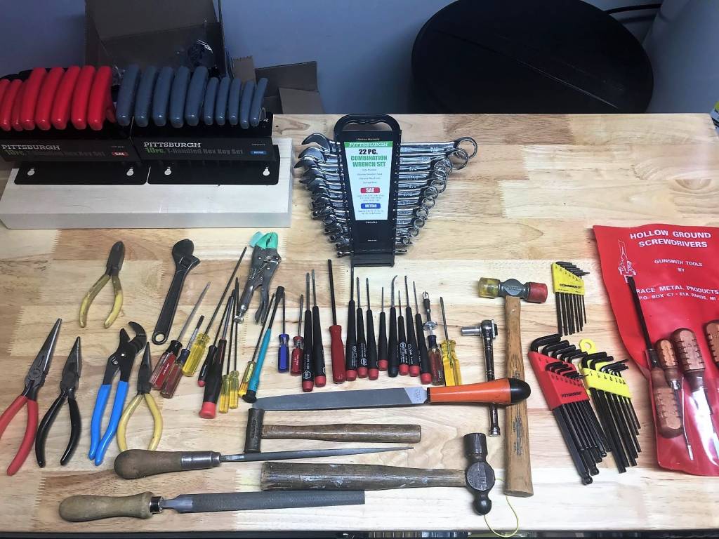

Hopefully I get some advice to this question. Recently I just got my first FX Impact, MK3. Already having warranty issues that I’m not to happy about but I have to replace two things already on it myself and FX is shipping parts. Regardless of what it is on this particular gun, what types of tool kits do most of you guys have for FX guns. Main question is I’m curious if that rifle specifically is all metric hardware I would imagine?
However to a FX newbie, if there is a go to tool kit most guys gravitate towards it would be nice to have some input on.

Start with this.

Please don't buy a cheap set of hex keys. Buy an expensive one. It will save you money. The main reason why people f--k up their bolts are hex keys not fit for the job.
I own a impact and been using this $2 set hex key and no problem at all. If you are stripping the hex bolt on the impact, you probably don't know what you're doing and shouldn't be working on it. Js. It pretty hard to fk up the bolts on the impact.
You may will need a Metrix hex key set ranging from 1.3mm (trigger blade adjustment) 1.5mm (trigger adjustment) to 4mm I believe (back of probe to help remove and rail removal) if anything like the MKII. Also toothless pliers for C1 removal if having to remove the hammer or hammer spring or any valve work. This would also include some blue Loctite to reinstall C1 securely along with a Bic lighter to break the old Loctite loose to remove C1.

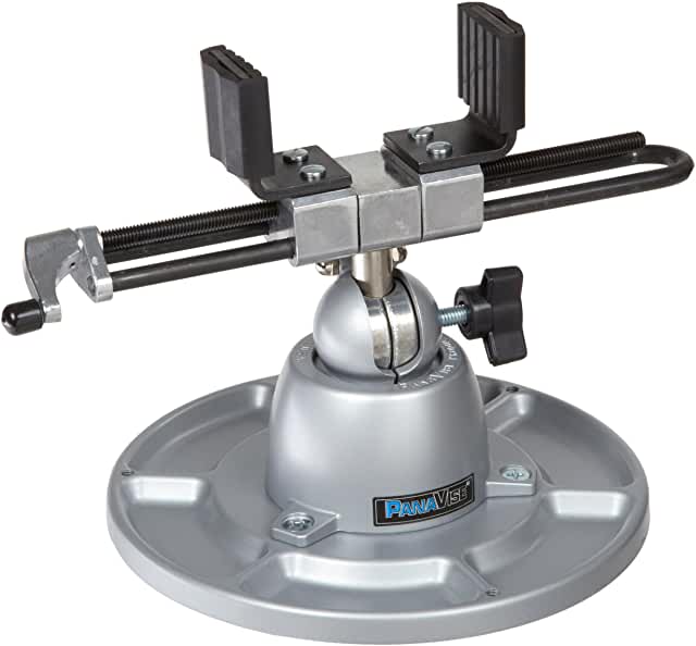

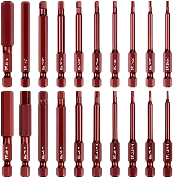

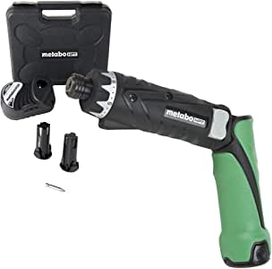

Advanced tools, lol. The table clamp is perfect for working on the FX blocks like when inserting a new valve seat, regulator work, etc. The cordless screwdriver with torque settings gets hardware off fast, and the 2.5” long allen bits in standard and metric add to the touch. I recently added a torx bit set as I’m going to swap out the most removed fasteners on my Impact to stainless torx. That is the top rail plate along with the scope rail.

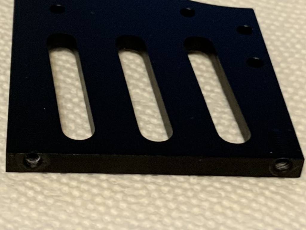

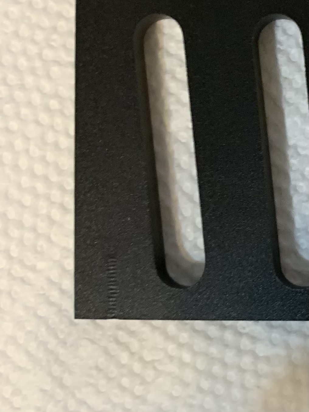

So the part on my new MK3 that was messed up is the right plate on the butt stock. The plate that houses the set screw for the adjustable butt pad. There are two threaded screws that sit underneath the cheek rest. The new plate FX sent out, those two drilled and tapped screw holes appear to be drilled and tapped to the inner most portion of the right plate? Drilled and tapped soooo close to breaking through the material that you can see the imprint of the threads on the inside of the plate? Is this normal that they drill and tap so close to the end of the material for that part? I can send a picture if I’m not being clear enough!
