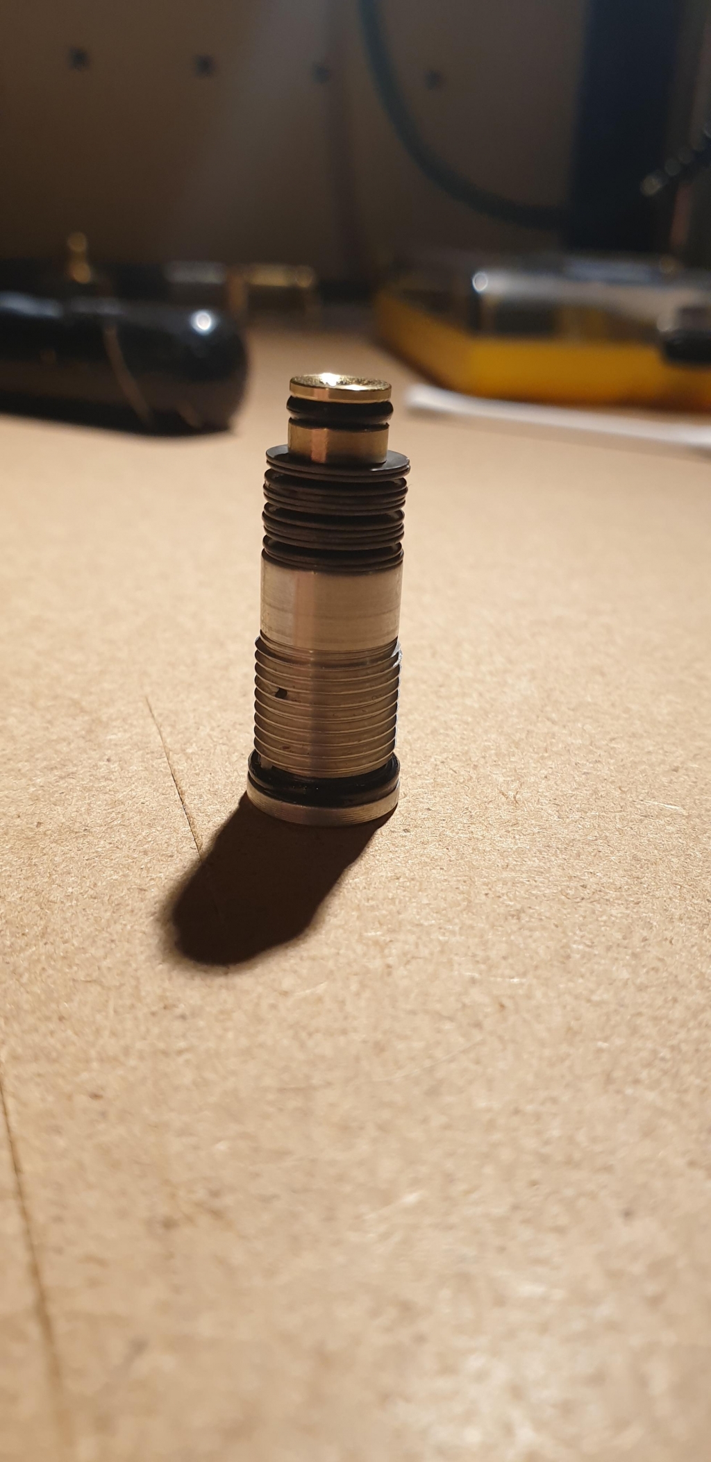

I did put in the reg in as 1 piece, double checked the stacking of the washers. Got it out and put it back in again but still the same problem.
Also tried to loosen the gauge but still got no reading..
Piston and delrin seat looks fine, no damage, scratches or jamming.

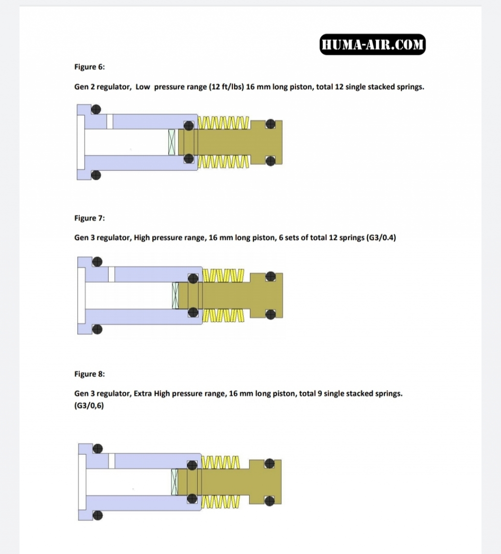

The manual of Huma says to put a bit of sillicon grease on the washers and all the o rings on the reg, so i did. Could a bit to much grease couse the problem?
Strange thing is that when i turn the reg up it sounds like it should and builds up pressure.
The washers are stacked like in this picture, figure 7.

If the new regulator isn’t out of the adjustment range try checking the FX Regulator piston comparing it to the Huma piston. Double make sure they’re the same length. It’s happened to me where I didn’t get the correct regulator. I found the Huma piston was about 1-2mm longer causing a similar issue. If I remember correctly Huma has three different power options for the regulator, maybe try stacking the washers in a different pattern?
