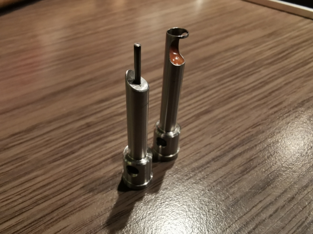

Brand new factory FX Impact MK2 PP, 700 mm barrel in 25 cal, JSB Match Diablo 25 cal 33.95gr, the barrel was cleaned and carnauba waxed, Huma dual port and elongated pellet probe.

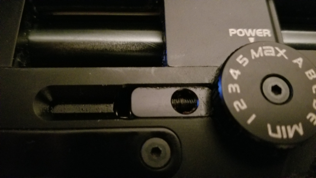

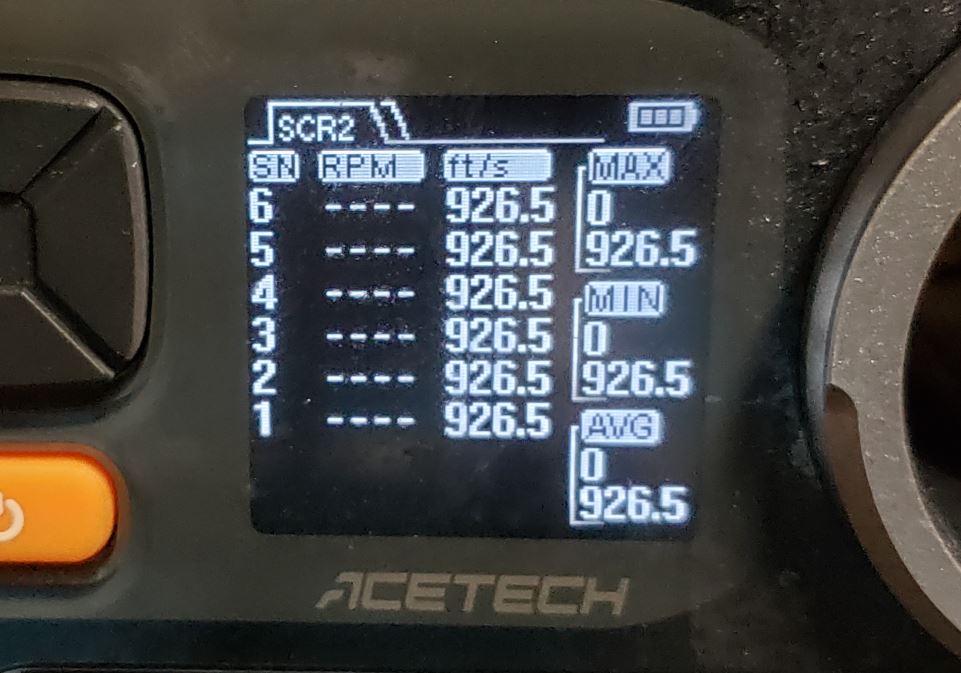

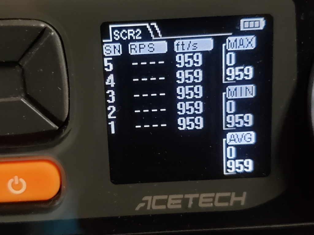

. Started from here:

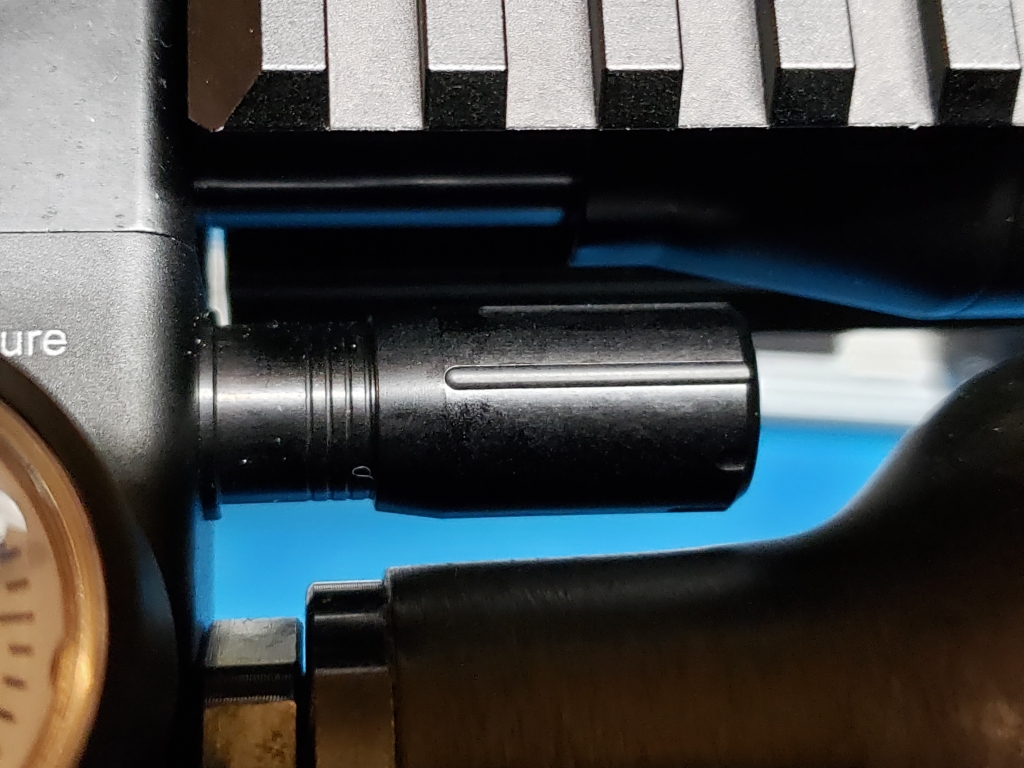

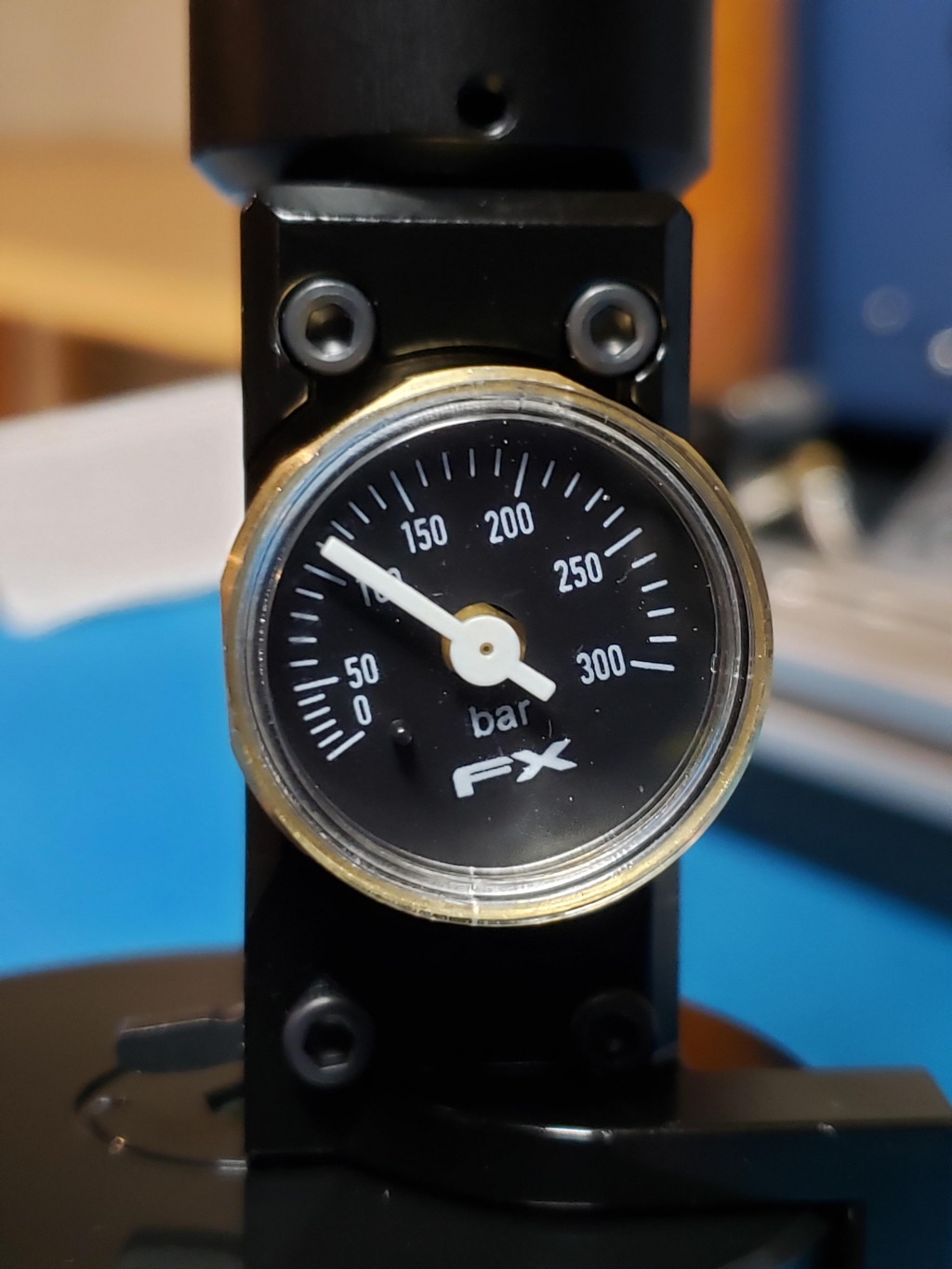

Turned it back all the way to the oring

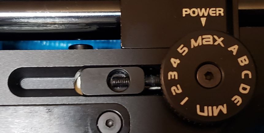

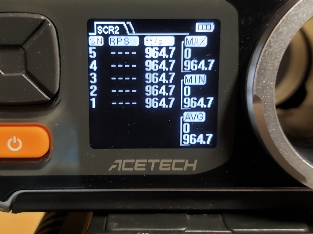

Got here, Power Wheel @ MAX, the Powerwheel slider/setscrew bottomed out (all play removed) but not really pre-loaded, I could still turn the wheel freely.

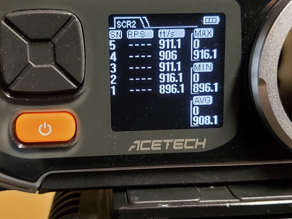

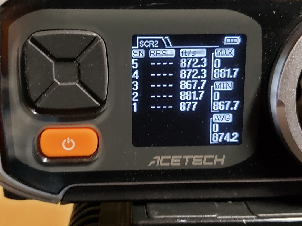

Power Wheel @ 5
Power Wheel @ 4
Power Wheel @ 3
Power Wheel @ 2
Power Wheel @ 1
I wanted just to show the spread within a 5 shot string, which power setting may be more consistent.

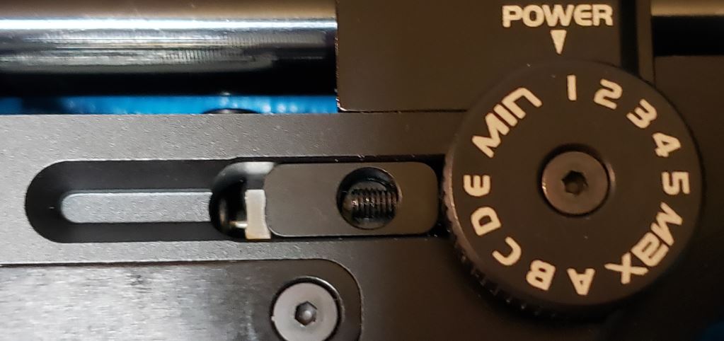

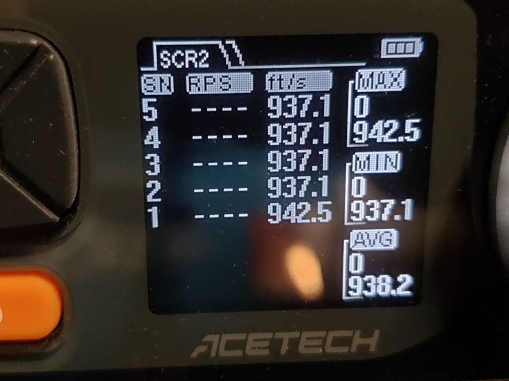

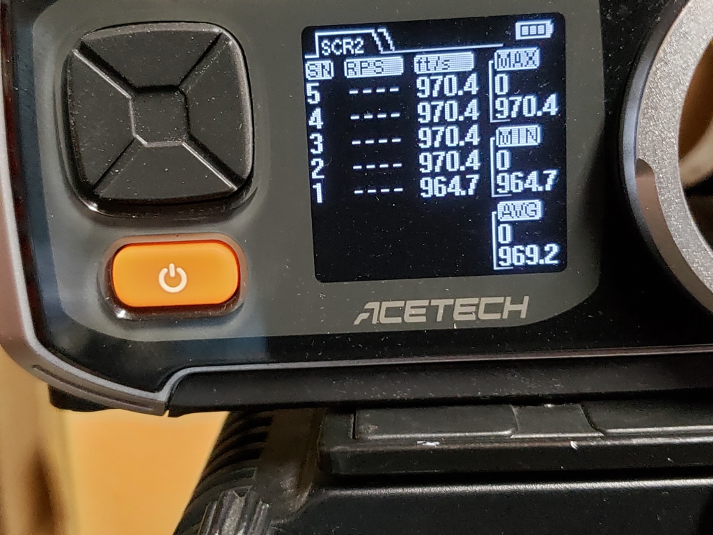

I ended up here:
I believe this shall be good enough for 25 cal slugs, for pellets I my go with #1 or #2 on powerwheel.
Edit:
Higher then this 970 fps I don't think is achievable without replacing the Hammer Spring (which I don't have) or cutting off from the power wheel Slider (which I would never do).

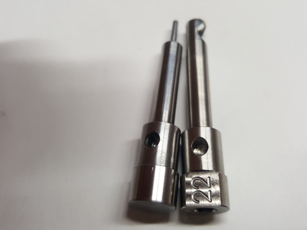

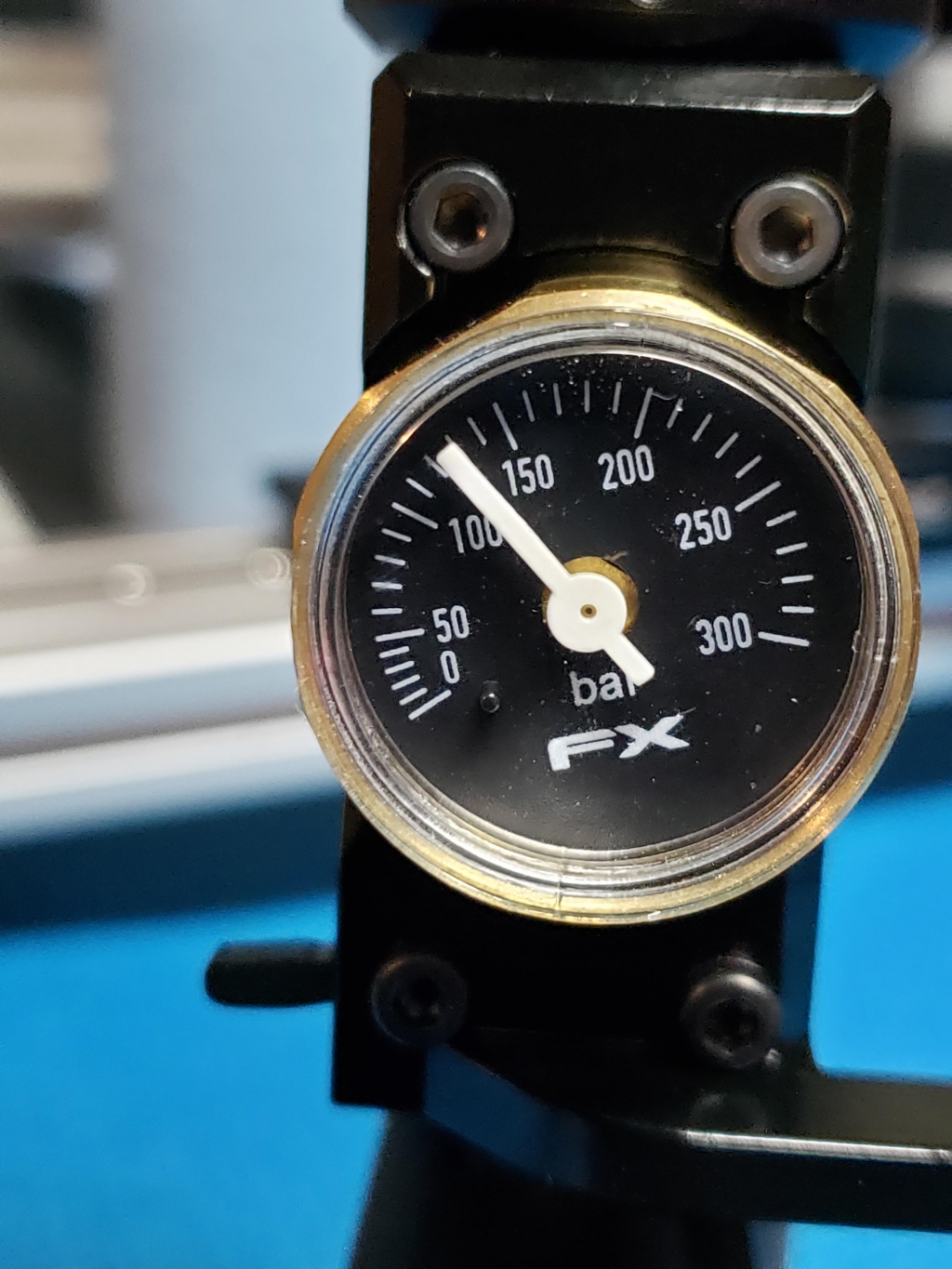

Now, so far I didn't needed to open the gun yet and I don't know what is a factory spring length 57 or 53 mm, or does it have a rubber ball or a spring for dampening/slowing down the hammer bounce, I am just speculating based on the FX pdf schematics/BOM.

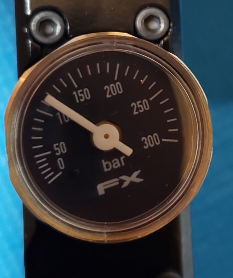

Also speculating how some people could end up at a higher Reg pressure (in example about 145 bar) unless they don't care for balancing the Reg pressure and Hammer spring tension but dampenin the hammer "hit" with the rubber ball. I did not tried that one.For now I don't need more speed but I was focusing more on tightening the deviations (timing and amount of air), but always interested to learn new things.

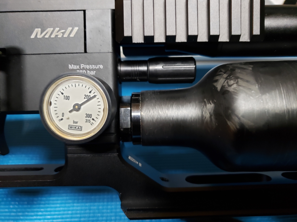

Also I don't have a real life air consumption, safe to stay I can have a third magazin started and still some "juice" remaining in the bottle. In the beginning I was refilling from my external tank but at the point the pressure dropped to 250 bar I left the hose on and I was tethering.
