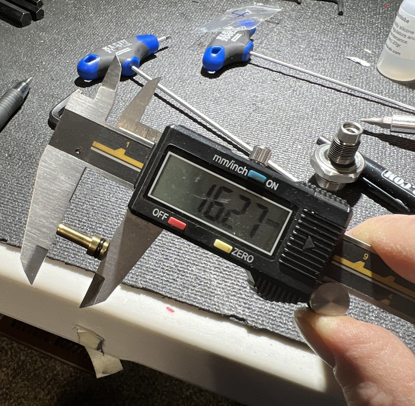

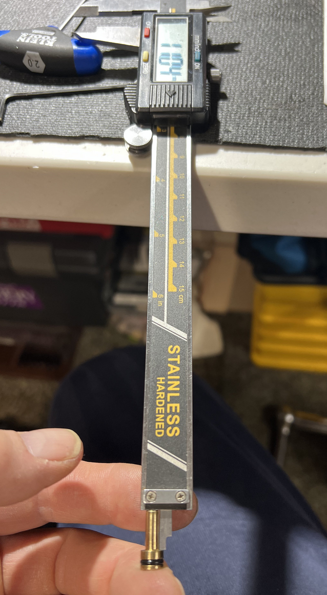

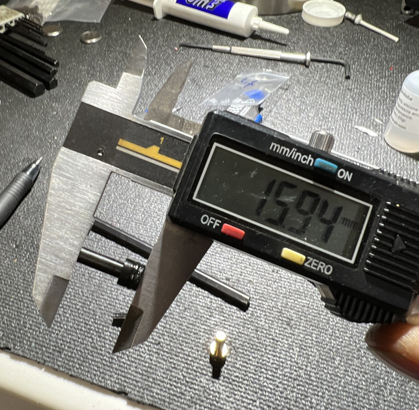

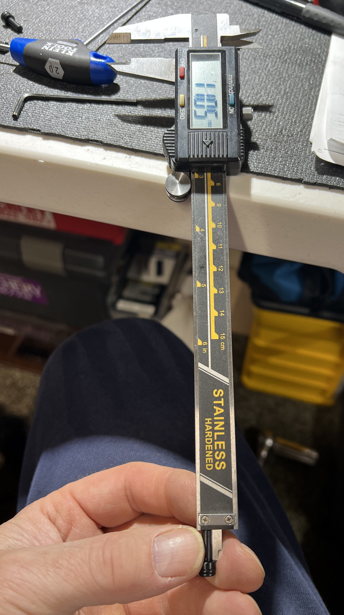

Hi. I immediately contacted Vetmx since I stay 100% behind my products. He is unable to go past 150bars on the bottle reg using a brass piston. The dimensions of the shank are the same as in the original piston (the measurements are taken by Vetmx):
The only difference is in the wall thickness on which the pressure acts on:
This wall is about 0.35mm thicker than the original one:
That was done on purpose to make the piston more robust since that is the wall which the pressure acts on. However, it does not influence the regulation range. In such case I would say the issue may be related to the washer stack.

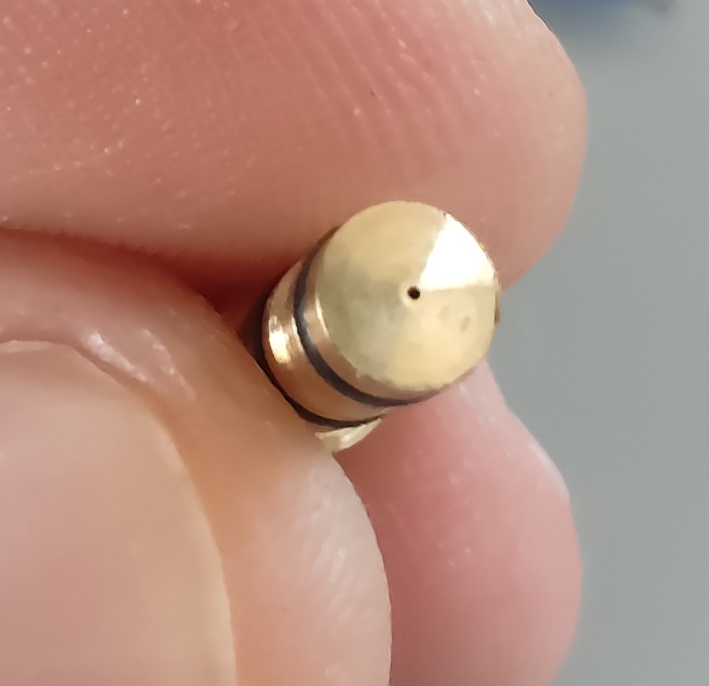

Although the surface quality of delrin seating of my pistons cannot be achieved in any mass production - one still needs to give it some time to break in. The sealing force which acts on the delrin disk is small and the surface quality needs to be as good as possible. Even the sharpest lathe knife cannot give the surface quality which is good enough (I verified it during my testing) hence some polishing with high quality abrasive paper is needed. What is more, when one uses a lathe knife the worst surface quality is in the middle (the most crucial area) due to the lowest cutting speed. My delrin disks are polished with 8000 high quality abrasive paper. That is just one side of the equation though. The second part is the quality of this surface:
I polished this surface with 3M fabric recommended by Ernest and I recommend it as well. My reg creep is virtually non-existing - up to 1 bar. Vetmx, you should cut your creep by 1-2 bars by allowing for some break-in time.
