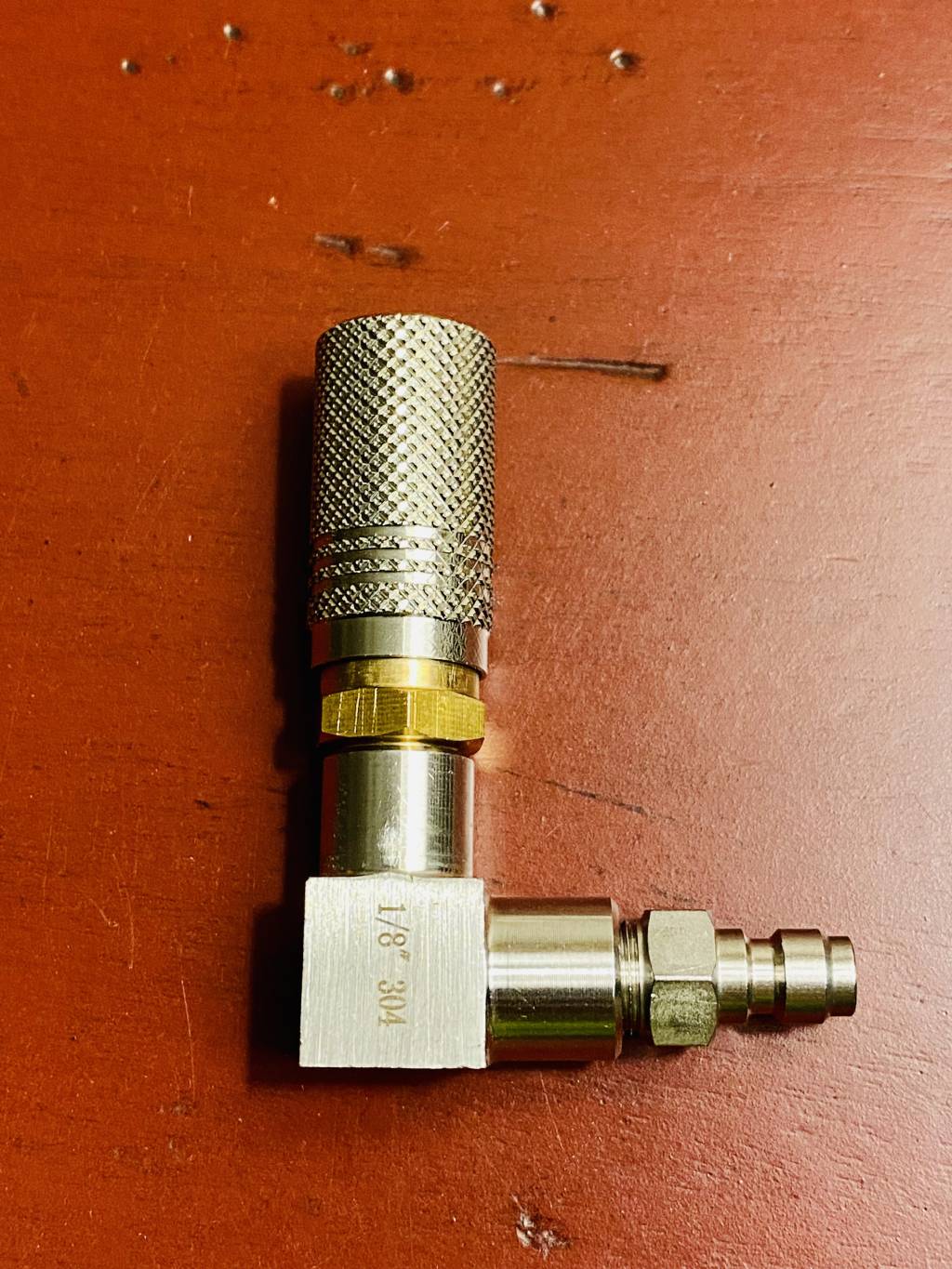

Not sure what caused you to replace male foster fitting on Impact, but suspect might be what I just experienced. My new M3's male foster fitting opening is too narrow, and too recessed, for standard female foster pump fitting. After removing standard fitting, I couldn't get FX female foster, supplied with gun, to seal properly. Ended up ordering $15.50 stainless steel extension fitting on Ebay (free shipping) that will allow use of standard pump female foster. New fitting is male foster on one end, female on other, and is narrow/ long enough to fit M3 opening. Hope this helps, if not, might help others. Best to you and yours,

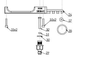

Figure I will just buy a new one, but can't seem to find one that matches the FX OEM ones.
You may want to call FX USA, looking at the MKI schematic at https://fxairguns-usa.com/available-parts/ this fitting either holds the backvalve in place or is a part of it. 29-Quick Connector, 30-O'ring, 31-O'Ring, 32-backvalve.
