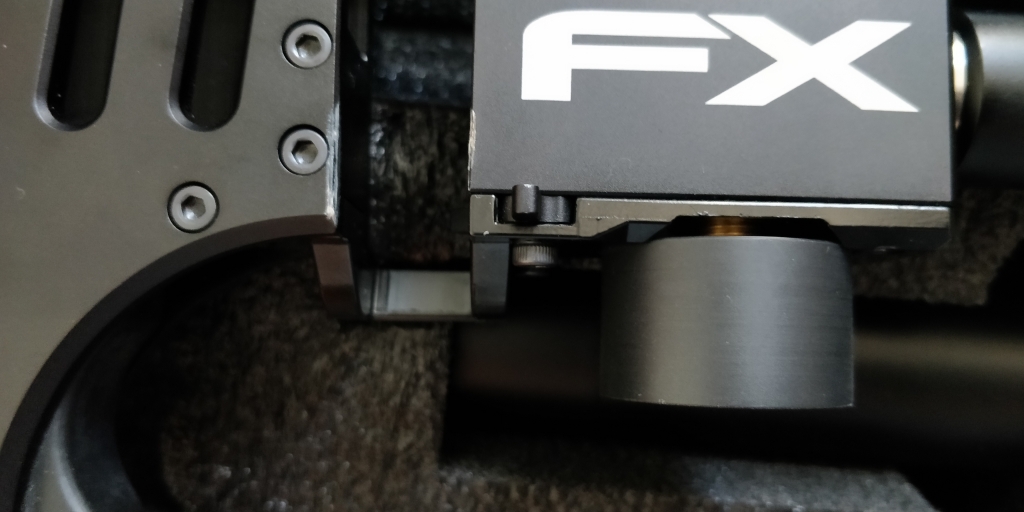

FX Impact Magazine Takes Too Much Force To Fit
This is the ticket

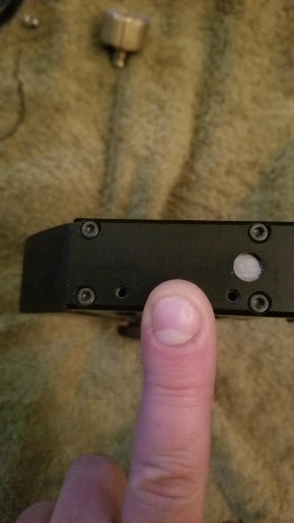

You can degas. Remove bottle slowly, reg gauge slowly etc.
Then just loosen these top 4 screws.
Then loosen these 4 under reg gauge.
Then slide your mag in (to get a feel for how tight it'll be) and gently apply some pressure back towards the butt pad by gently pulling the butt pad get it how you like, snug up the bottom screws then do the same to the top 4 screws that should give plenty of clearance in the mag well if its too loose for you do vice versa. Afterwards make sure all the 2.5mm head screws are tight. Doesnt need much to be tight. Tighten and align the reg gauge (doesn't need to be bottomed out), then slowly screw the bottle back on.

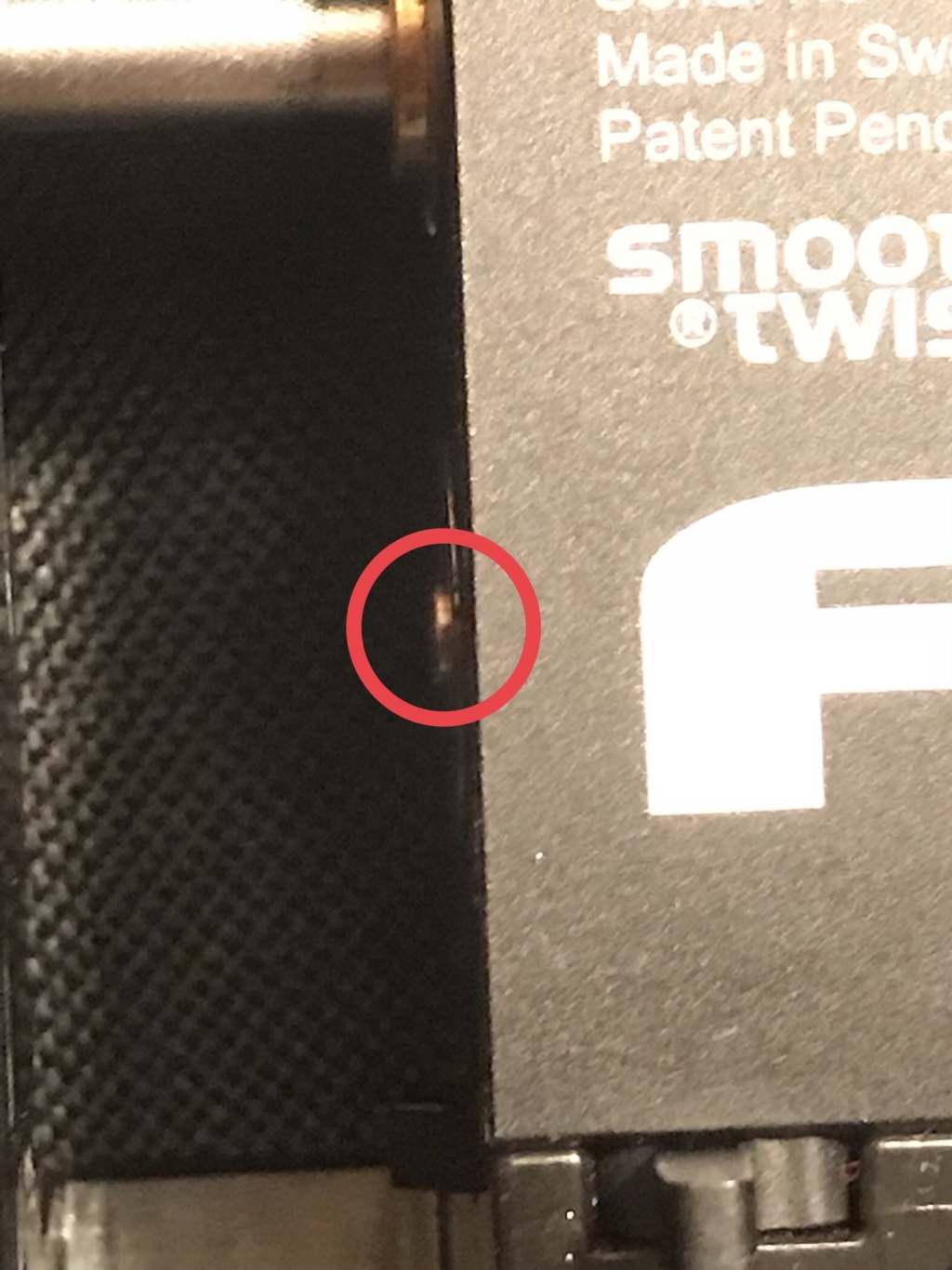

The magazine frame dimensions (width) depends what position its in when screws are set. If you do what i posted in the last post by me it'll work. Just need a 2.5mm hex. Maybe it took a bit of a hit on the buttpad and tweaked it forward causing the magazine to bind.
