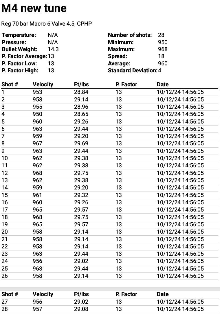

i came across a thread when i was researching this subject last night and decided to re-tune my new M4.
I've tested a few combination of settings, I ended up dropping the reg down to 70 bar, increased the Macro wheel to 6, opened up the valve to about 4.5 line , and able to maintain the same velocity as the default 100 bar reg, Macro 3, and Valve line 4. After leaving the gun overnight, the discrepancy from the first few shots seems to be so much better now.
This is the first magazine run of the day, much tighter spread and first 2 shots isn't too far off from where i had it tuned. Usually i would get 890 to 900fps in the first few shots after the gun sat overnight before it normalized back to around 950fps, the new tune seems to have mitigated the slow first shot symptom, i think it would get a bit better after a few more mags for the valve, HS, and reg to stabilize more. Here's the ProChrono DLX Chronograph reading:
Can't speak for the older M3 or someone else but at least in my case with this new M4, the slow first few shots seems to had been tuning related, the stock tune is no bueno. I would re-tune again if and when i need to up the power to propel much heavier slugs to find the balance again.
The CPHPs give me a higher SD than jsb , jts , AEAs ect . I would try some different pellets .

i haven't need to turn up hammer for first shot, the symptom isn't there anymore after i adjusted the tuning, but certainly am curious to see what it is and the process to install one if needed.

I wonder if the symptom mostly occurred at certain reg pressure range, like when it's close to 150 bar?
At least in my situation, the symptoms is gone after i re-tuned it with reg at 70 bar at the power range i'm using it for pellets.

No, i had to dial down the micro wheel a few clicks to drop it down from the initial 960s to 940s. Today i dialed it down even further! closer to 900, the beginning when the bottle is full at 250 bar is giving me very similar velocity as when i ran it down to 70 bar, closer to 900fps the whole way through for the CPHP.
