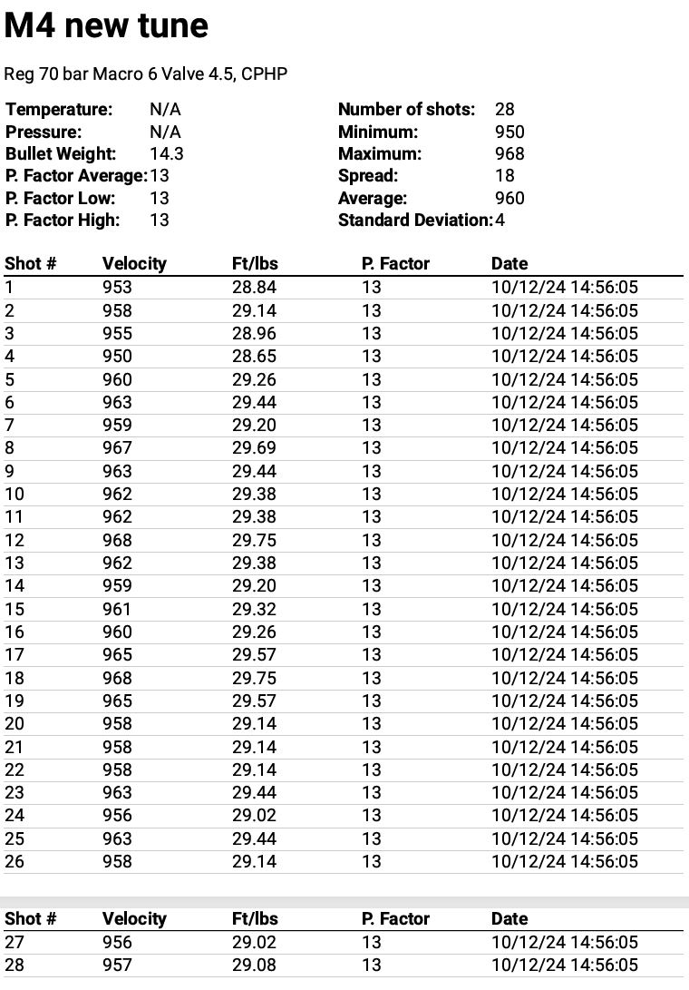

i came across a thread when i was researching this subject last night and decided to re-tune my new M4.
I've tested a few combination of settings, I ended up dropping the reg down to 70 bar, increased the Macro wheel to 6, opened up the valve to about 4.5 line , and able to maintain the same velocity as the default 100 bar reg, Macro 3, and Valve line 4. After leaving the gun overnight, the discrepancy from the first few shots seems to be so much better now.
This is the first magazine run of the day, much tighter spread and first 2 shots isn't too far off from where i had it tuned. Usually i would get 890 to 900fps in the first few shots after the gun sat overnight before it normalized back to around 950fps, the new tune seems to have mitigated the slow first shot symptom, i think it would get a bit better after a few more mags for the valve, HS, and reg to stabilize more. Here's the ProChrono DLX Chronograph reading:
Can't speak for the older M3 or someone else but at least in my case with this new M4, the slow first few shots seems to had been tuning related, the stock tune is no bueno. I would re-tune again if and when i need to up the power to propel much heavier slugs to find the balance again.

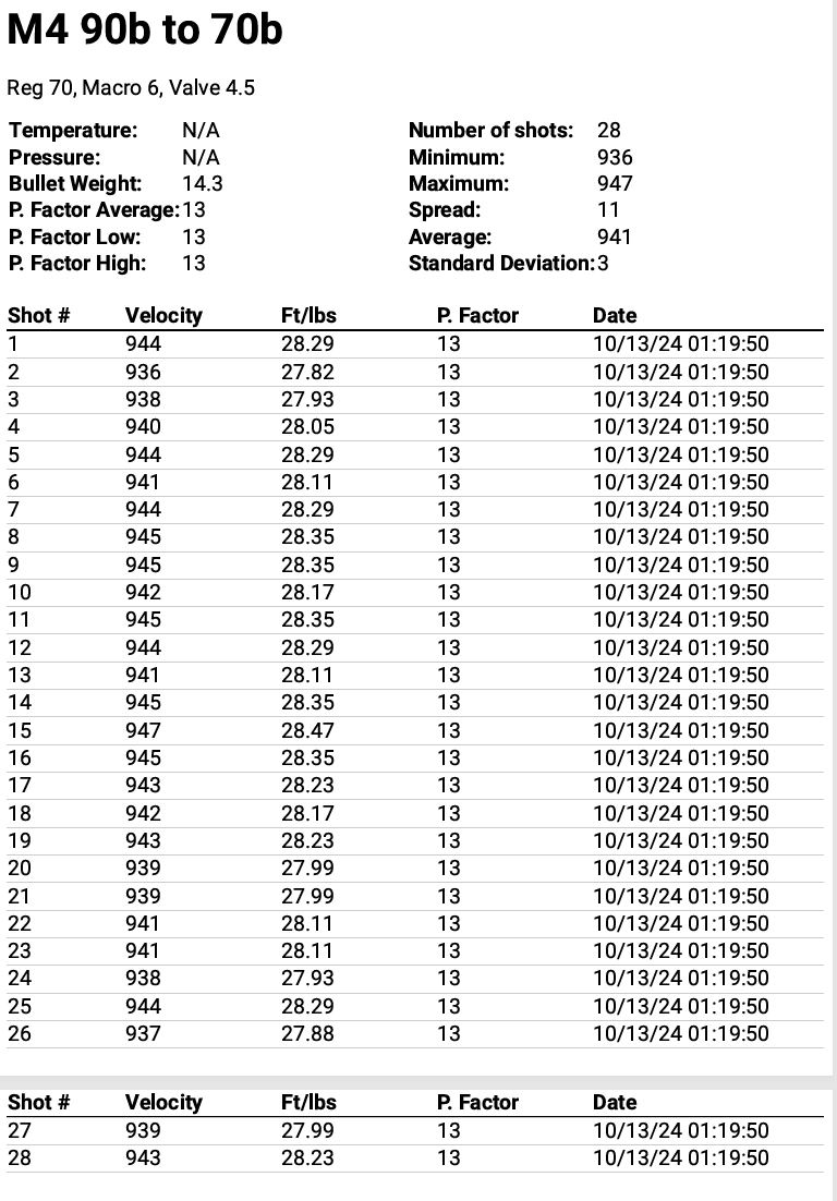

I’m curious about something. The next time your gun is at 90b in the tank, do another shot string until you hit your 70b reg setting. We can run what I call full throttle tunes with our M3’s because we have two regs. I would like to see if a M4 can do it. When I tried it with my single reg MKll’s, the guns only shot slugs well in a certain pressure window. Another thing you’ll need to know. If you are going to use your valve knob to trick the valve lift into thinking you’re using less hammer spring tension, keep an eye on the rubber balls in the valve knob. As you smash them flat, things change. Velocity goes up. If you are doing an extended shooting session and notice your velocity rising, you are abusing those rubber balls. Not good.
Reactions: Xcaliber
Sure, you mean when the bottle pressure get down to 90 bar, record the shot string run down to 70 bar? to see what the velocity look like within that 20 bar range before it drop off of the reg?
Yes. And thank you. It’s all part of a PCP education.
This is the shot string, things seems to stabilized a lot more after it burned through about 7 mags worth of pellets since this afternoon, getting tighter ES and SD, which isn't too shabby. I get 1 mag worth of shots going from 90 bar down to 70 bar on this 480cc stock bottle, velocity looks stable, nothing look out of the norm other than i'm running it a bit hot with an average of 941 fps with these CPHP pellets, pretty much the cheapie stuff for breaking in and stabilize the tuning.
Another tiny educational tip: The micro HST value is the one to reference and document. The macro simply jogs the micro by several clicks, serving to allow presets for different speeds/ammo for fast and repeatable switching.
Your average speed when your bottle is full is 960fps. Your average speed when your bottle is not in its upper range is 940fps. That might not work when you switch to slugs. A 20fps swing is a decent harmonic swing. I just noticed your posting about your macro. Macro is irrelevant, the micro is the one you need to keep track of for your notes.
