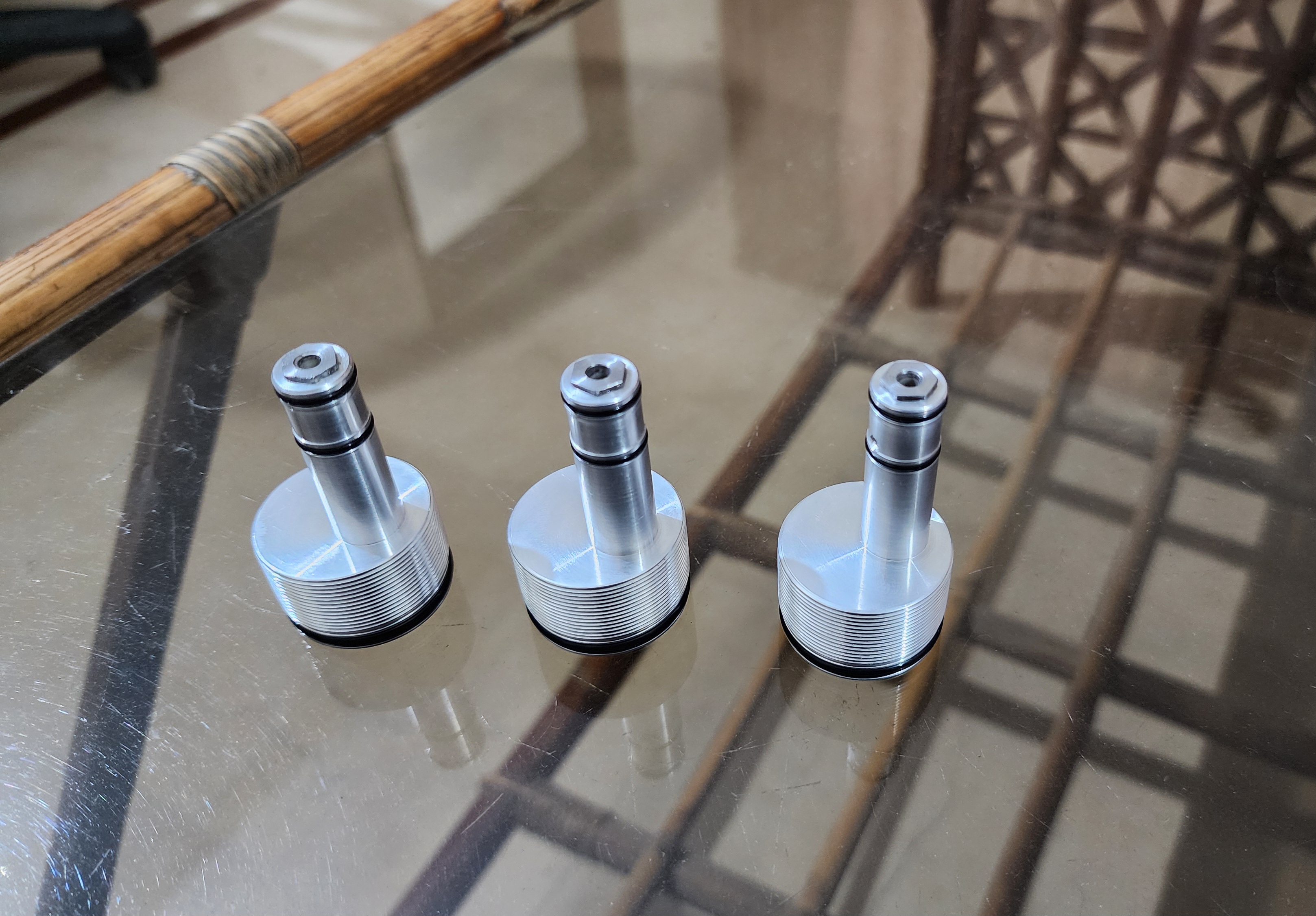

I dispatched following parts to Croatia, US and UK to fix slow shots problem in M3 and M4. My personal M3 is also fine since I installed this part. So far every friend using it has no complaints. YouTube video is also available.

Can vouch this. My impact is cured now.

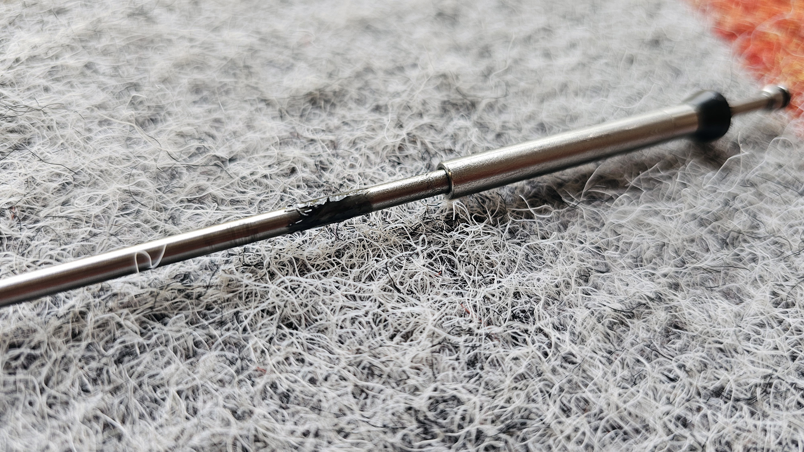

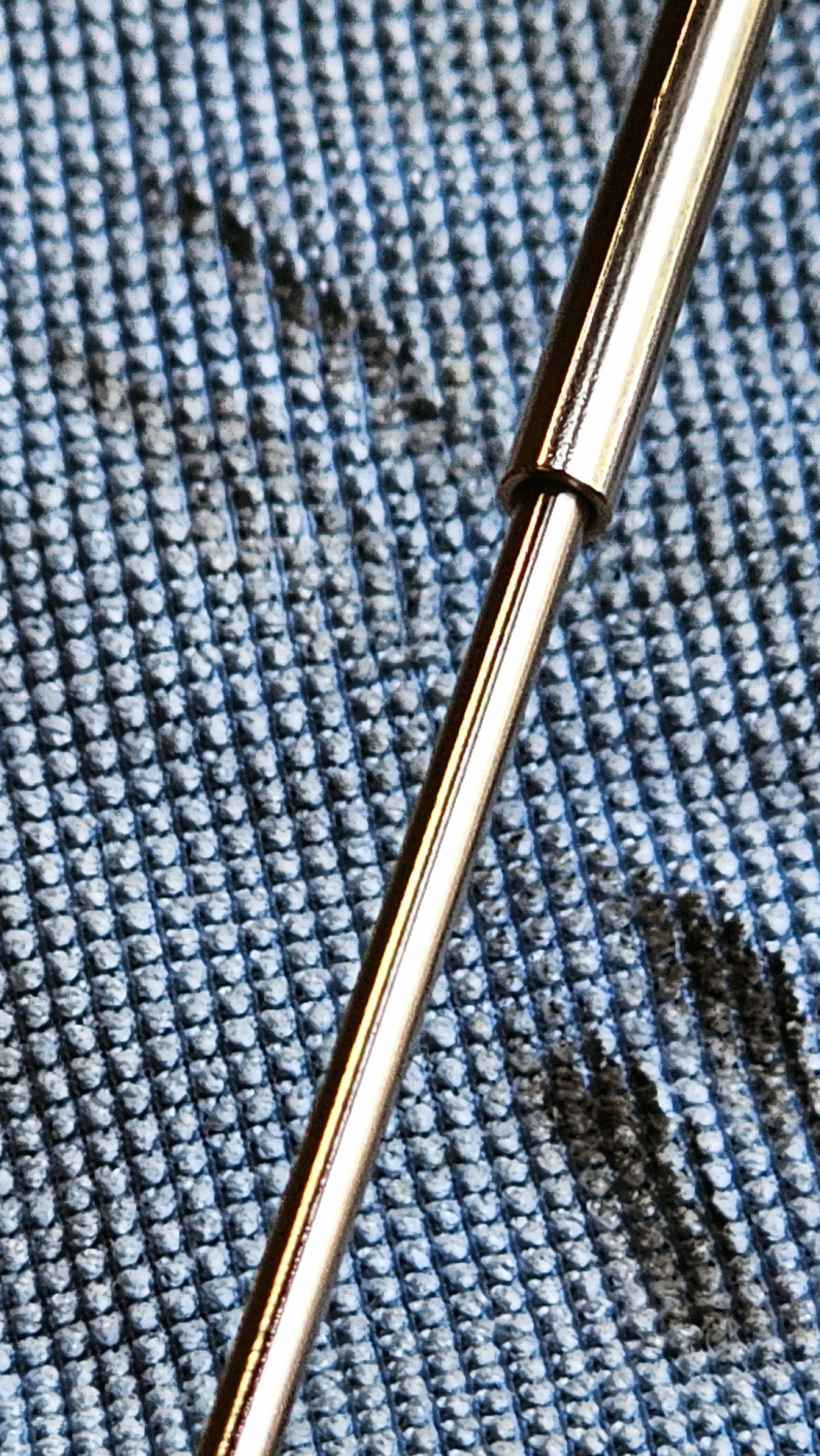

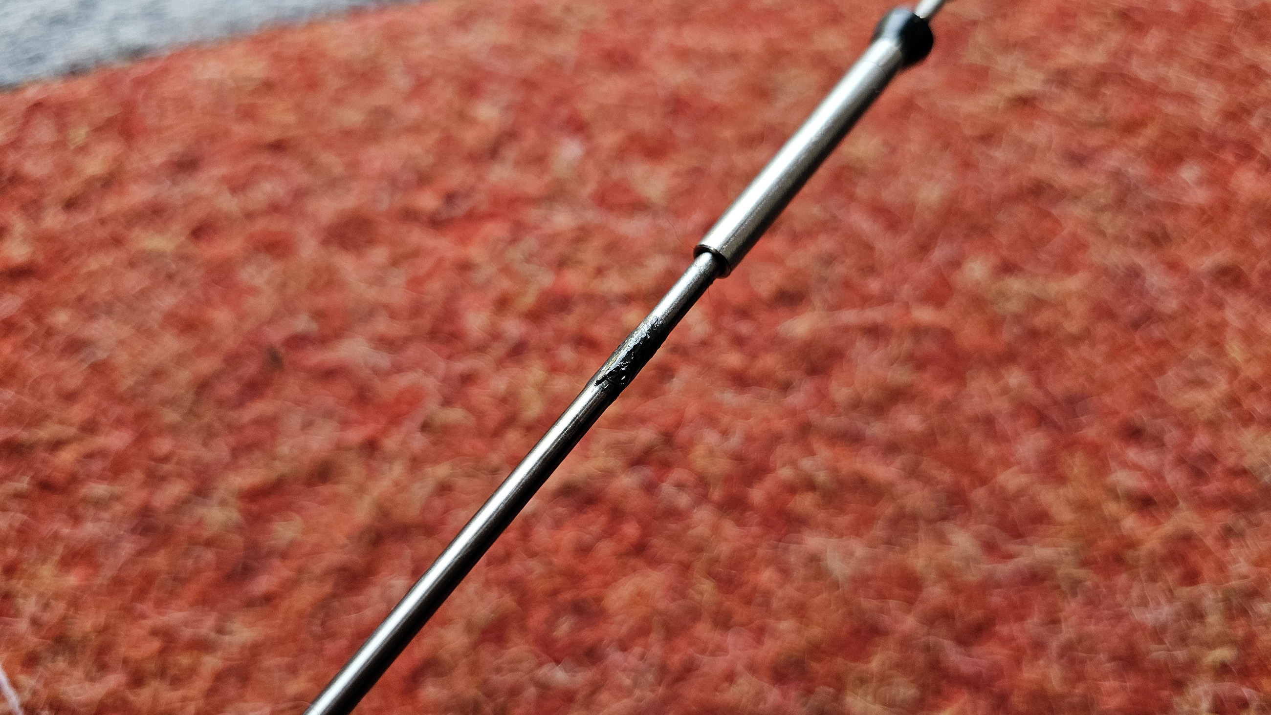

Well, I just spent the morning taking the M4 apart and here's what I found. Again, I've owned multiple rifles of every generation of the Impact so I'm fairly familiar with them but have never had any of them take nearly 10 shots to warm up until this M4. So this was the first time that I've ever had to tear it down to this level and I have to say that it wasn't that bad . . . even borderline enjoyable learning new parts of the assembly. It took a little longer than it probably should have but it was a combination of it being my first time doing it and my OCD that slowed things down. It should be a lot faster going forward. The hardest part of the whole process was my hands cramping up while polishing the rod - getting old is no fun.
Anyhow, this rifle has probably only had a few hundred pellets through it and here's what the valve rod looked like:

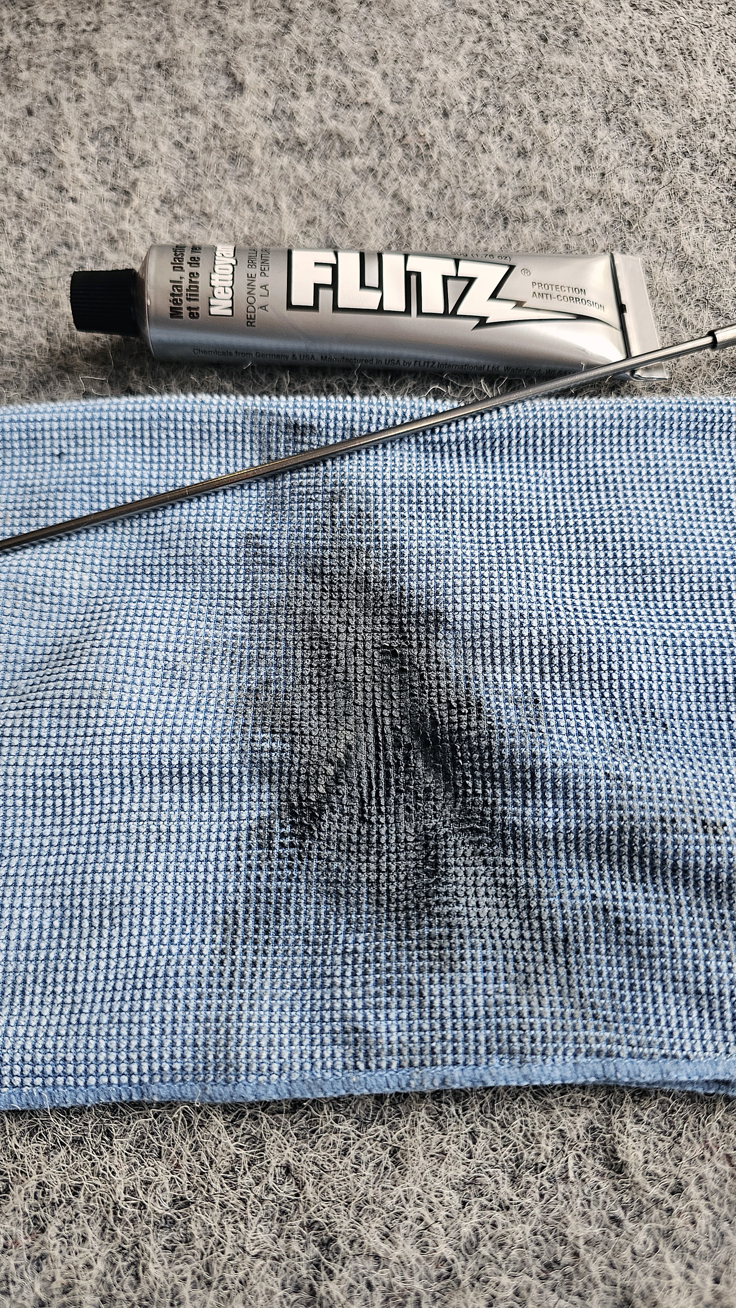

After cleaning it up and polishing it for about 10 minutes, this is what came out (all the black gunk on this blue towel is what came off the rod AFTER I'd already wipe off the goop from above on another towel):

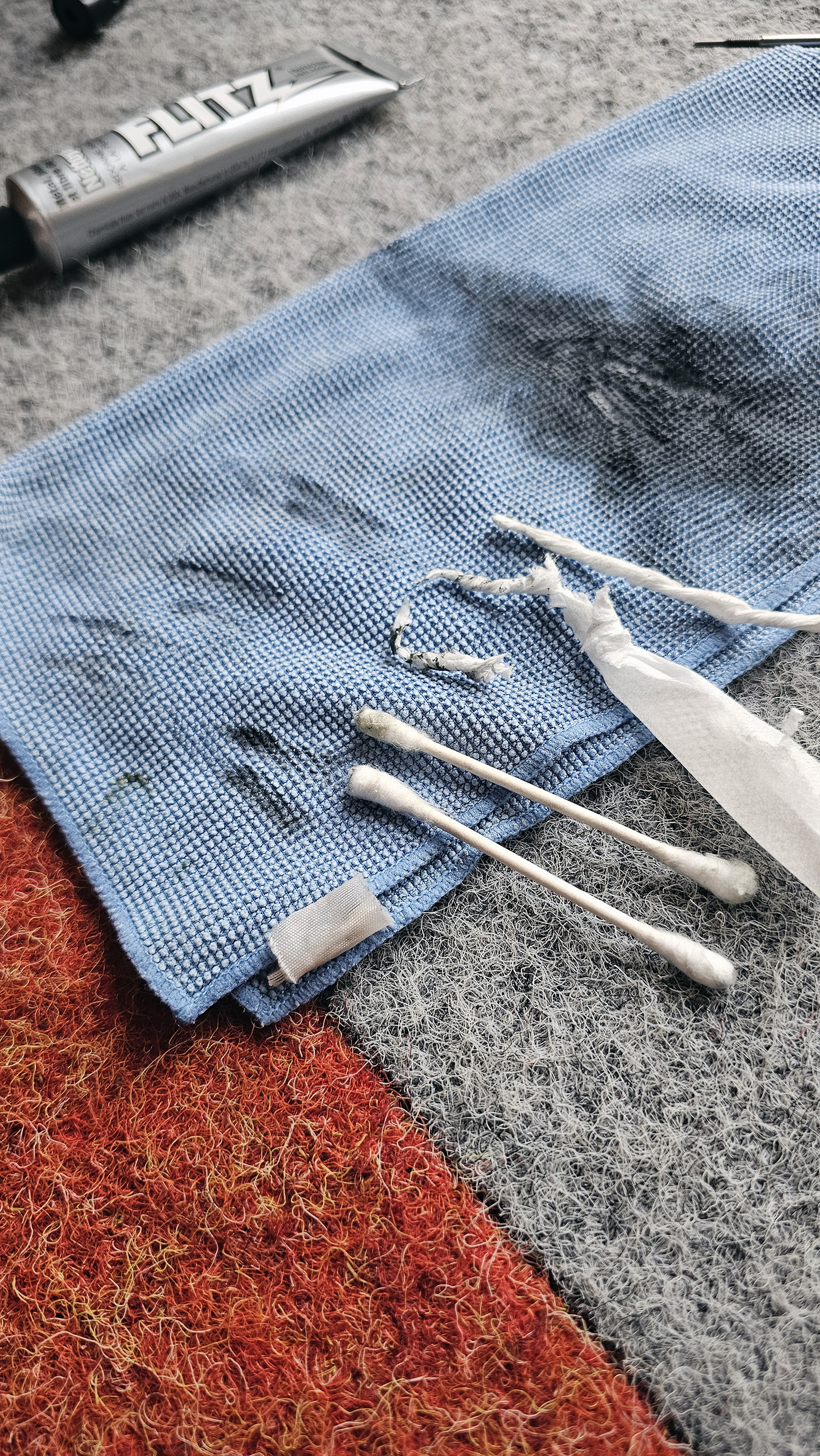

This was the gunk that came out of the valve body around the orings:
And this is the valve rod cleaned and polished prior to reassembly (the little squigglies you see is from the thin layer of silicone oil applied to the rod):
Everything's put back together relatively easily - I didn't break anything and no leaks. Aired it back up and it's shooting at ~900fps right now. Early results look promising as the very first shot after airing up the rifle was at 853fps and the second was 885fps - then the rest hoovered around 900fps. Will let it sit overnight and see what those first few shots look like on the chrony. Be back tomorrow...
Been there, done that :) polishing the valve rod to a mirror finish will definitely help. But it will not 100% prevent new gunk building up. The o ring the rod is riding on extrudes because it is not resting against a flat surface. The valve rod wears down that o ring and in particular the extruded part with every shot. A mirror polished rod will obviously result in less particles being ripped from the o ring, but not in none (at least in my experience). It may take 500 shots, 1000 or 5000, but it will come back. The higher the power of your tune the bigger the problem. I am guessing that folks who “don’t have” the issue either don’t have a chrono and shoot within 50 or have lower power tunes in terms of reg pressure. Or maybe there is a luck of the draw component like o ring batches or something ridiculous like that I don’t understand.
Just remember, your super polished valve rod to a mirror finish is not the best approach. Think of it like this. Your oring is a squeegee. If you squeegee glass, what happens? If you squeegee something porous what happens. With my last five Impacts with this issue, after installing either peek discs or plenum parts, I had to find the right amount of polishing and the right lube to help elevate this issue.
I also agree with what is stated above about what makes this issue worse. I have one Impact that started life at my house as a pellet gun. For almost a year it had the issue but it was barely noticeable. When I started testing slug barrels I was building on that gun, I of course turned it up. Then the issue became more pronounced. And that’s with a peek disc installed the day I unboxed the gun. So if I noticed it becoming more of an issue with parts that prevent extrusion, the guys with stock guns aren’t making stuff up about having to warm up their old FX farm tractor.

I polished my valve rod but did not cure anything sadly. Only when I had the correct part from Mubhaur.
I could hear when shooting the impact was slower on velocity.
I had a spare valve rod from an older version impact, and I put different orings on it for 24 hours. Afther 24 hours you could feel that the orings were clamping on the valve rod.

Here's the update -
-After letting the rifle sit for 4+ hours yesterday, first five shots were: 872, 885, 884, 885, 885 (normal is 895'ish)
-After sitting overnight, first five shots were: 854, 870, 869, 880, 883
I wouldn't say that the cleaning/polishing process completely resolved the situation but definitely brought it back to what I've known as "normal" for an Impact, which is a slower first/second shot. This is essentially how most/all of my Impacts throughout the years have behaved. It's not ideal but 99.99% of my shooting is inside of 40yds so this isn't a huge consequence for me.
However, this is the first Impact that I've had to put in extra effort just to get it to act "normal" (which, again, "normal" isn't exactly ideal) so that's disappointing given that it is the latest/greatest model. Also curious to see if/when the issue will rise up again and when I'll have to clean everything up again.

I have send a message to Airbuks (he works now for FX, doing the YouTube videos for FX), showed the part @mubhaur made and explained him what it does. Also explained what the current flaw is of the FX part.
He responded, letting me know that he has forwarded the information to FX, and they are reviewing it.
