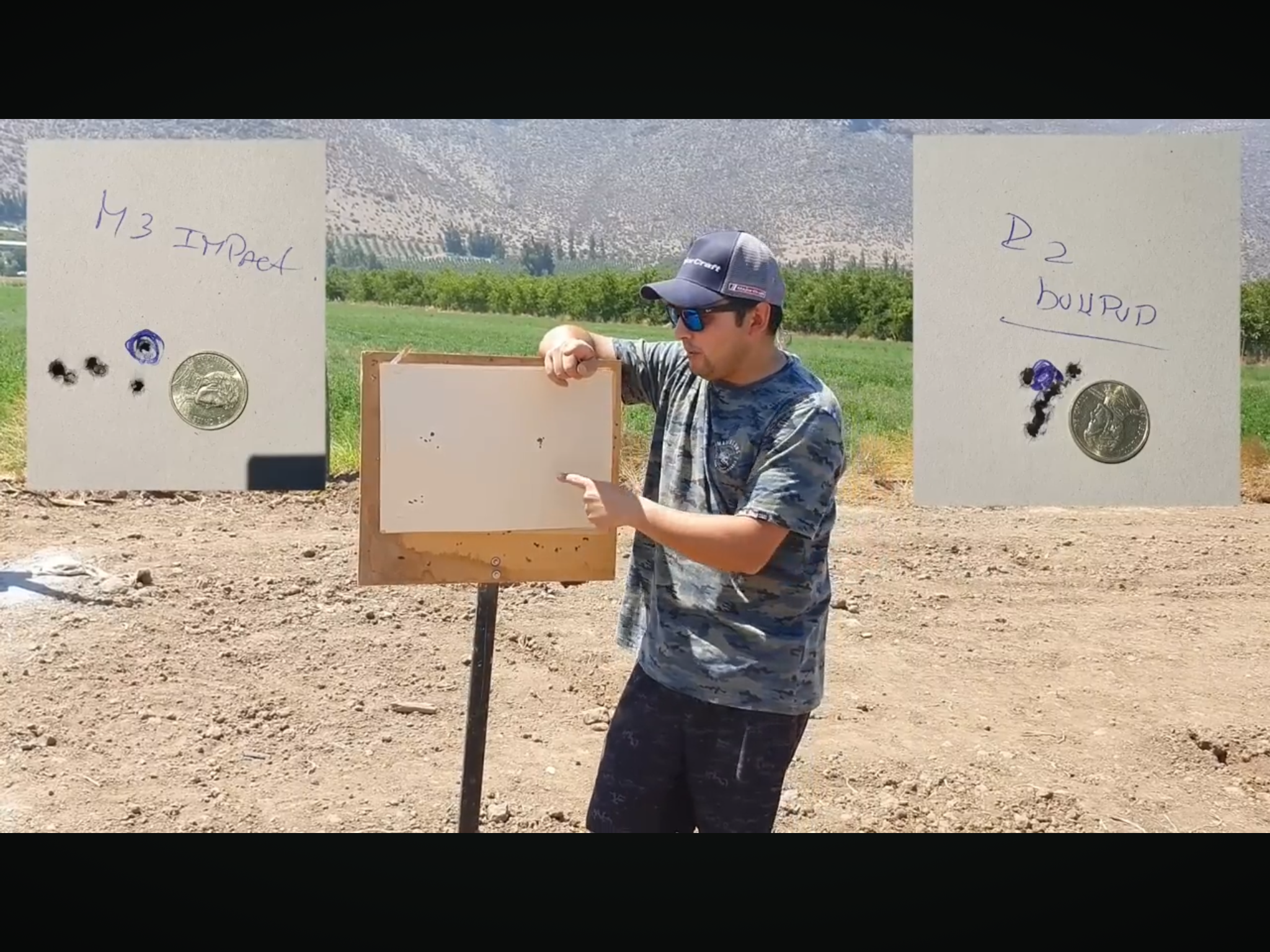

Air Venturi FX Impact M3 vs low budget Air Venturi Bullpup both in .22 cal at 50 meters

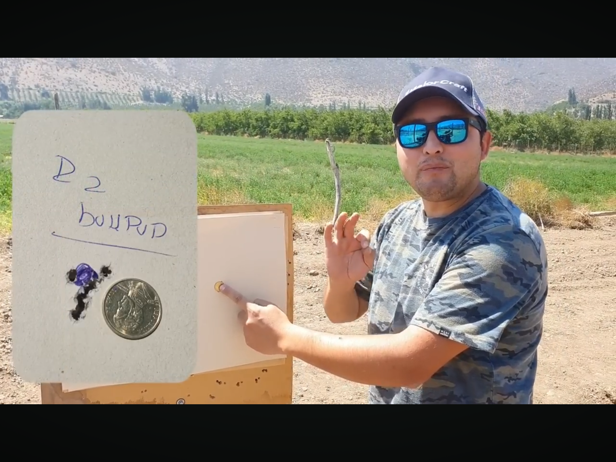

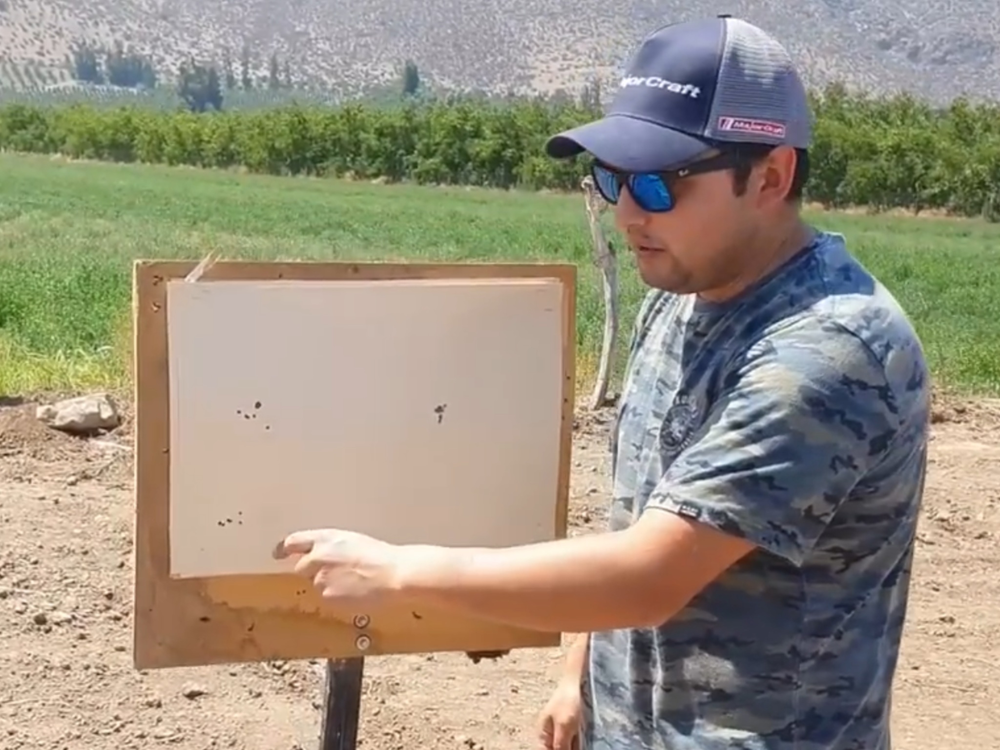

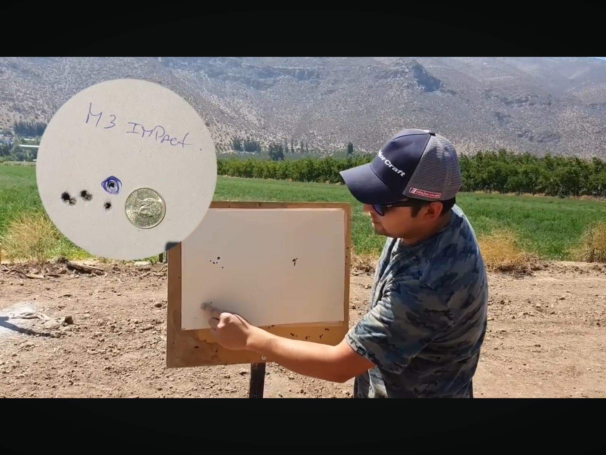

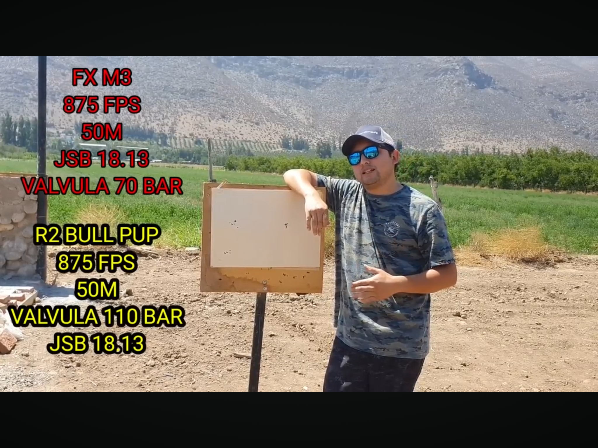

This test was done by a very popular spanish speaking airgun reviewer who owns a airgun store in Chile and also have a youtube channel called Caza 342 that use it to promote all the airguns he sells in his business. For this comparison test he used the same JSB 18 grains pellets in both airguns with the same 875 fps tune, to achieve this number he set the reg of the Avenger to 110 bar and the reg of the FX impact to 70 bar, in this country they call the Avenger bullpup the R-2. He used a range finder to measure the distance before, he start the test. As everyone can see, there is not much difference in accuracy between the two (in my opinion the group of the avenger was better) despite the huge difference in price and the FX been considered one the most accurate airguns of the market.
This post by no mean was done to start a war between the high end airguns vs the budget ones, its only to realized that it is not worth to have to invest so much money on a airgun to shoot at this relatively short range. Durring the test he even need to do two different 5 shots groups with the FX and hide one with his hand, because one of them was awful to make the comparison test more equitable between the two airguns. The two groups of the left side were done with the FX Impact and the single one in the right with the avenger bullpup, he was able to completely cover the Avenger group with a dime.

Completely agree, as easy as Fx guns are to tune most people don’t know how and ended up with so so or poor results. Just like PBers developing loads for each ammo, each pellet/alug needs fine tuning for best accuracy. The reviewer clearly couldn’t tune the impact and/or not a terribly good shot.
If you look at the impact group it’s all horizontal divination with little vertical divination so it’s all wind. From these groups it’s clear the impact is heads and shoulders above the D2 in accuracy at just 50 yards.

I will sort of agree, horizontal deviation can also be caused by heart beats, failure to master the timing on them is crucial.

This is somewhat of a pointless comparison. You can't just tune two very different rifles identically and then assume that the results are significant. It might be that the FX stacks monsters in a single hole at 940 fps while the Avenger shoots patterns with the same combo or vice versa. All it would prove is that one gun does better with a certain combination. You've got to come up with the individual pellet and the tune that each gun likes and then shoot them side by side when they're both at their best.
