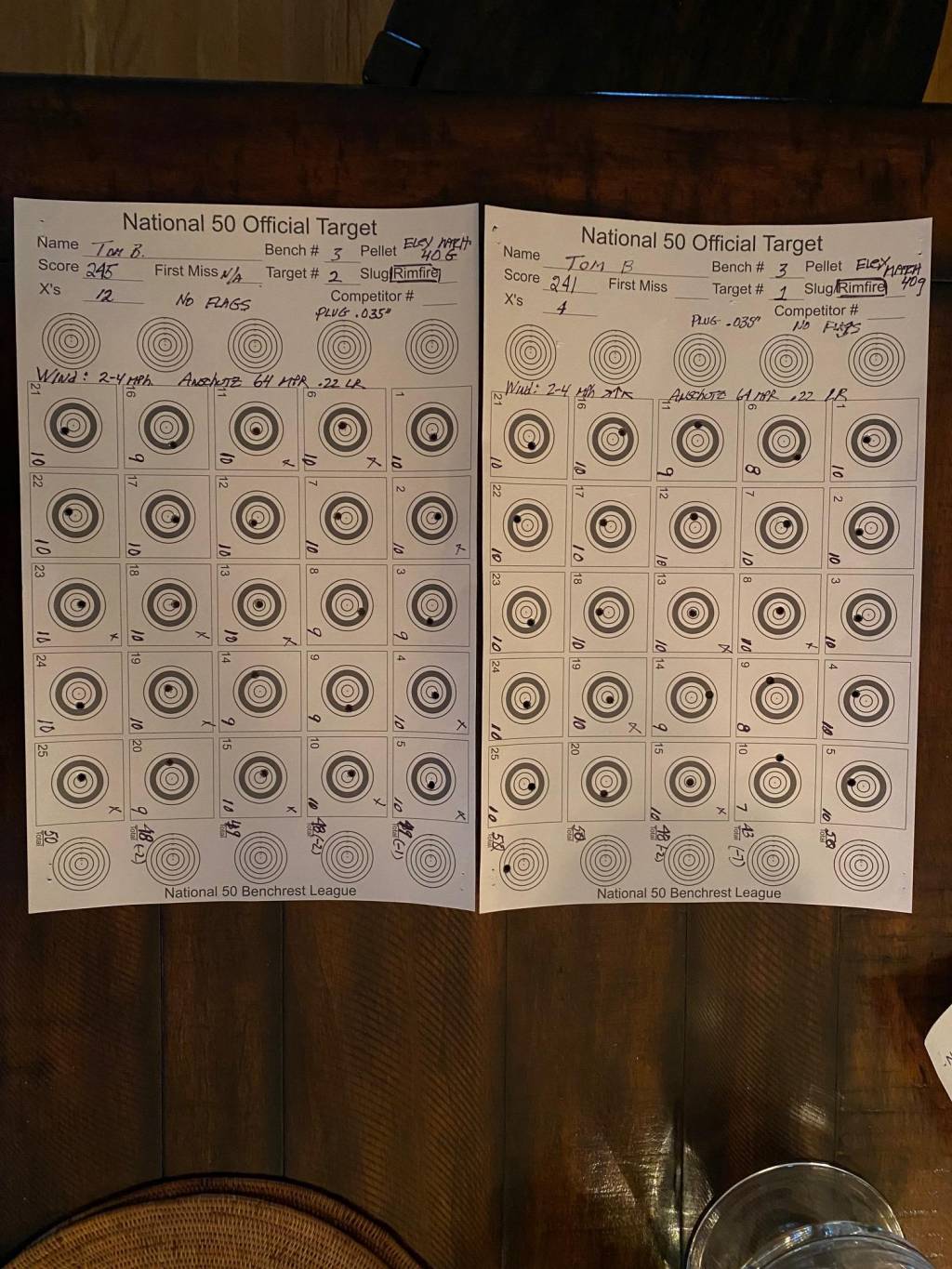

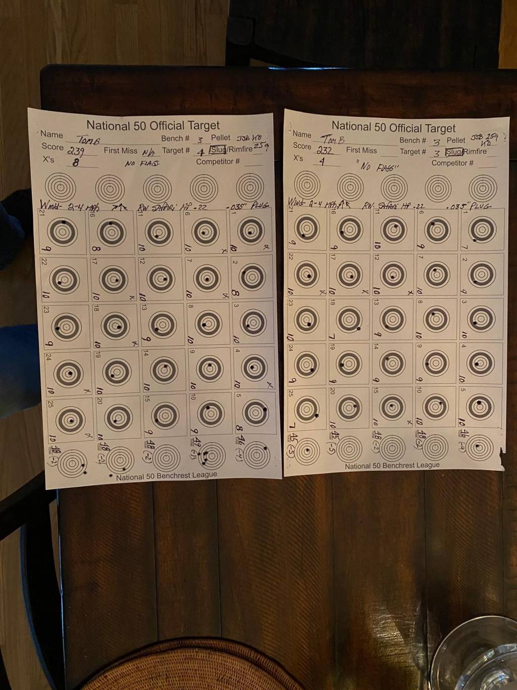

Went to the range today. At the time I went, the Dow was down 700 points and I wanted to blow off some steam. Came back home and found out it was down over 1100 points and came back to +99. Amazing! I was ready to jump off a building, and now I can rest for another day. Go IBM!
Range Outing below:
Temperature 40 degrees, wind 2-4 mph ( tail wind and left to right and visa versa ). I did not deploy flags, lazy!
Anschutz 64 MPR .22 LR - shooting Eley Match ( black box ), which for this gun is good ammo. It also likes the Lapua Center-X, but today it was Eley. Shot a 241 and 245 with .035" plug. Not bad, could be better. Still working on technique/wind reading.
Next up,.... Red Wolf Safari shooting the JSB KO's 25g ( my last tin ) - I did have a tough time with some wind calls, but did my best. I would blow a bull with a 7 or 8, then try and figure out wind. Not easy for this boy.
On this day, the RF did well. I think the 40G bullet bucked the wind better than the 25g slug. I also think I can do better with the Safari, but not today. Just wanted to 'true up' my own experience with a pretty good RF and a good air gun. Your mileage will vary.

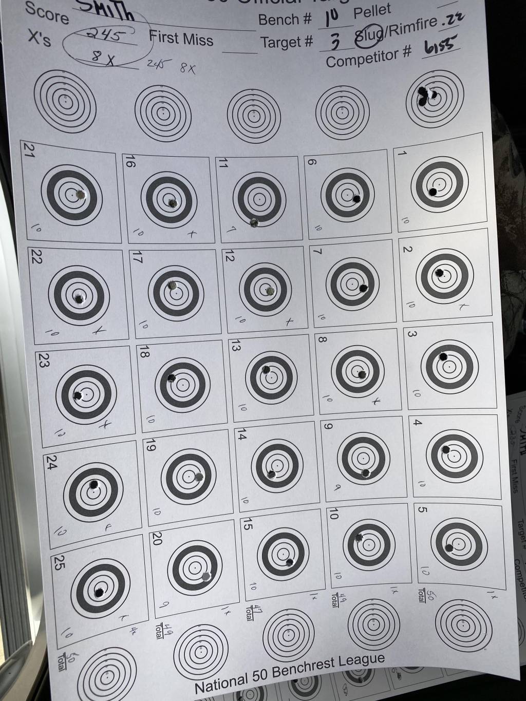

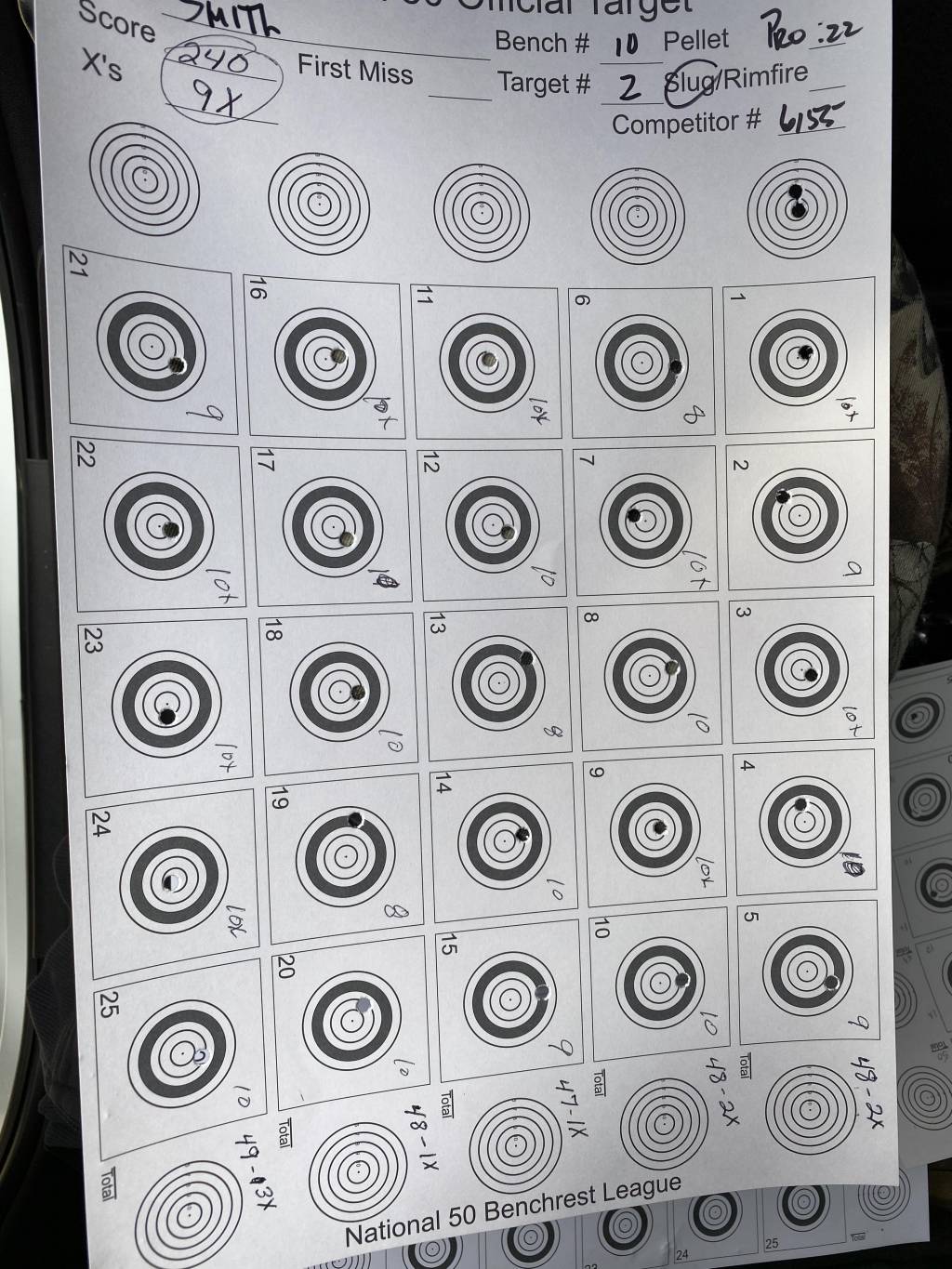

here are a couple N50 targets I shot at Rio Salado in their crazy wind conditions in the N50 Pro Class. In pro class you are scored with a.224 plug and not a 35 caliber one. This was shot with a Thomas Benchrest Slug gun and slugs were made by me. The rifle will shoot with a.22 LR Benchrest rifle. The nut behind the trigger is the big factor. It is a big eye opener no to be scored with a.35 plug. I don’t practice with it and shoot it maybe 2 times a month. It is a tack driver but I also have a Vudoo tactical rifle. I have to give the edge to the Vudoo but the more I shoot the Thomas the better I am getting with it. It is very capable to consistently shoot in the high 240’s if not 250’s. On the Extreme FT and NRL22 matches the .22LR in my humble opinion wins hands down. Just for anyone’s information my other card was a 239 12 x.
Let the barbs begin!
