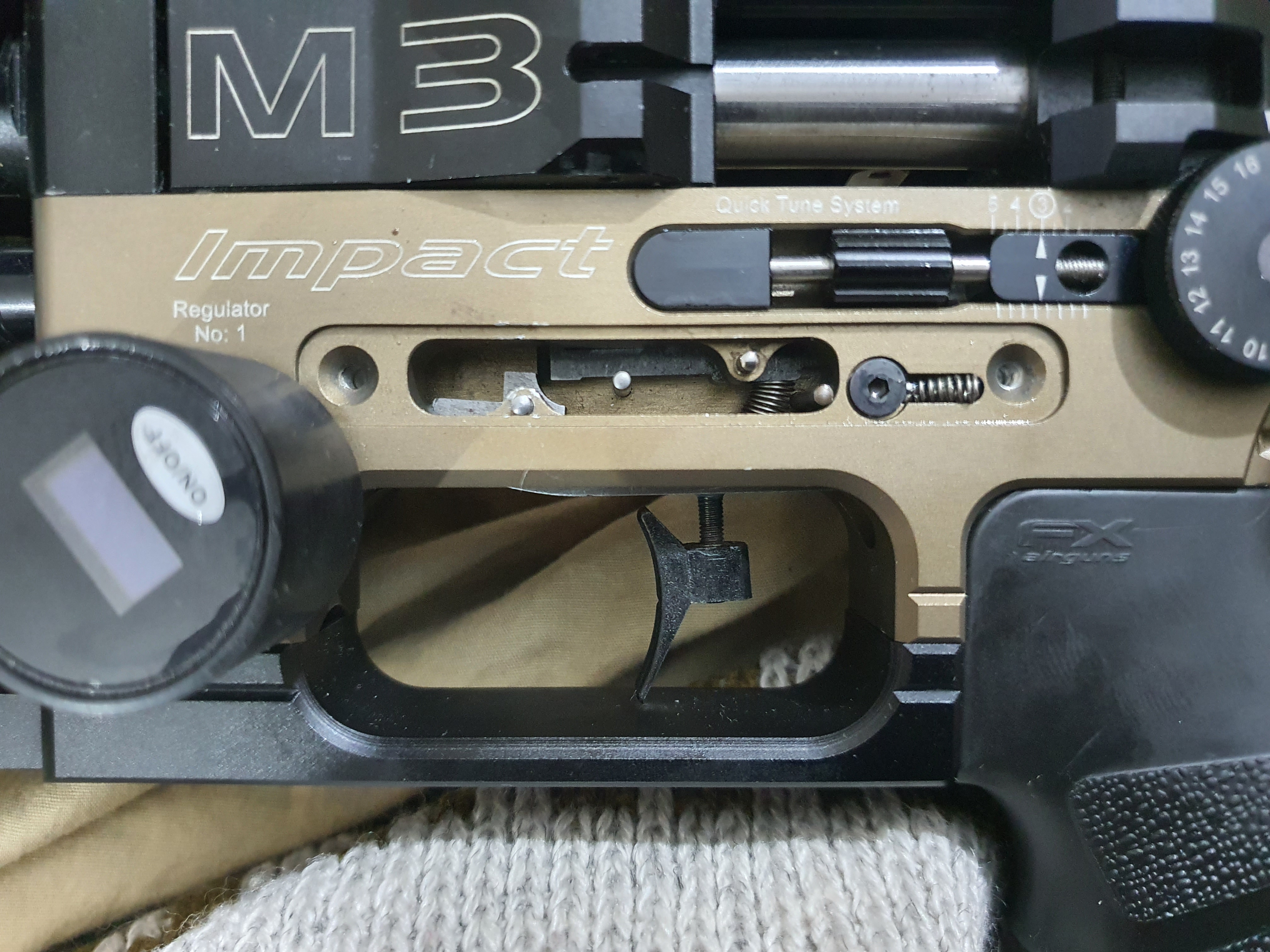

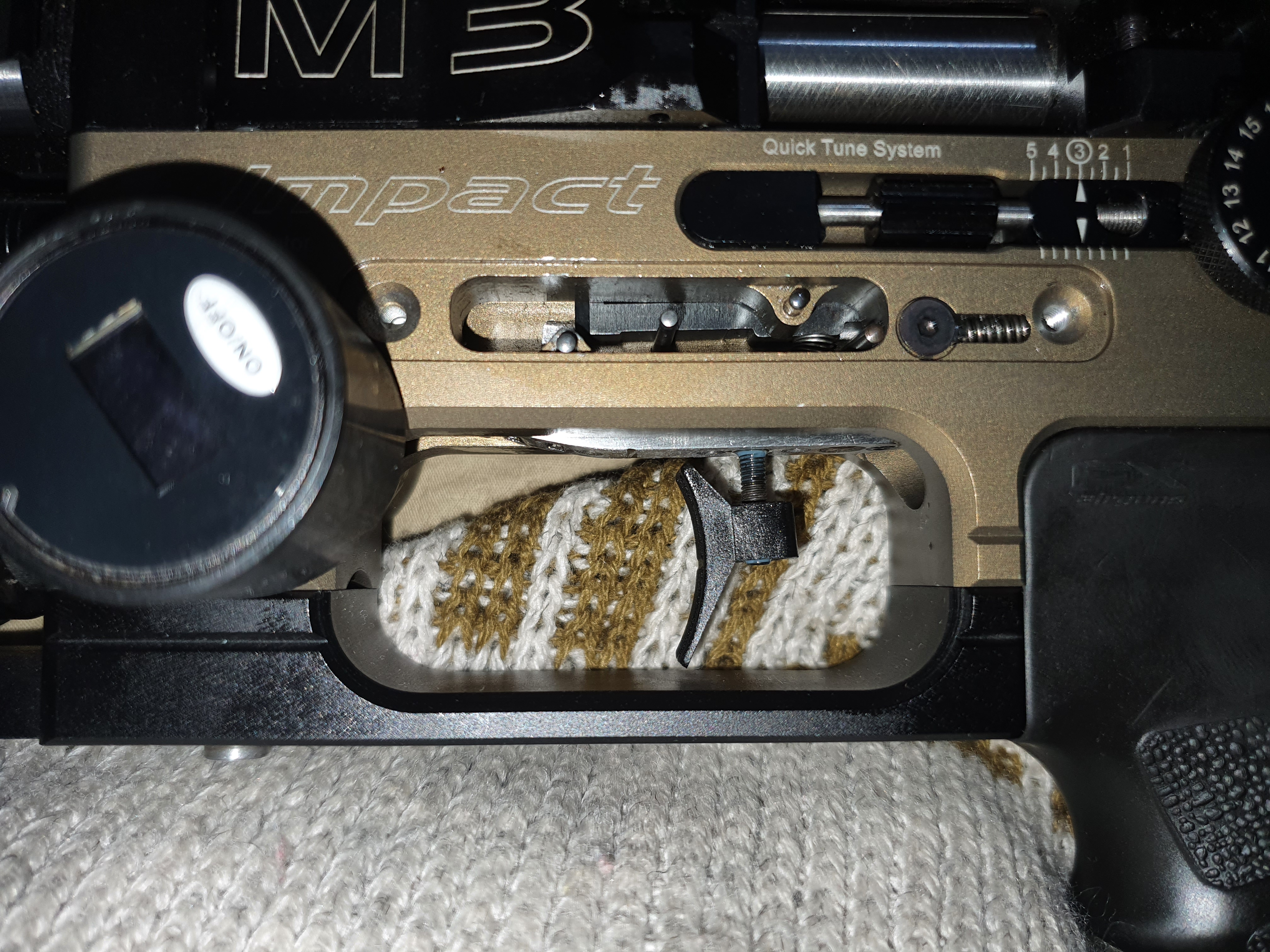

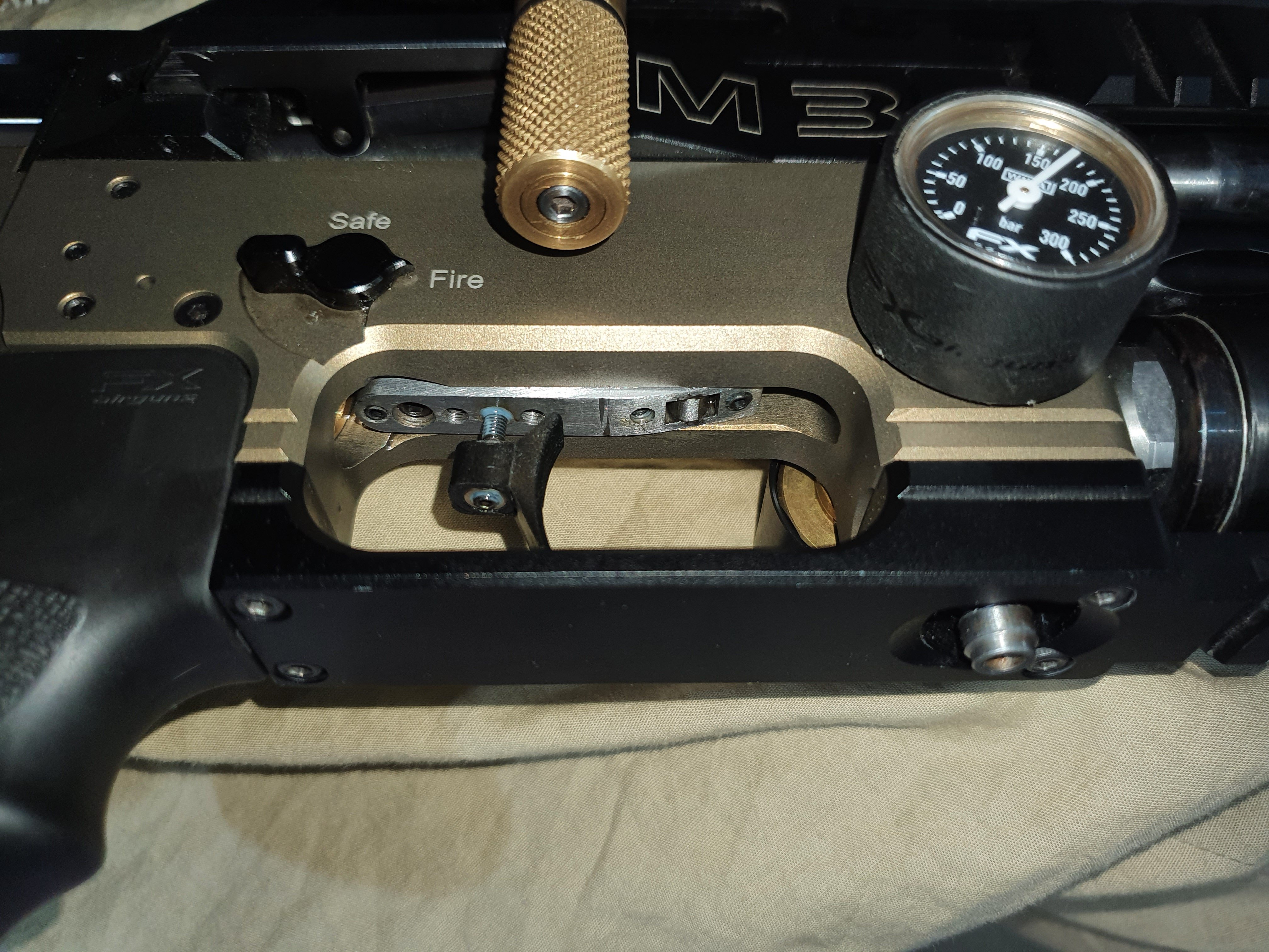

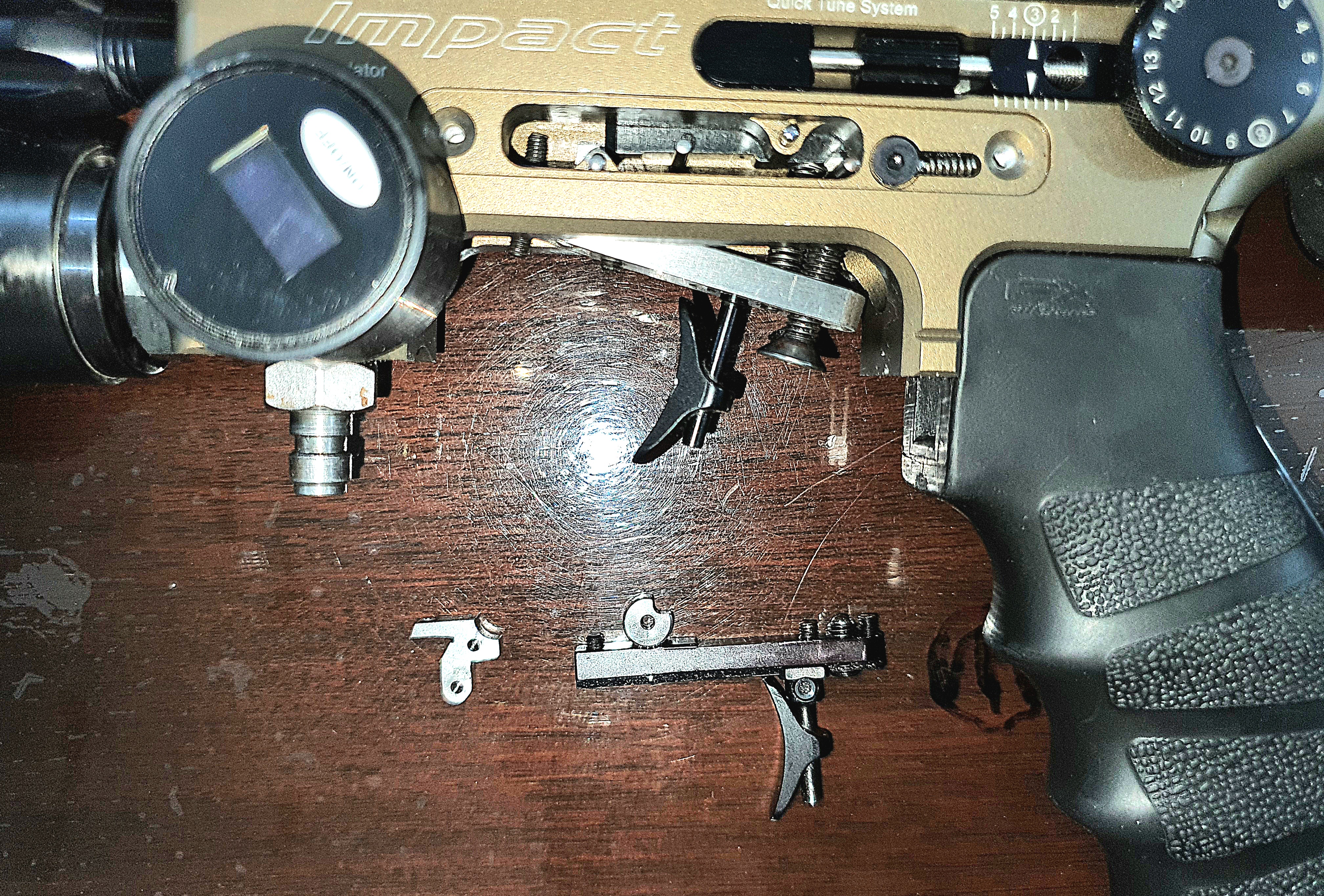

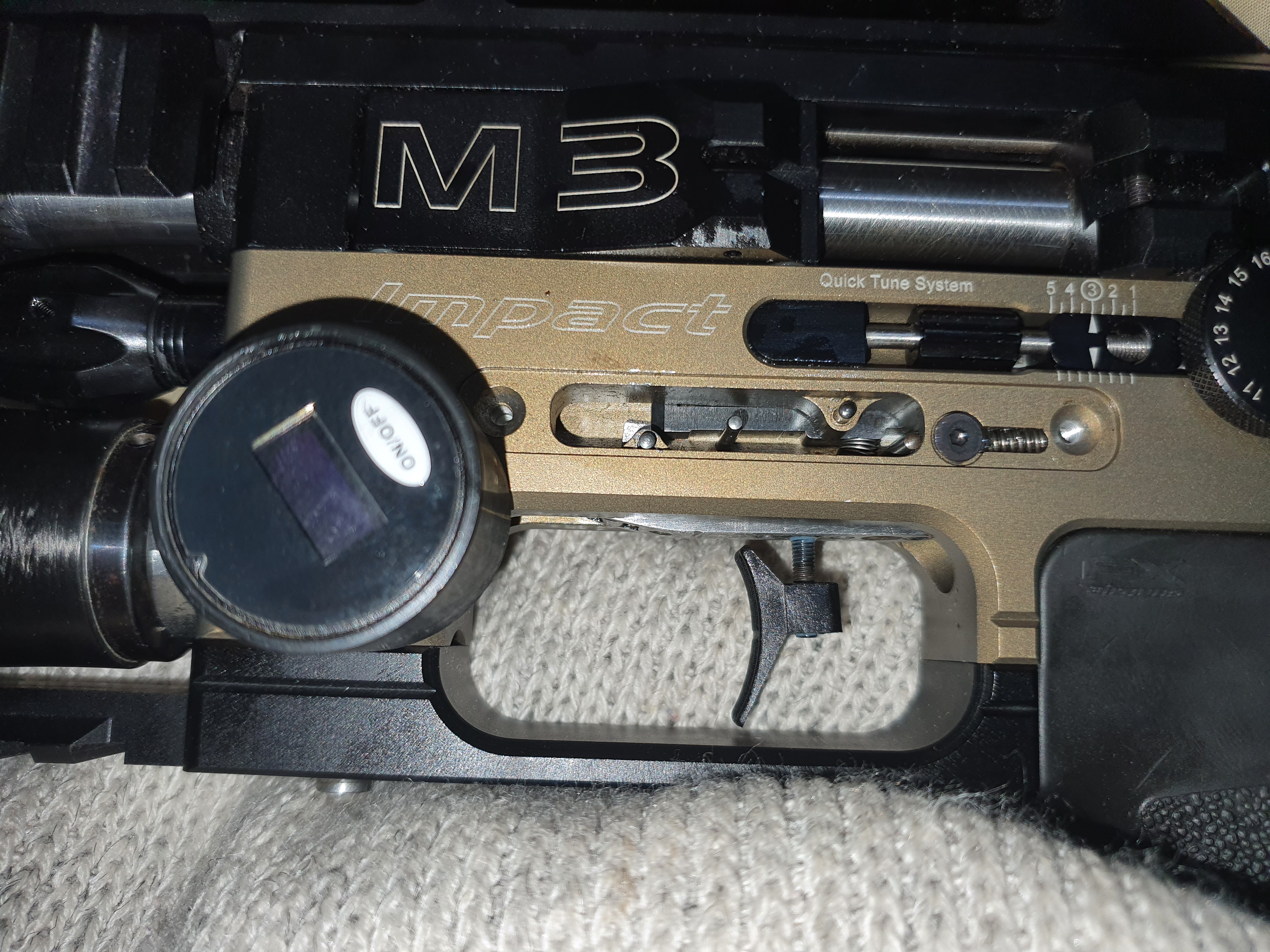

On this occasion I further refined my match grade improved trigger of M3.
In the following pic you can see that the rear part of the trigger bar was hanging. It didn't look nice and also it was preventing from installing the trigger guard plate.
After further refinements now everything is fine. I have also used BSA trigger blade just to have a couple of sets in hand.
To me it looks nice and fits well. Aesthetically looks much decent.
Pics are here below:
I hope you like it. It's not hanging now.

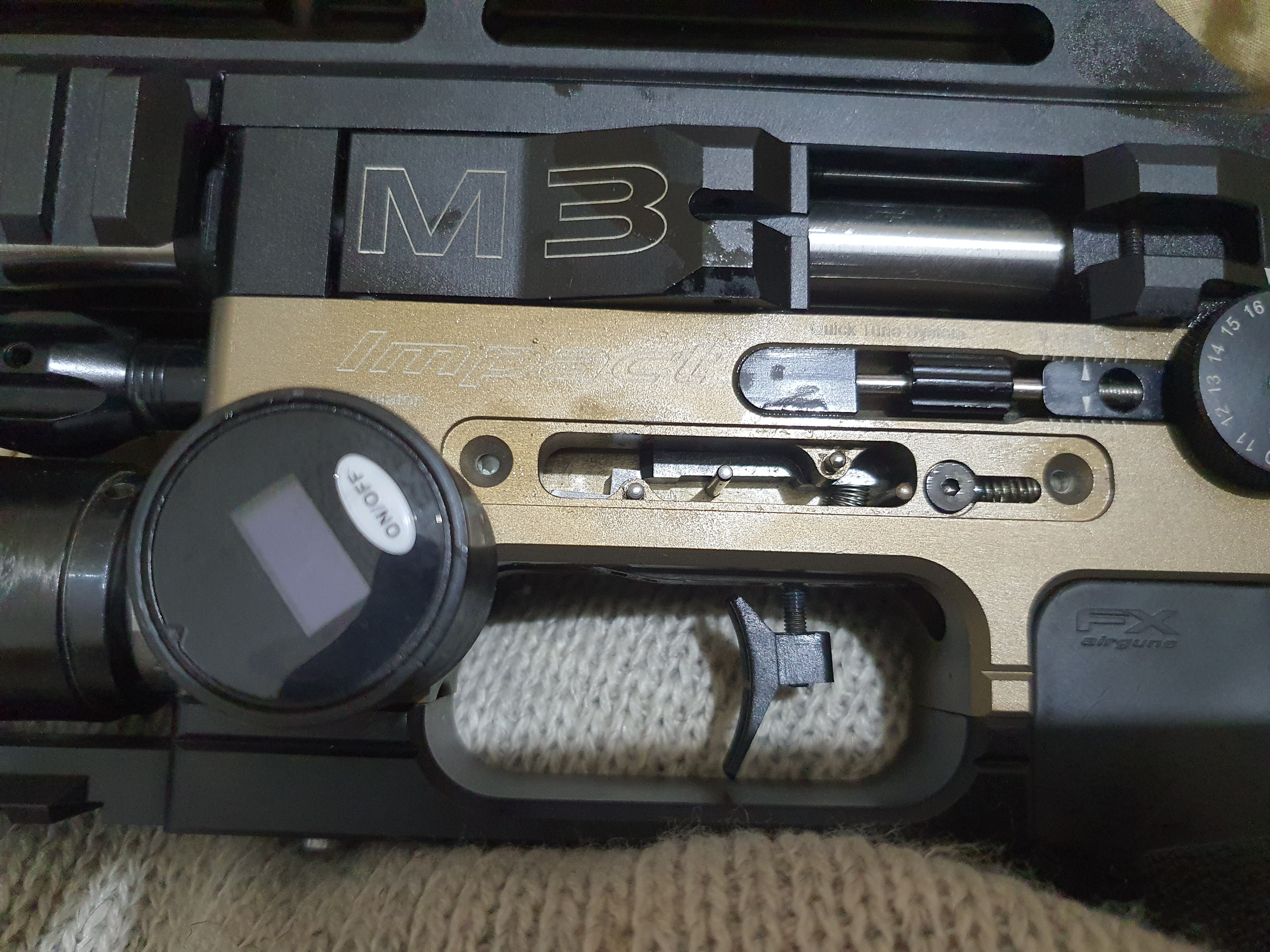

I tuned the trigger as per my liking for bench rest today.
Very light 1st stage that always comes back and resets itself if I don't break the 2nd stage.
2nd stage weight I have kept at around 7 oz.
The only drawback is that when I apply Safety and pull the trigger it gets stuck a bit. But by cocking the gun all becomes fine always.
As I personally do not use safety option and always keep my guns on Fire option, there is no issue for me.
Further I see that some target guns like RAW TM1000 etc. don't have safety option.
Hence not an issue specially in bench rest.
To me the pros of this trigger are much more than cones.
